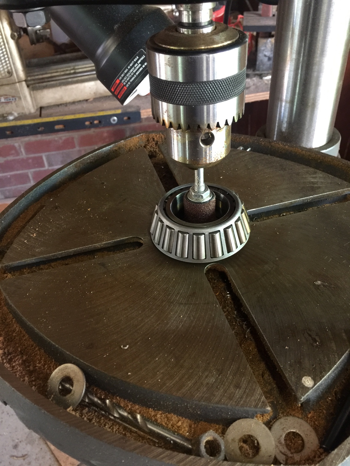

Making a set up bearing so that it's much easier to set the ring gear and pinion
Bearing slides on and off with ease.

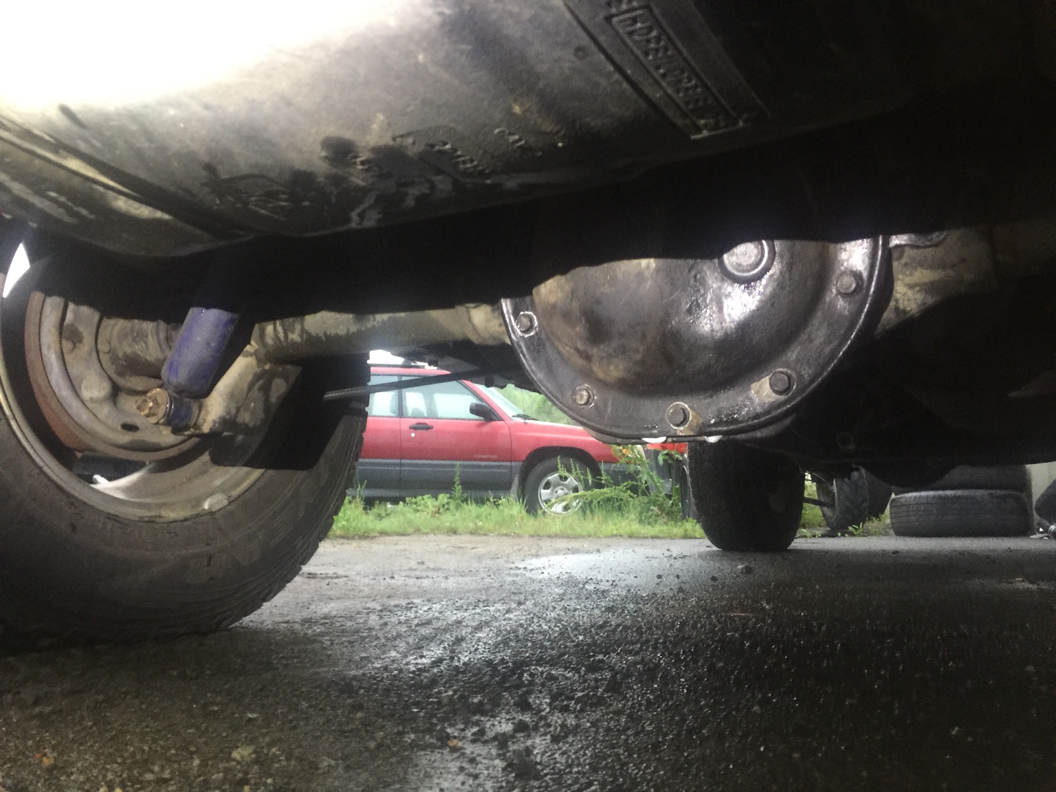

Inside of a Chrysler 8.25 rear axle :)
Getting it put back together.
Finally finished!

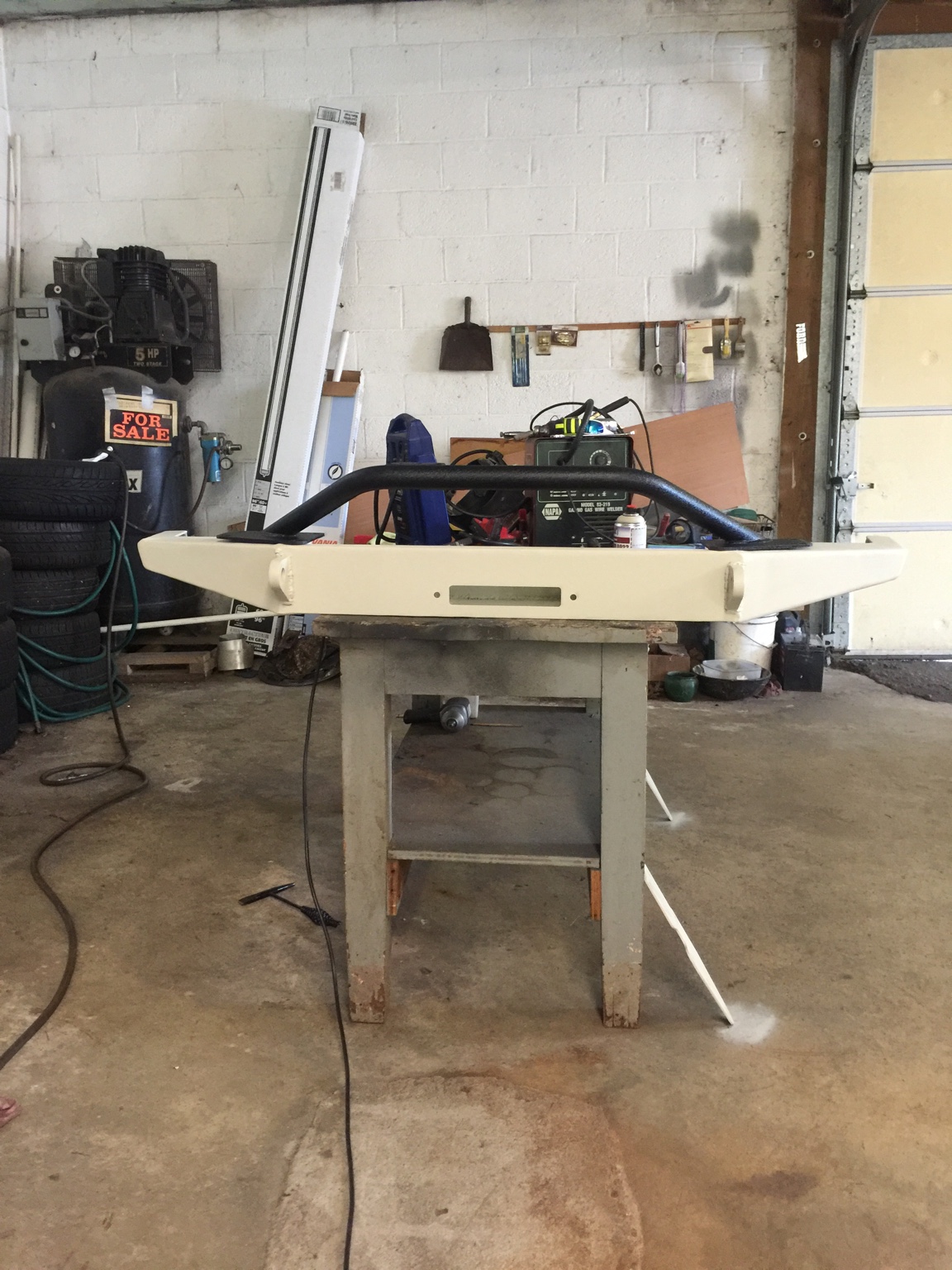

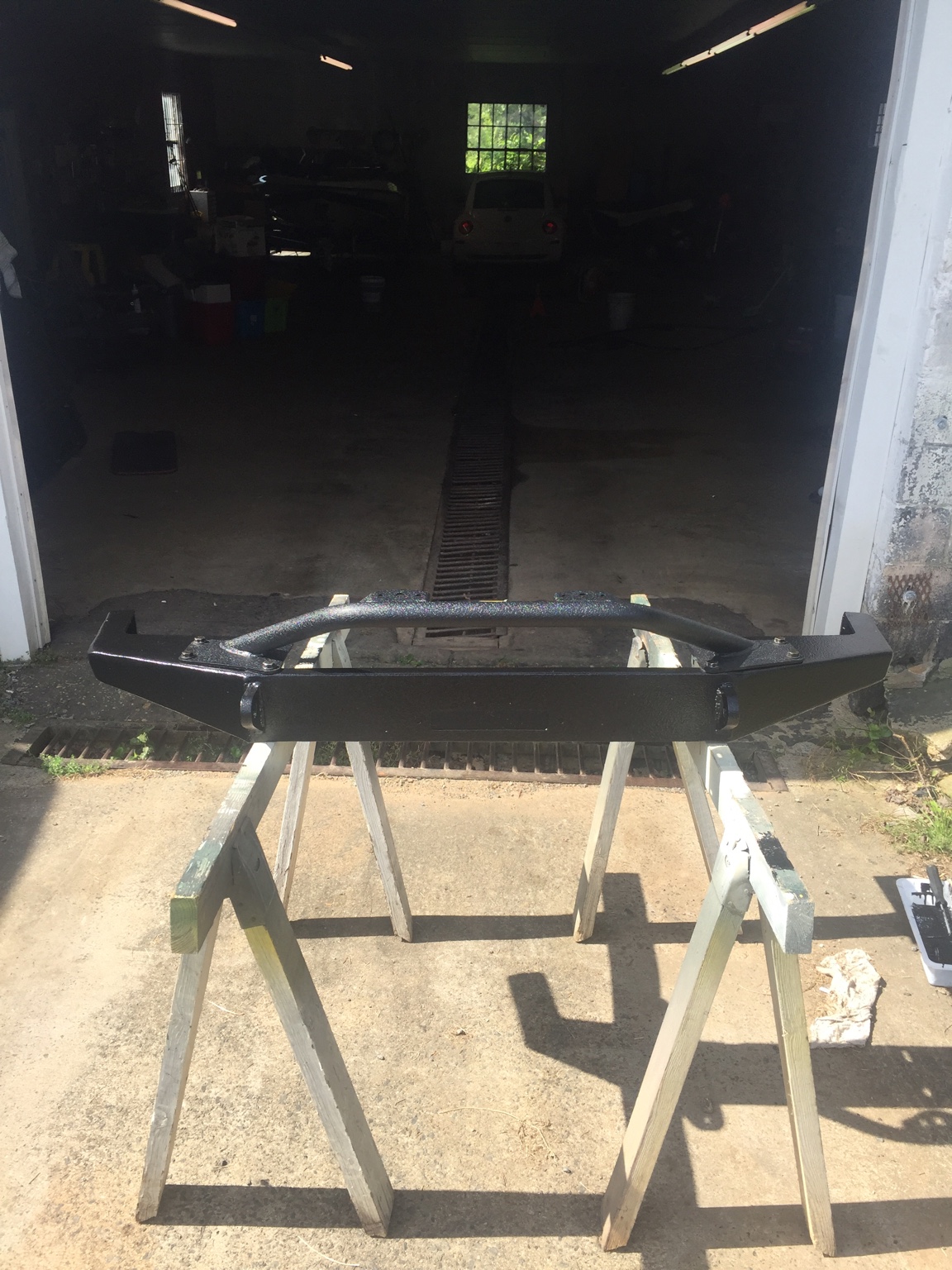

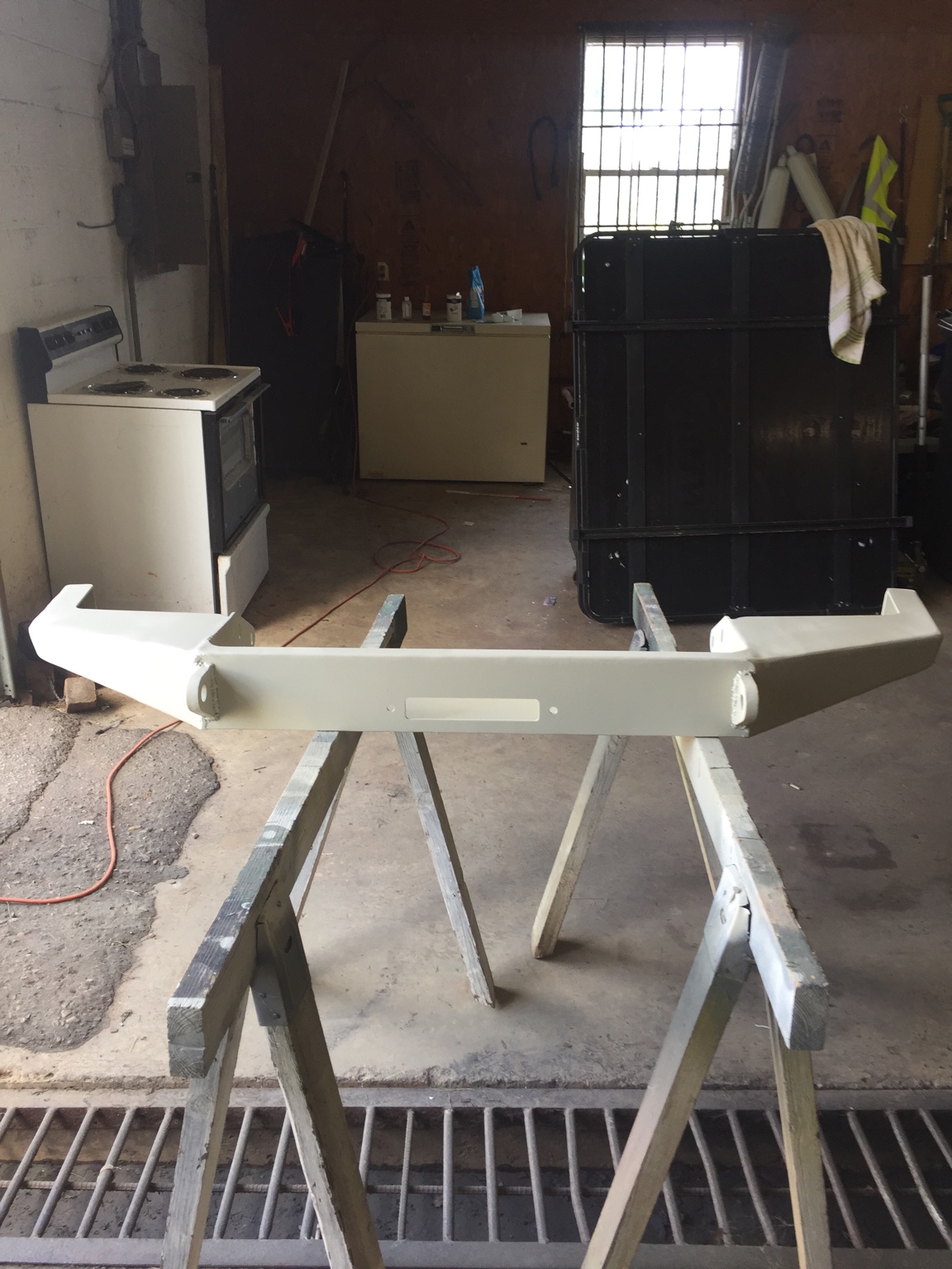

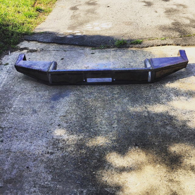

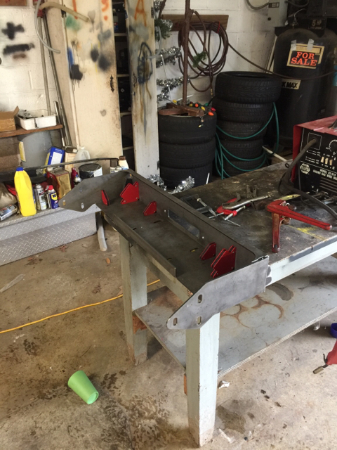

Front winch bumper is starting to shape up!

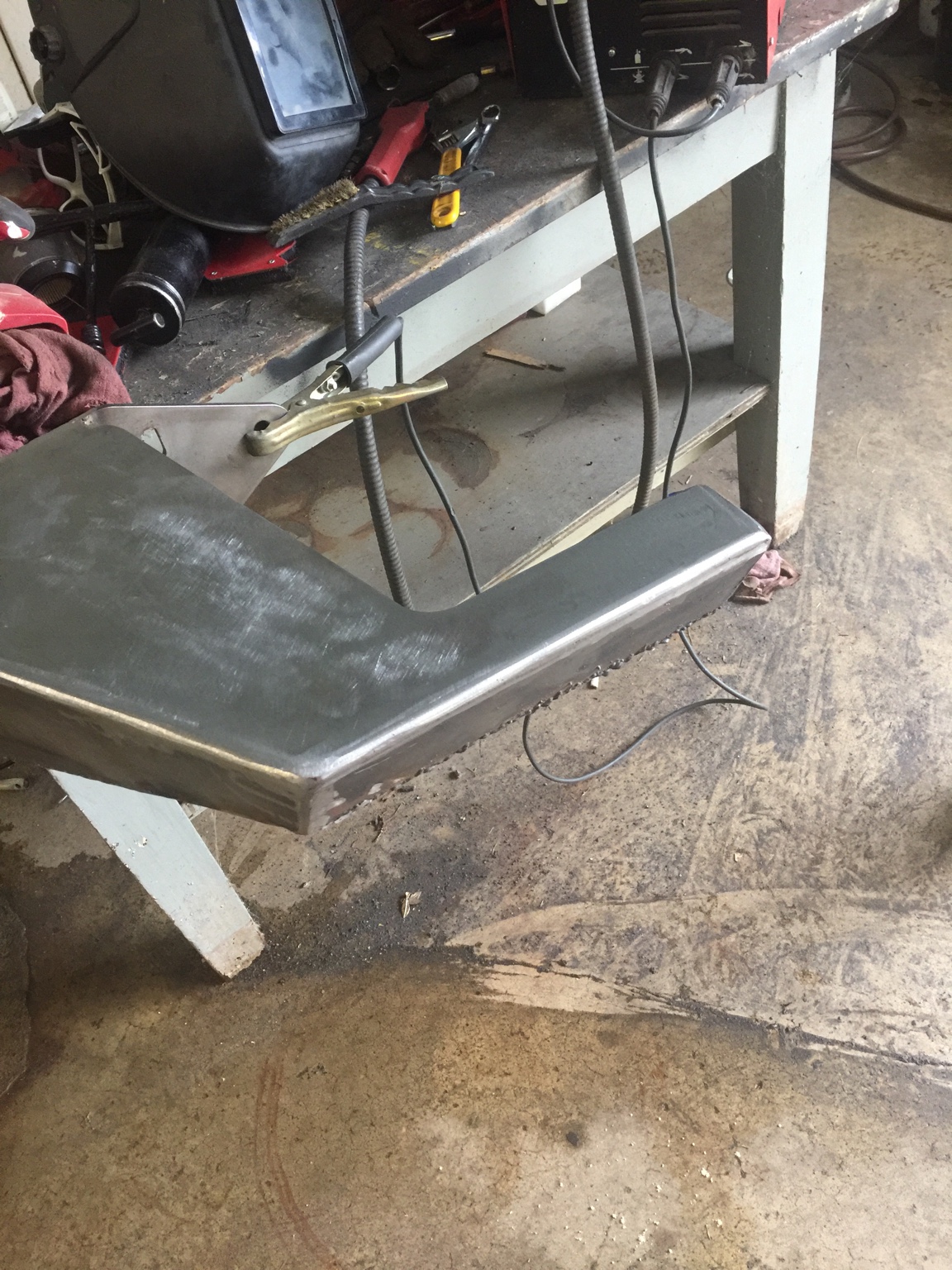

Just wondering if you welded/filled the back side of the top ground/radiused top seems. While working for TJM I learned they do this to all their welded bumper so they do not crack/split later. On big ground radius we would tack in a 1/4" to 1/2" squire fill also.
I know it is kinda late to bring it up now - Daryl
OverlandxjRon
1,556
Elkin North Carolina
4503
Hey Daryl
Actually that's exactly what I did,although I wasn't sure if that was the correct way or not.Me being a novice welder,and using fluxcore wire hopefully it will work out ok.This was my first decent size project welding.So I was kind of winging it the whole time haha.
