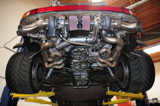

Ive built cages and turbo manifolds so I have access to both and DOM is something I like alot, heres a sample of what I do
Looks fun! Would love to borrow that for an afternoon!
I am also a welder, (pipefitter) by trade.
Lots of fab shops only stock DOM, for a couple of reasons, but mostly cause they don't want to risk accidentally use seamed tube on a cage.
For the average garage guy building bumpers and sliders, a few bucks can be saved by not using DOM.

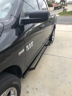

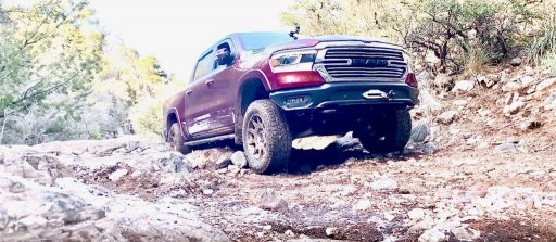

I have these on my 5th gen RAM 1500. Kind of pain to install. You would think it's simple bolt-on, but was more of a pain than my hidden winch mount. They already saved my truck from damage a few times.

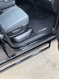

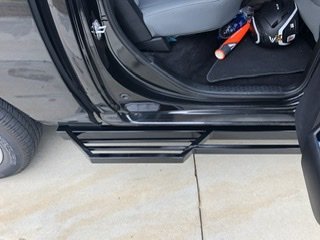

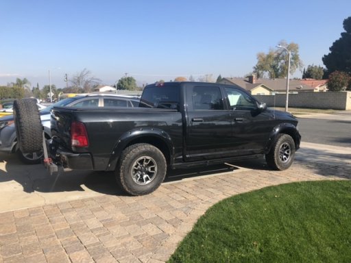

I went through the same process- white knuckles are the best for a true slider, the rest are just steps on thin wall that mount to the rockers, and in most cases hang down to far. I have a garage and can MIG so it’s doable. Don’t expect to be able to use a hi lift on them as they will be almost a foot off the frame rails. Round tube is cool but a decent tube bender will run you more then a MIG welder. I stuck with rectangular tube for ease of cut and paste. They go away from a side view- but work as steps also. This was when new before getting rid of the plastic chrome wheels.
been on a year with no issues other than I would powder coat instead of color matched them. I used legit paint and the two part clear and it’s chipped pretty good.

Man, those look REALLY good. I am impressed!

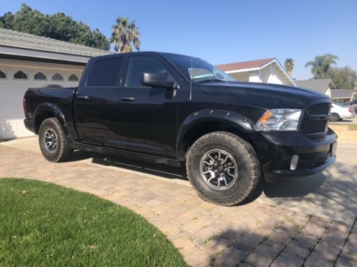

Save some patience up for the install, the gas tank side will be fun. I built my own but there’s no easy way to do it since they sandwich around the frame.
here’s the shade tree version after a year- I think they will take custom orders if you want to change the step part. They make a nice product that’s worth it if you can swing it.
