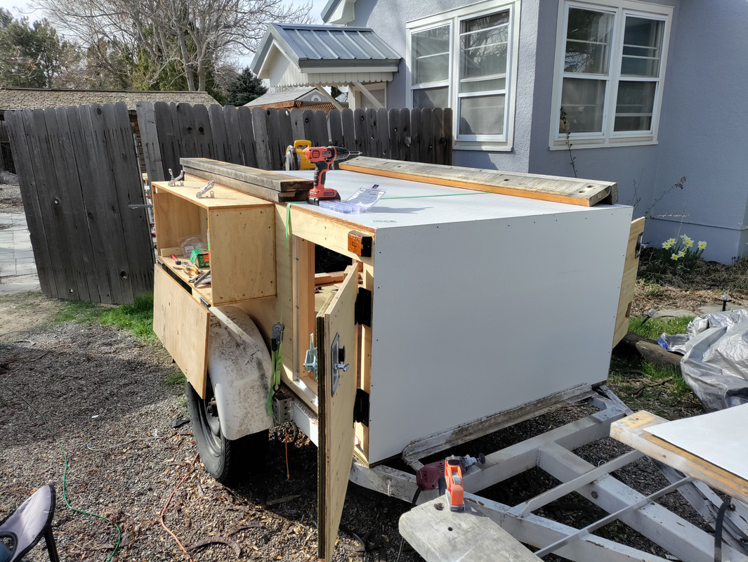

Maybe pulling it behind the Xterra, but I'm planning on using the frontier to pull it.Looks beefy and sturdy! Nice. Any worries of weight?
Influencer III
19540
I used a bathroom scale and a lever to weigh my teardrop. About 1400#.Maybe pulling it behind the Xterra, but I'm planning on using the frontier to pull it.
I may take it to a scale once it's done to see how much it ways. I'm guessing just shy of 2k.

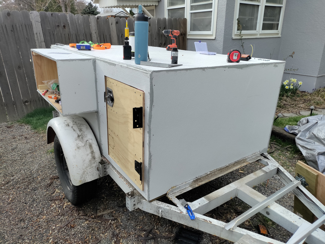

How are you planning to keep moisture from between the wood and the FRP? Why not just fiberglass and paint it directly?Thanks! It's its really starting to come together!

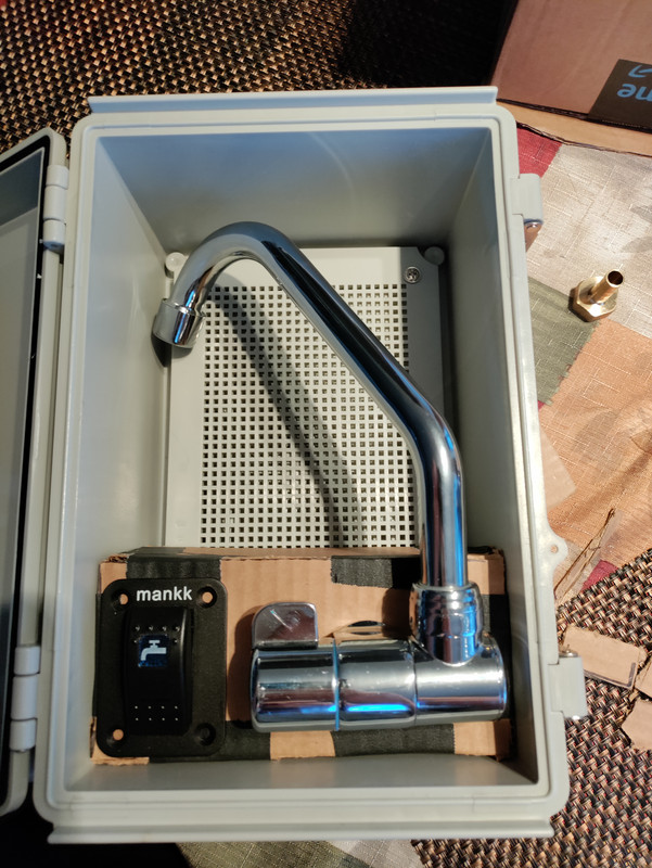

There's still a LONG way to go though. I'll need to wire up the lights, build my exterior switch box (more on that later), get my 10gal water tank in, and tubing run to the faucet, and build a fridge slide.
I'm also starting to think about what I'm going to paint it with. I'm leaning towards roll on bedliner. With the edges of the wood sealed, and the frp panels on top of the wood, I think the chances of bubbling or out gassing of the wood through the bedliner would be pretty minimal.
23711
So, the plan there is to seal all the way around the frp with sikaflex.How are you planning to keep moisture from between the wood and the FRP? Why not just fiberglass and paint it directly?

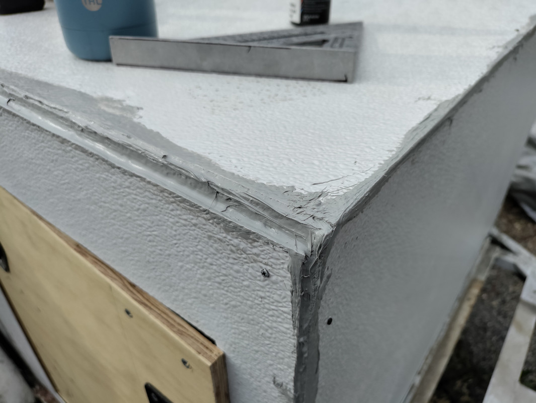

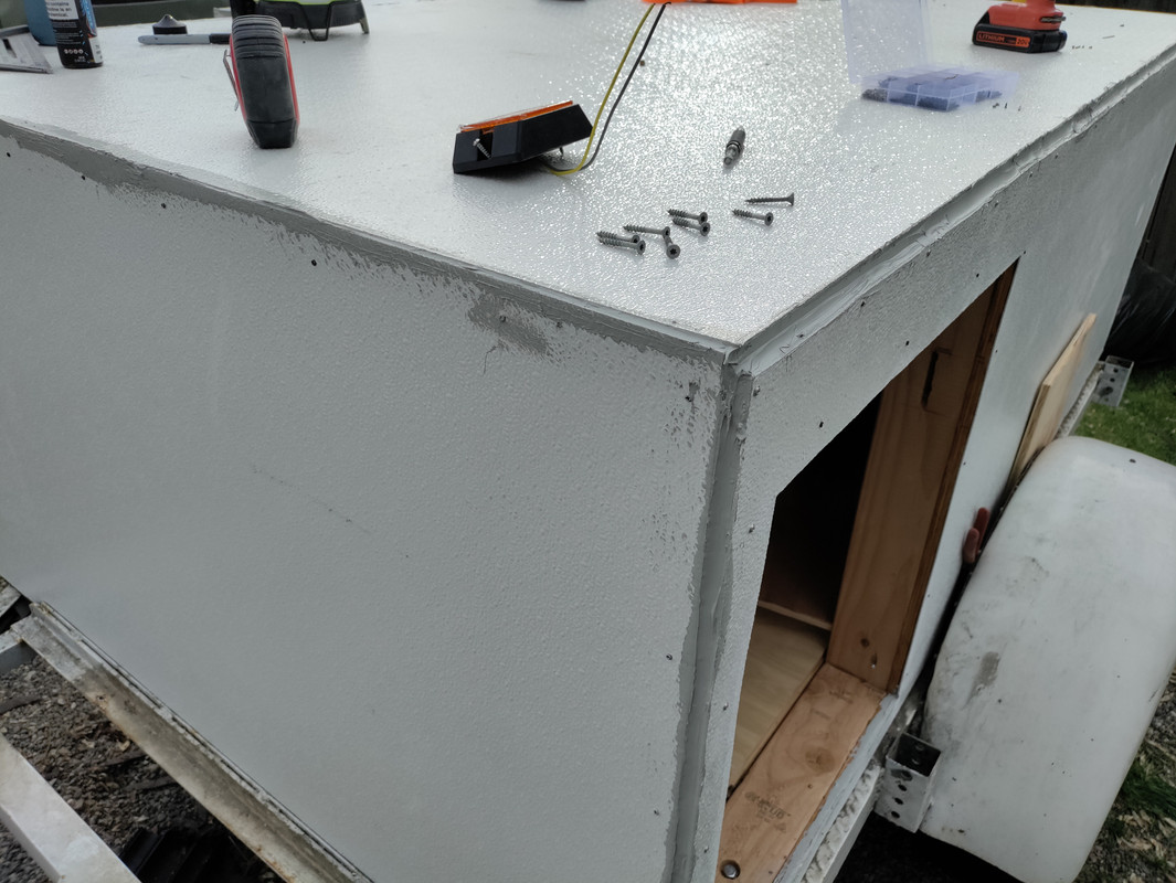

This is one of those units I'd love to camp beside and share a few beers while talking how we got started...Finished getting all the panel lung on the outer walls today, and got all the edges of the box completely sealed with sikaflex. It's not pretty yet, but all the edges will be trimmed with aluminum to hide the sealant, after its all painted.
