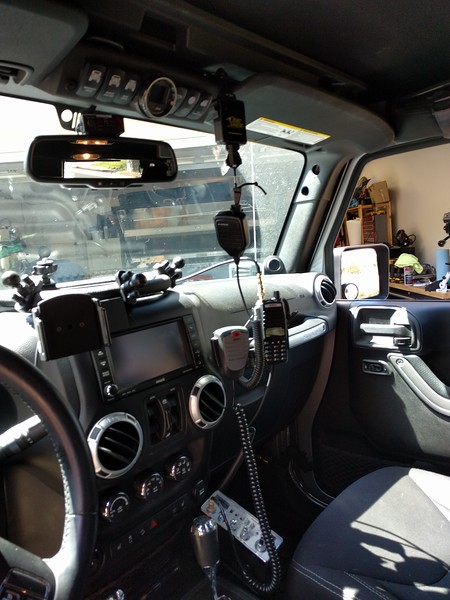

My current radio setup..subject to change of course! Btech GMRS V1 on a ram mount with custom bracket from a guy on Expedition Portal and a Uniden CB on a Quadratec JK mount, and yes full trucker with a gear keeper for the GMRS mic:

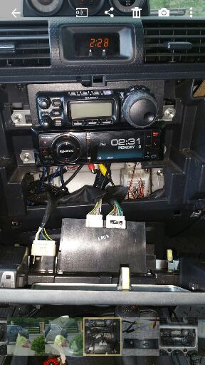

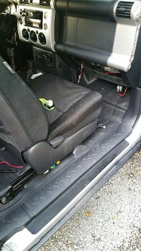

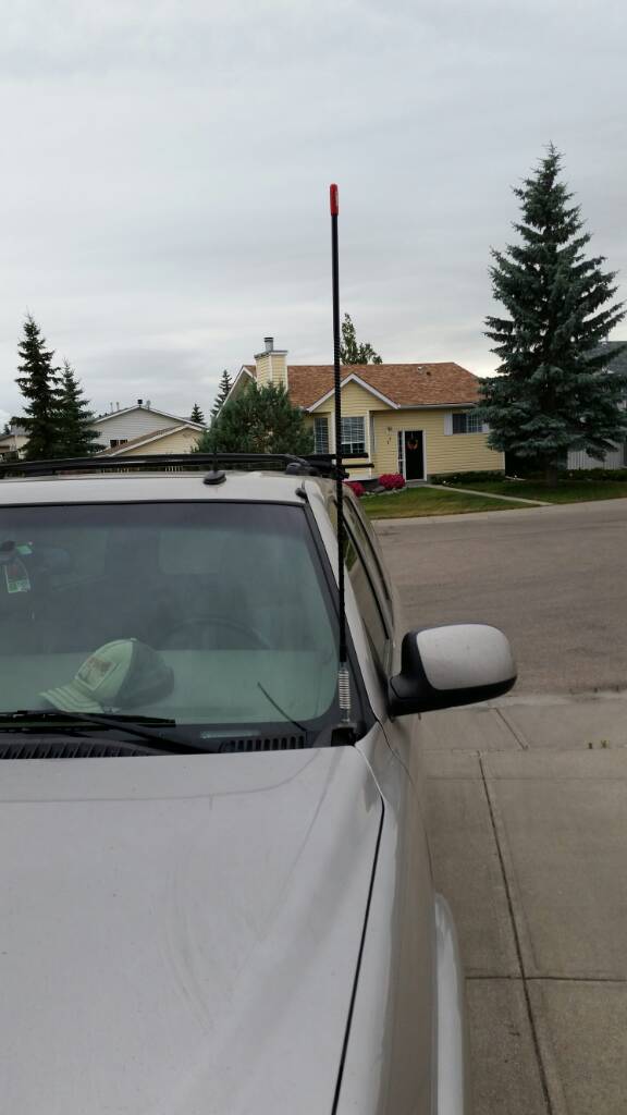

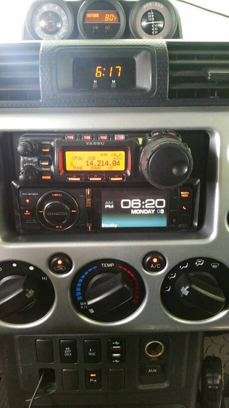

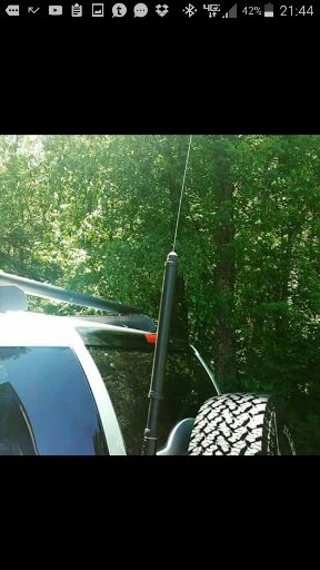

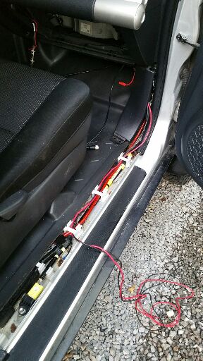

I'm powered straight from the battery with a power pole connection under the glove box in the FJ. I used a single DIN cover plate I modified to hold the remote head of the Yaesu FT-857d. The radio and diplexer is currently under the passenger seat with the power cords running under the door seal covers. I'm using the Yaesu ATAS 120a antenna on a Boztech? NMO mount grounded to the rear door hinge bolt. The antenna tunes fine when changing bands. I'm pretty pleased with the results and happy to have HF mobile now.
I can add in power poles and connect other radios to the main battery supply as needed. I use an MFJ 6 way splitter for that.
