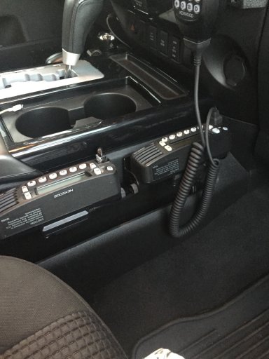

Mine are kenwood 512 channel vhfs. One is analog and the other is digital. I have both split mounted on the side of my center console. The bodies of the radios are under my seats and one has a remote mic mount. Antennas are fender mounted. 1 w/b coil and 1 is a 1/4 wave cut to my main freqs I run. Not much CB use where I'm from. But it'd be nice to maybe get that in the future for short distance Comms. All your guys installs look great!ImageUploadedByOverland Bound Talk1467760930.845814.jpgImageUploadedByOverland Bound Talk1467760975.952005.jpg

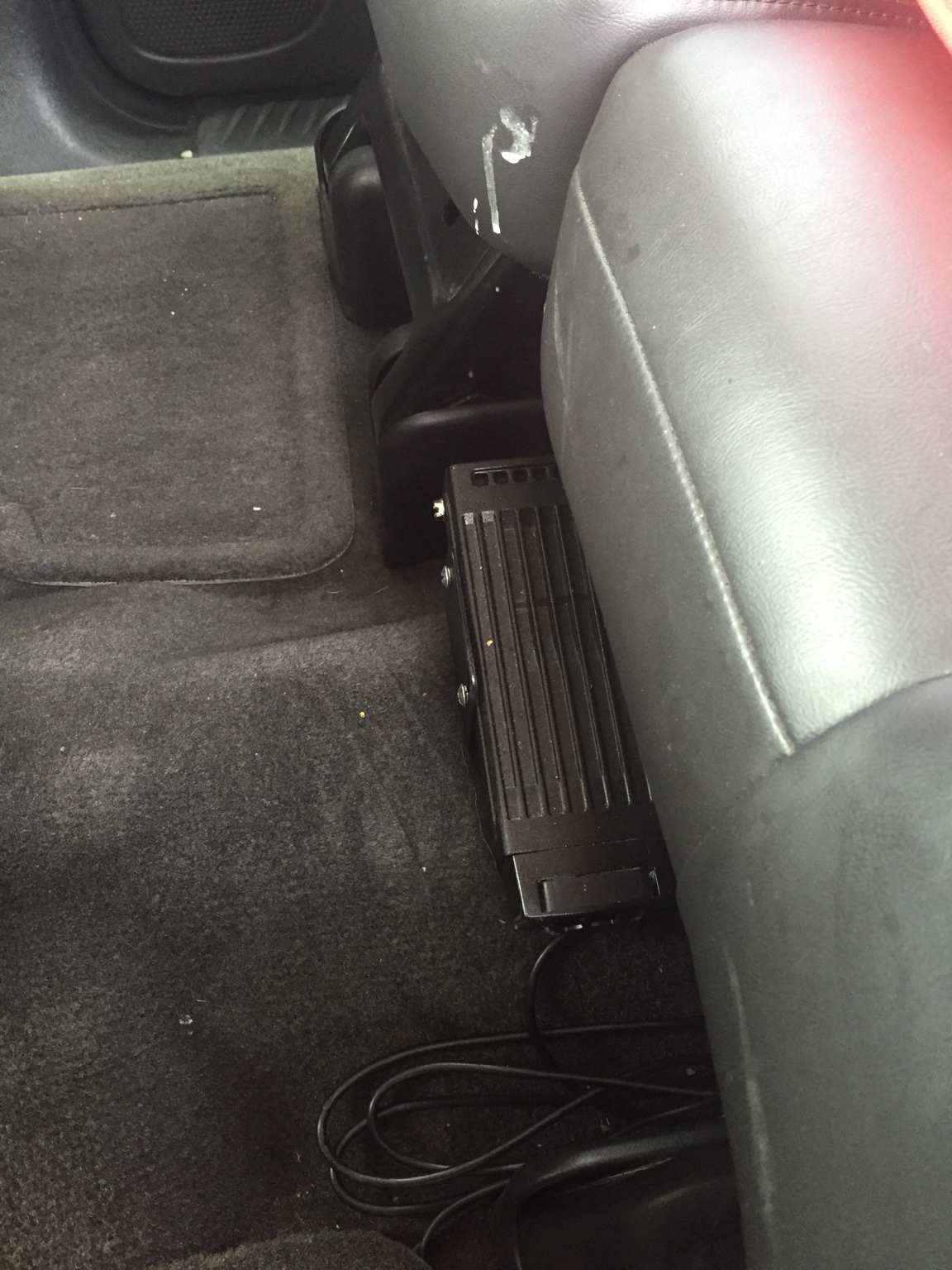

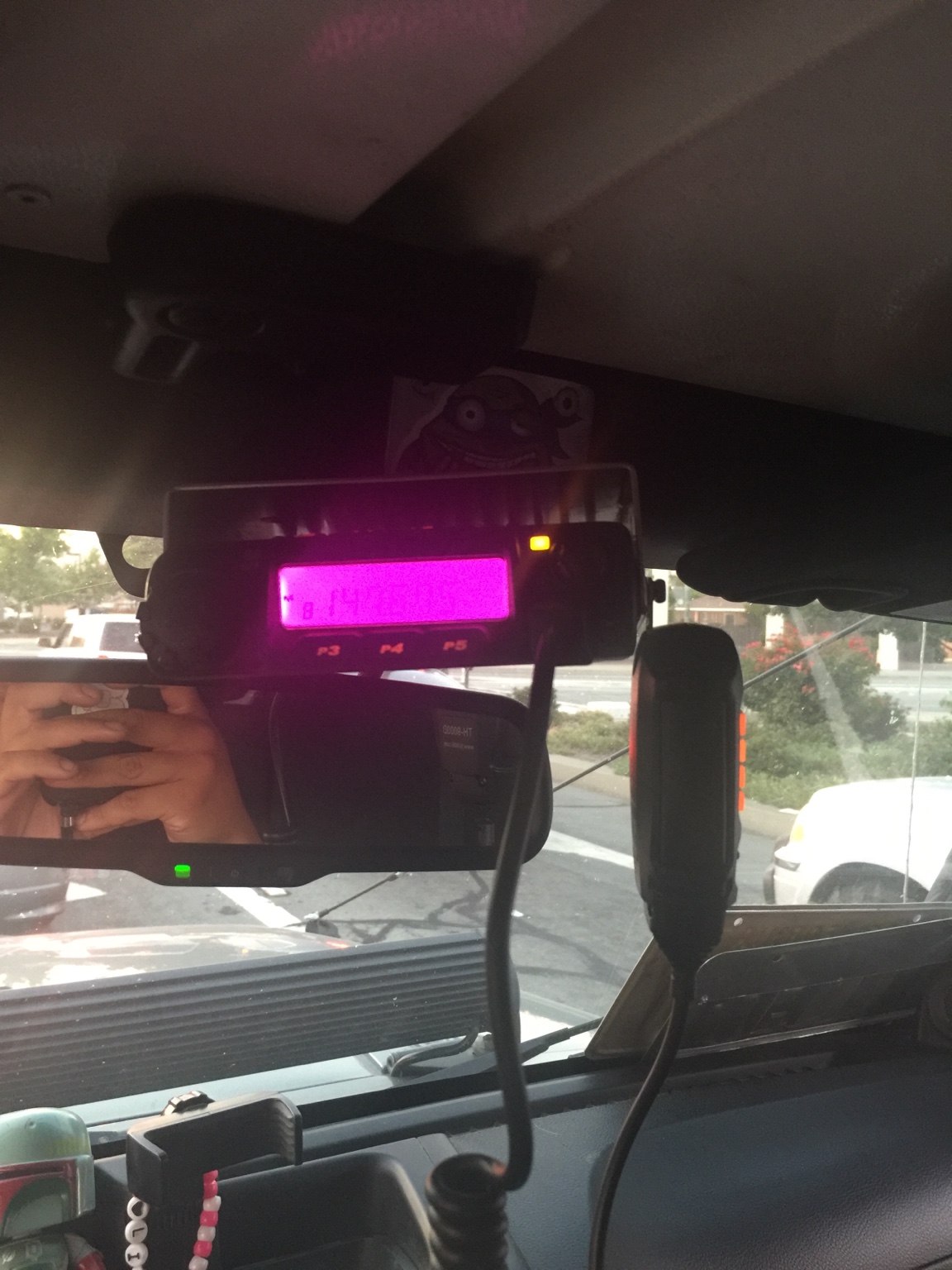

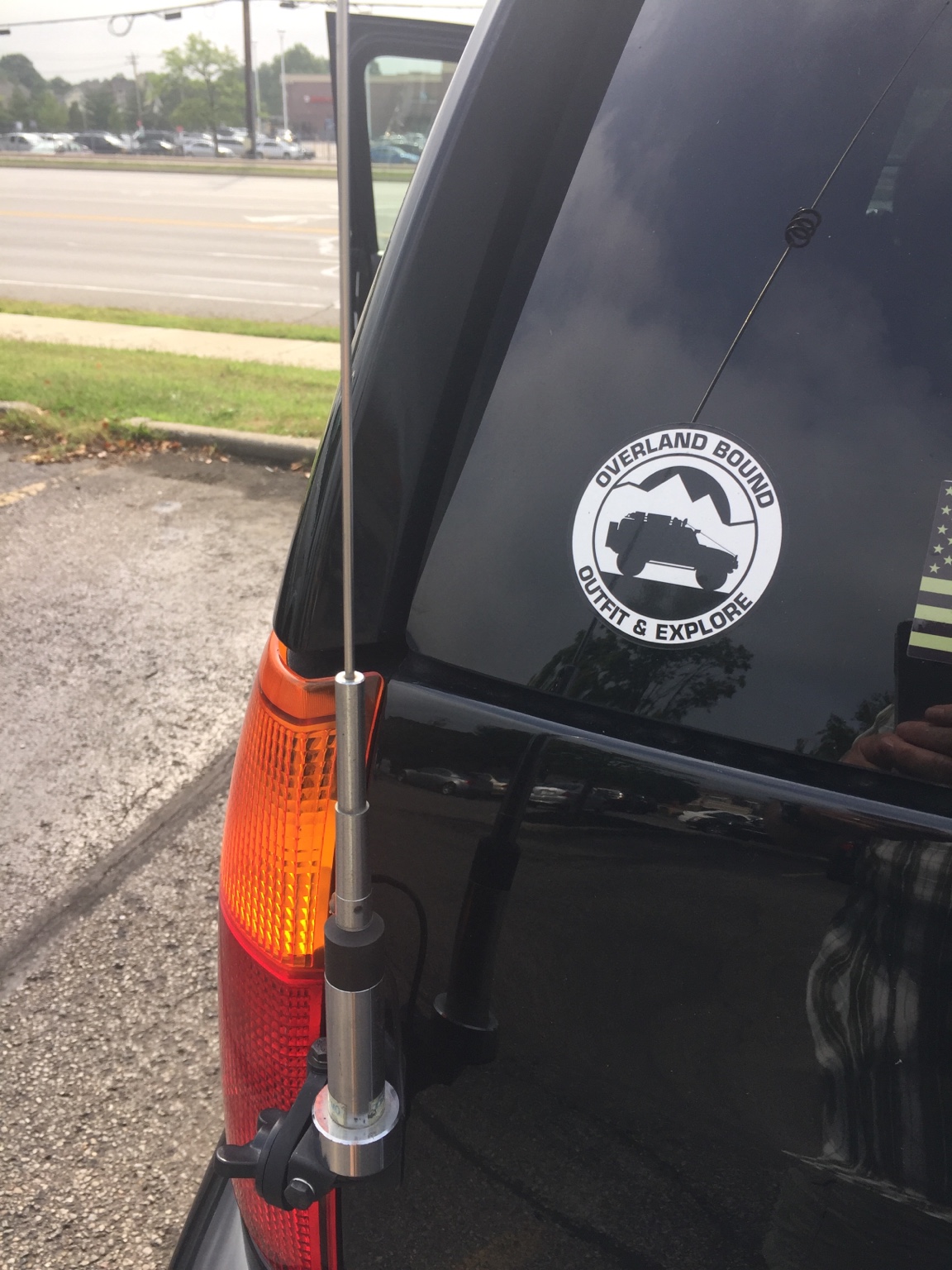

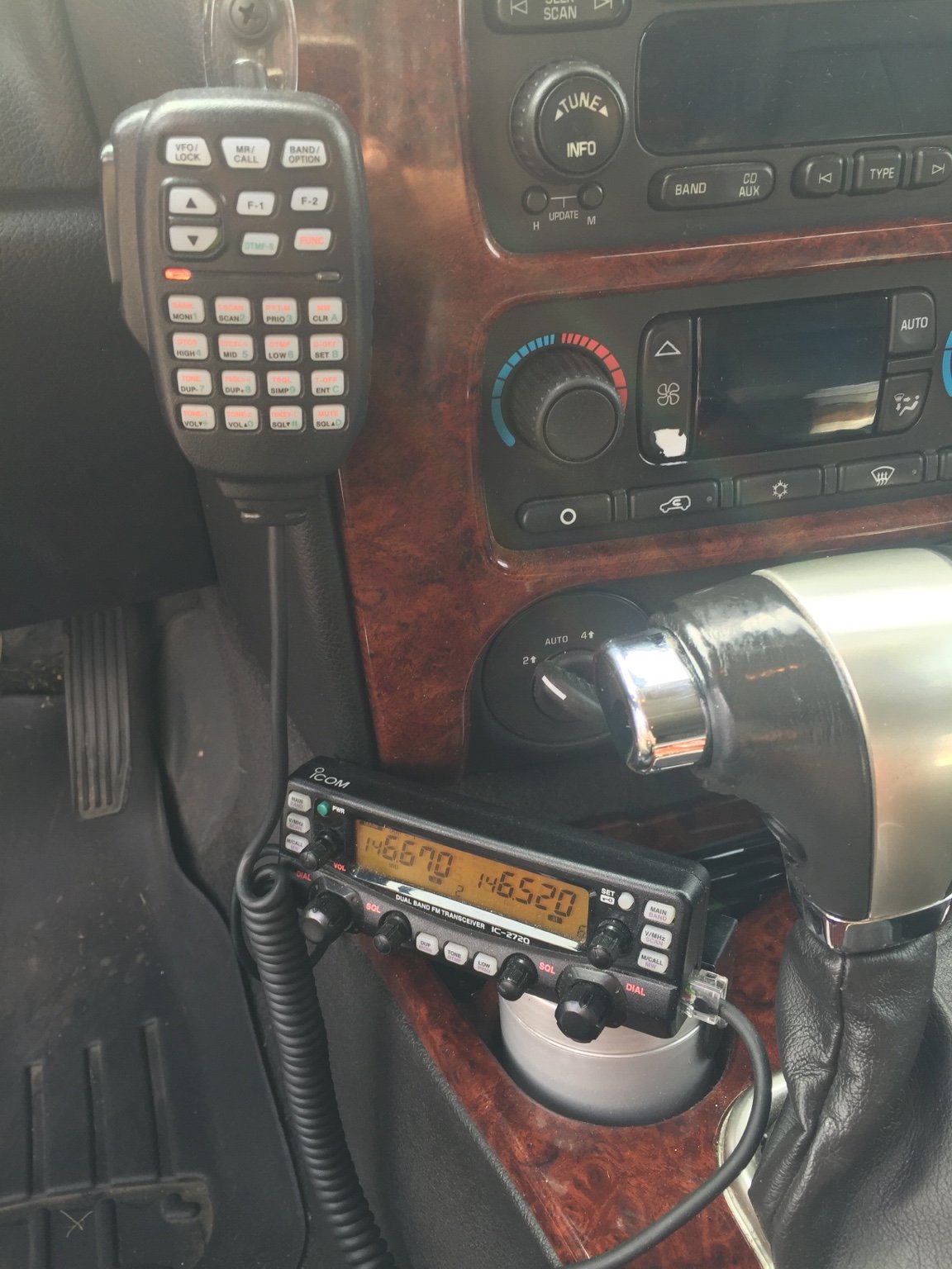

I'm operating a ICOM 2720 dual band with a separation cable. The control head is mounted via a cup holder with the main body under the rear seat of my '08 GMC Envoy.
Eventually I'm going to switch out the Icom with my Yeasu ft857d all band all mode.

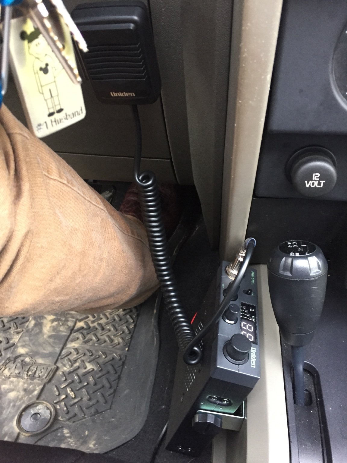

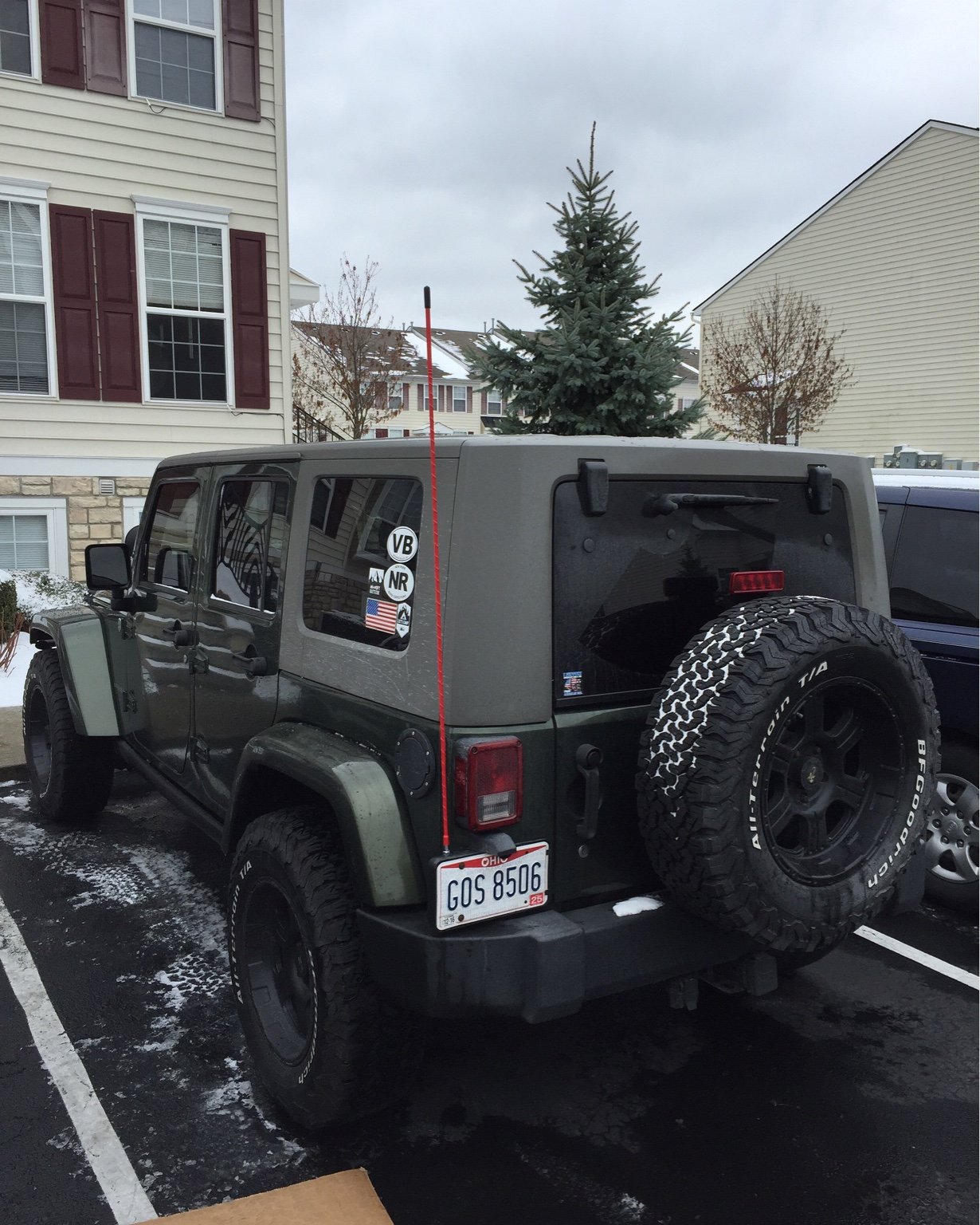

On my Jku I installed a Uniden pro 510xl on the driver side of the gear selector. Since it's a compact unit it fits really nice. Then I mounted the mic just behind the windshield washer switch on the dash. Really easy to reach. I did a lot of research on mounts and found a mount by CoolTech. It is an antenna mount on the license plate. Puts the antenna in the open. I love the location and I get a decent swr about 1.5:1-1.7:1.
Antenna wise I started with a firestik firefly 4' which is now my trail antenna since it is so flexible. I wanted to try other antennas out and see what was the best. I really wanted a stout antenna for highway use. So I ran out and got a Wilson fiberglass 4' and couldn't get it tuned well and wasn't receiving the best. Definitely wasn't reaching out either. So ran back to the truck stop and got a K40 fiberglass 4' and that thing tuned in great, crisp reception, and got out pretty good.
Recently did a night run and forgot to switch antennas. That K40 got beat to death on trees and my hard top. Didn't even flinch. Held up great! Mount stayed intact and never loosened up either. Very happy with my setup!
Here it is with the K40 after the night run.

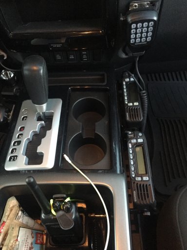

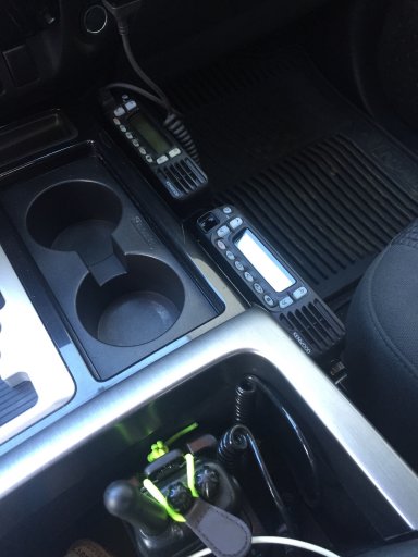

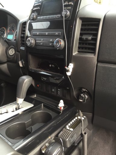

Bit of a repost here...All great setups guys! I run my radios with split mounts so only the face takes up some real estate and the bodies of the radios sit under my seats. I also have my portable charger in the console but I will be moving it soon to a more permanent location. ImageUploadedByOverland Bound Talk1469678942.816806.jpgImageUploadedByOverland Bound Talk1469678954.756141.jpgImageUploadedByOverland Bound Talk1469678965.594143.jpg

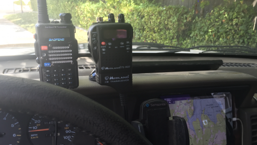

How do you like the Midland 75-822? I ordered it through Amazon yesterday and like that it's small and portable. What antenna are you using? I'm new to the CB radio world and am trying to see what else I will need to set it up on my rig. I was thinking of a Firestik antenna...whats your take on that? Thanks in advance!
The radio is awesome. I don't count on CB for anything further than a couple hundred yards, so the antenna doesn't really matter much. I just ordered the magnetic one that Amazon said people ordered with it. True radio guys will have a lot to say about wave length and SWRs, but I don't know that much about it. I have a 1/4 wave (102") whip mounted on my tire swing-out, but I only use it for flags (required in some OHV areas).
