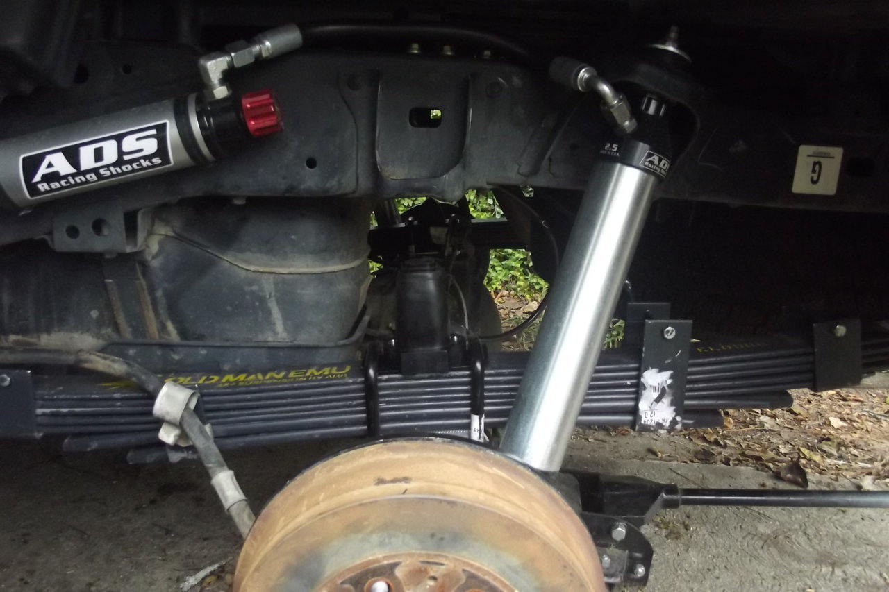

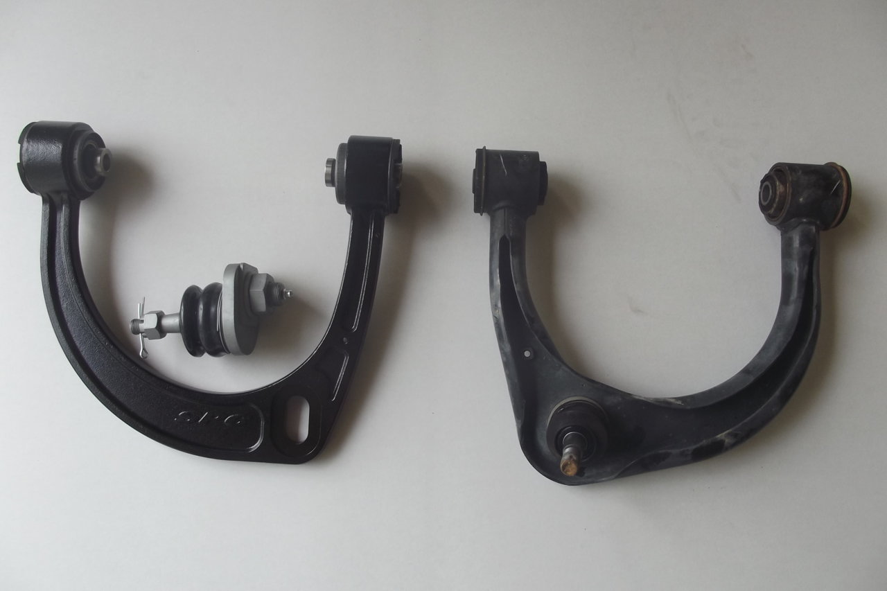

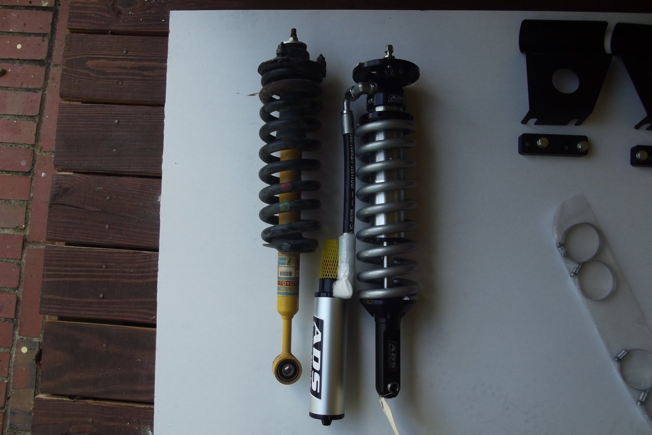

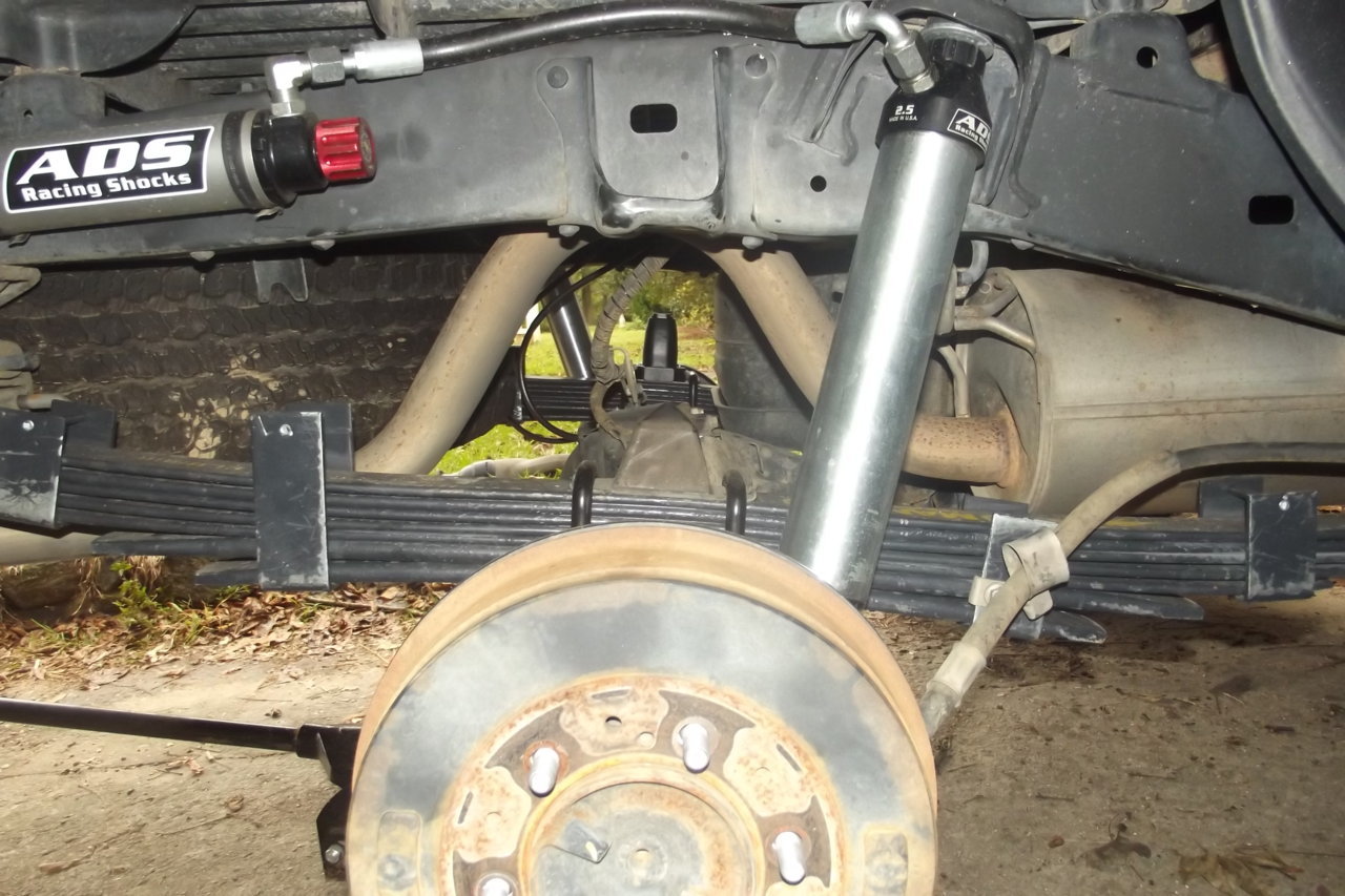

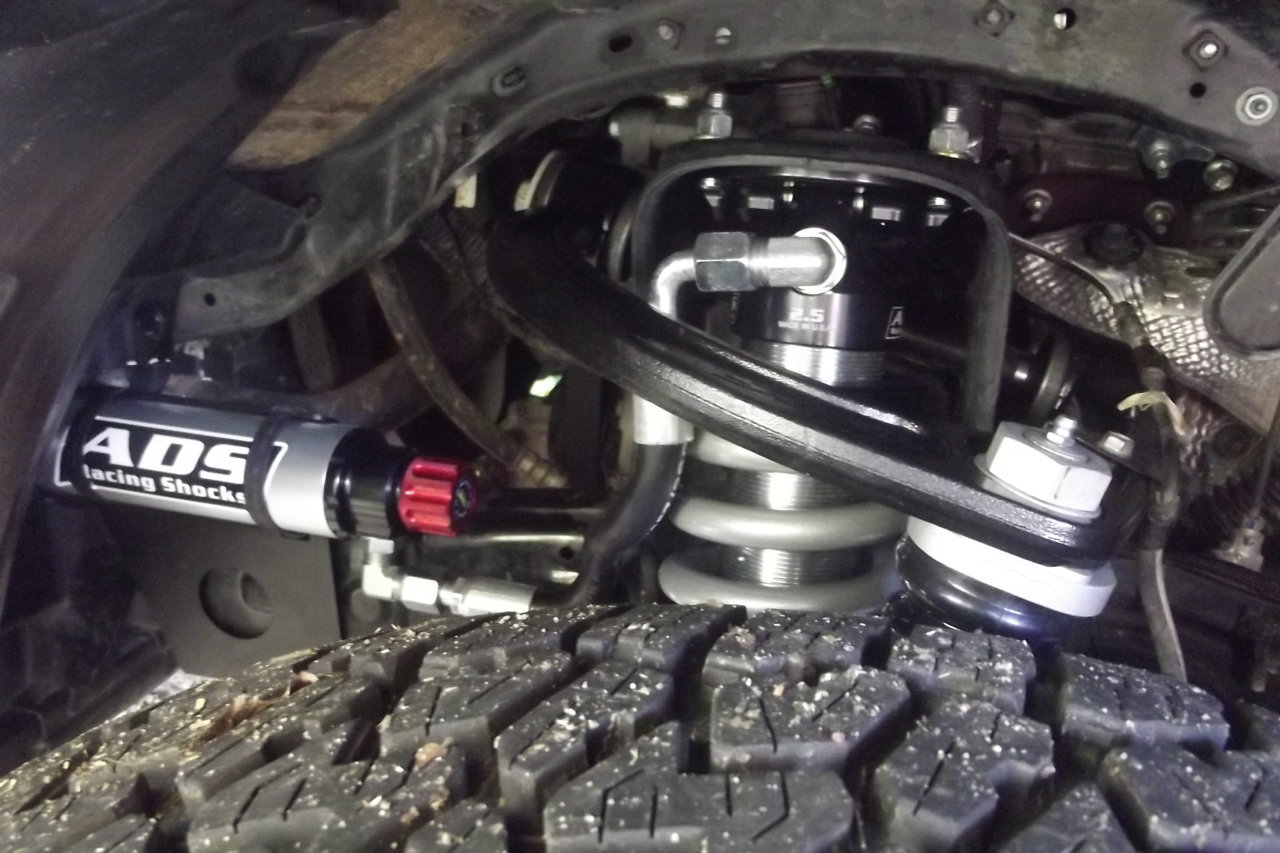

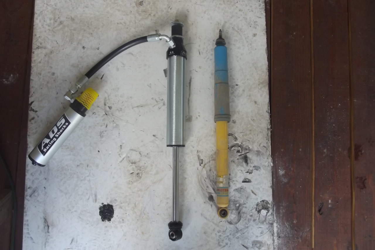

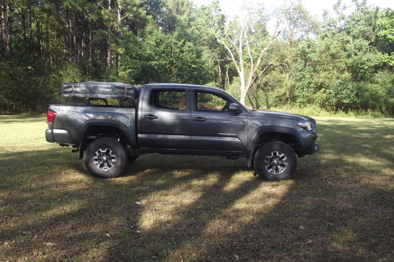

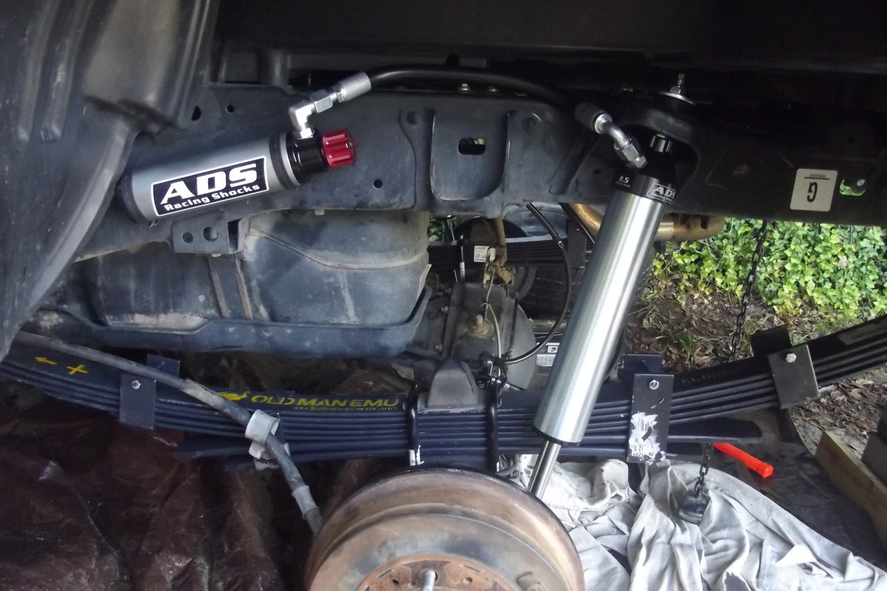

ADS suspension is in. Here is everything I did this past weekend.
Miles ~21,400
Changed both front and rear diff gear oils, used Lucas 85W-140 per ECGS, sending oil sample to Blackstone for analysis
ECGS Bushing
Front ADS 2.5" Coilover with RR and Clickers

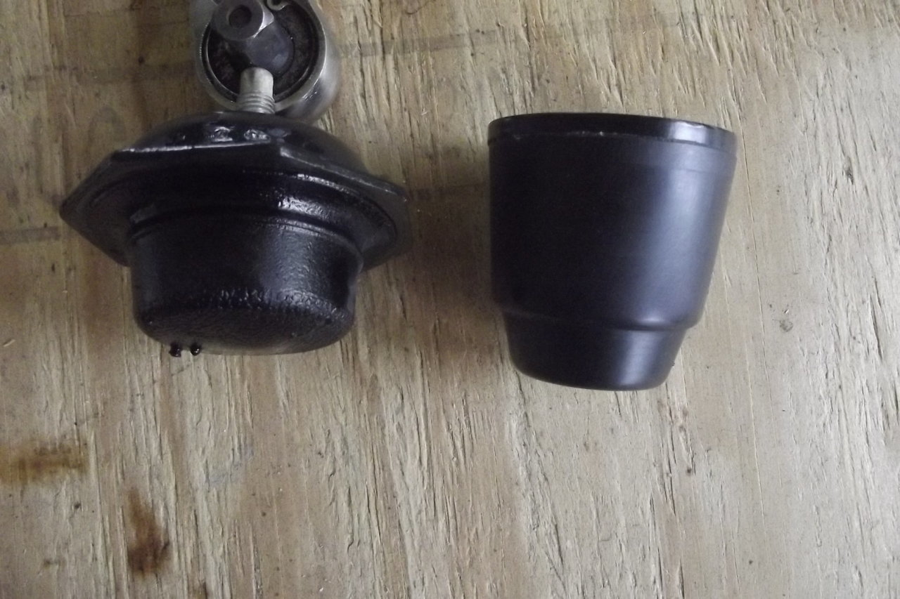

LR SPC UCA, ball joint grease with STA-Lube SL3330
Rear ADS 2.5" Shocks with RR and Clickers

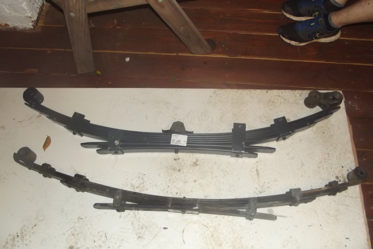

HD Dakar Leaf spring with energy suspension polyurethane bushings

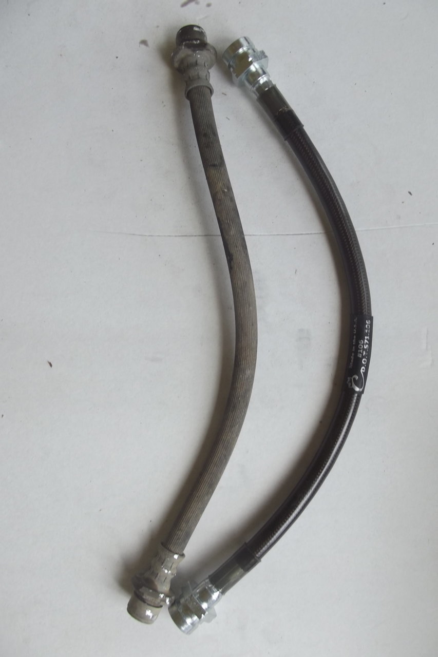

Steel braided extended brake lines, bled with Mobil 1 DOT-3
It was a hell of a job for the driveway. A friend of mine came down and helped me knock most of it out Saturday. I ended up not doing enough research and messed up one of my shackle bushings due to the metal collars they put in them at the factory. I eventually figured it out, used a jig saw to cut the collars out, ordered new shackle bushings, and completed the install today. Overall pretty straight forward install. My driverside preload is ~1" and my passenger side is ~7/8" and I have achieved ~2" of front end lift. The rear of the truck is over 3" lift, I dont have my camp weight in there yet, also waiting for my GFC to be installed in November. I am hoping itll settle down some and I may add some weight to help until I get my GFC. I left the sway bar off as well, we will see how it goes. Did a quick test drive and it feels good so far.

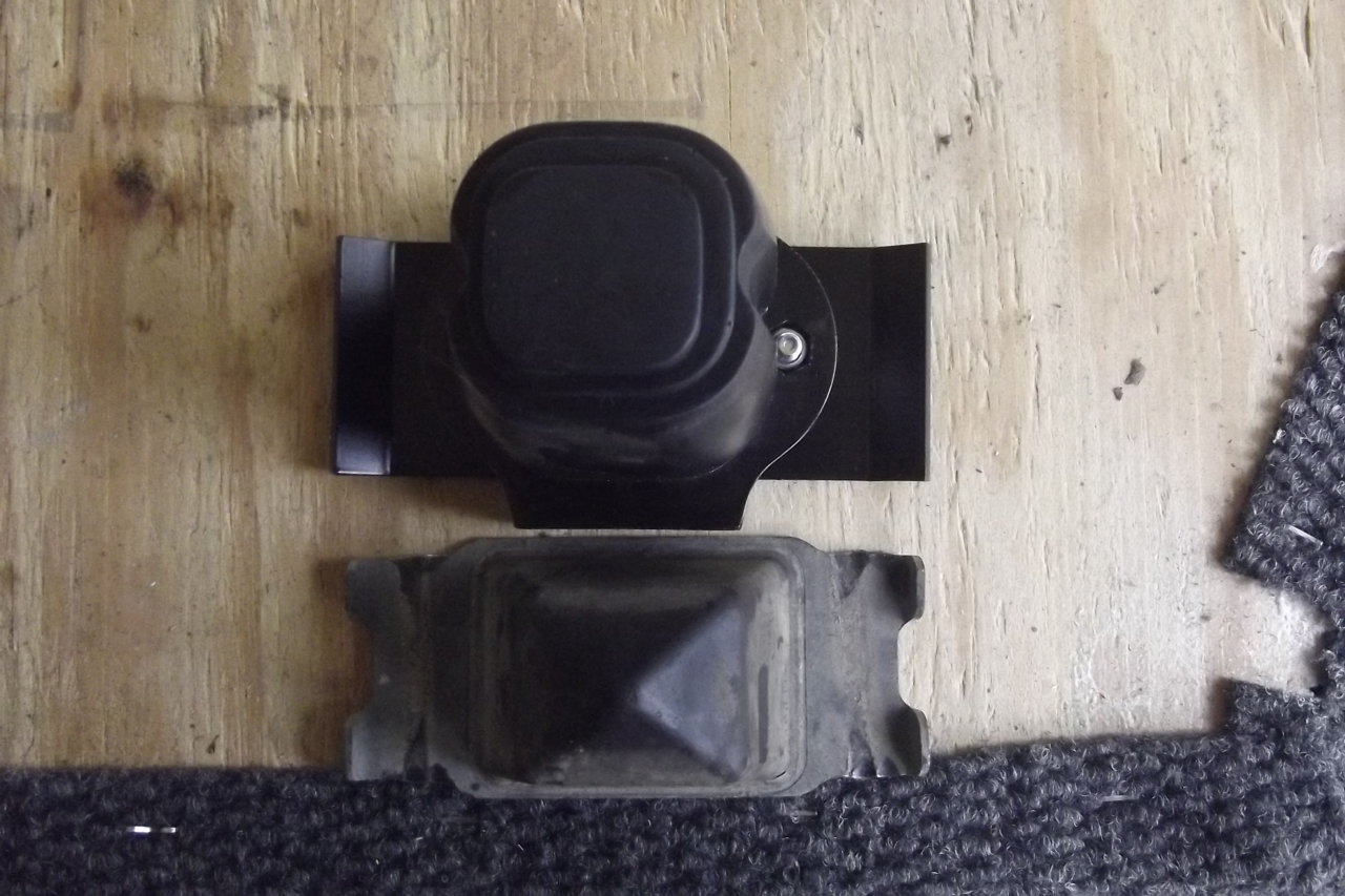

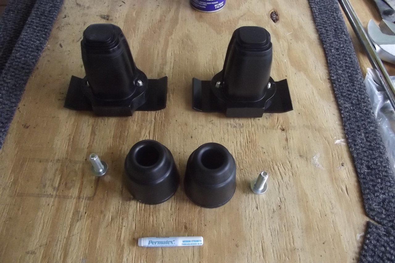

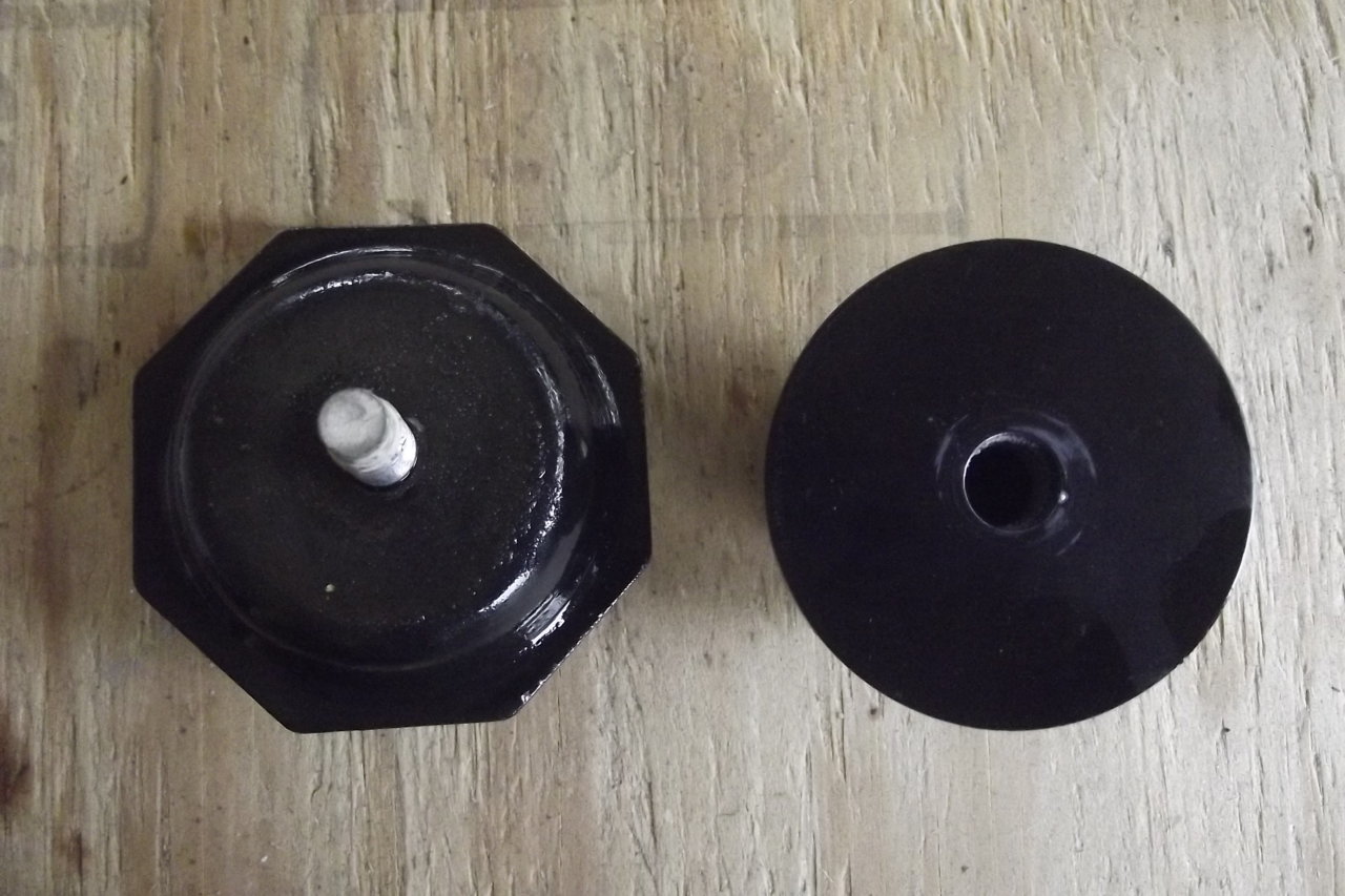

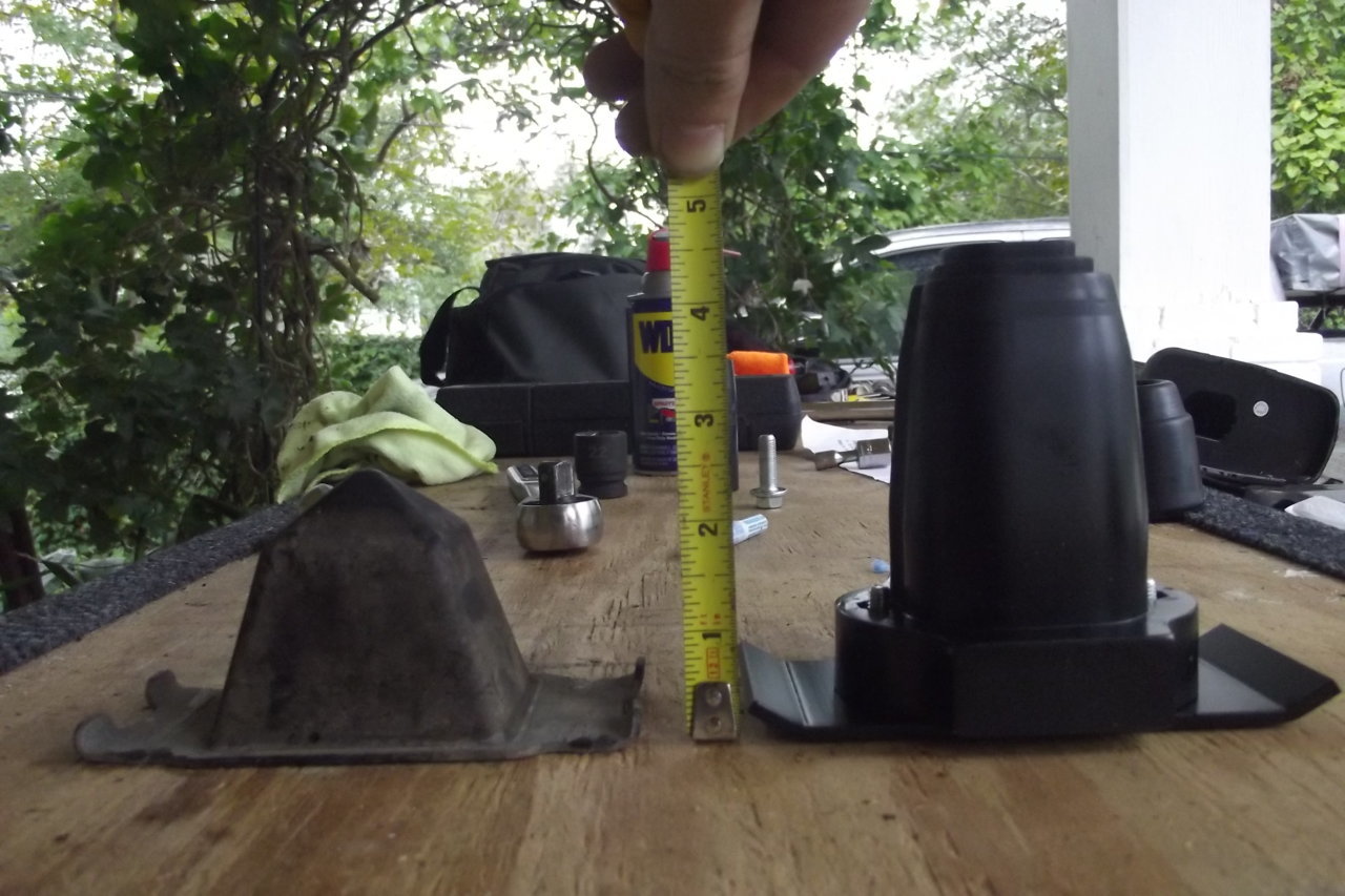

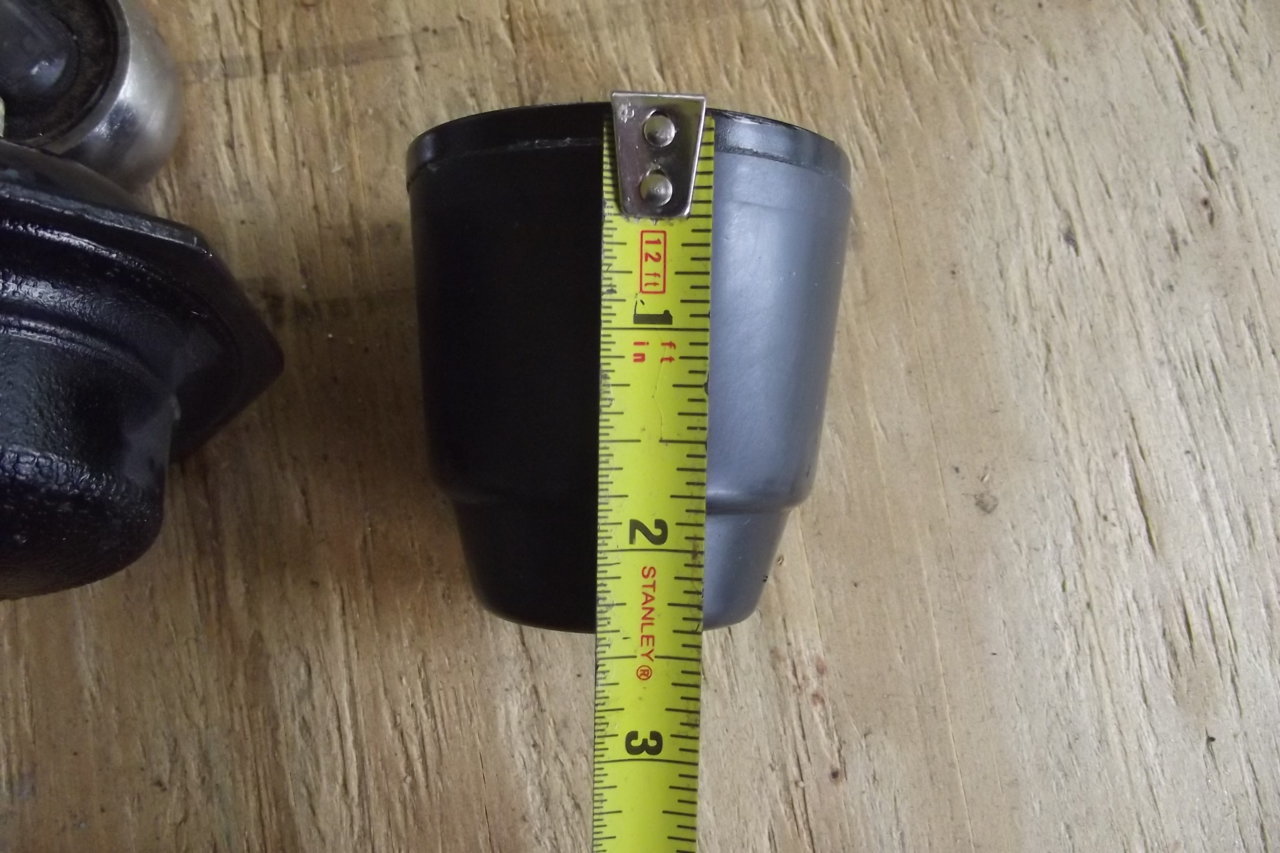

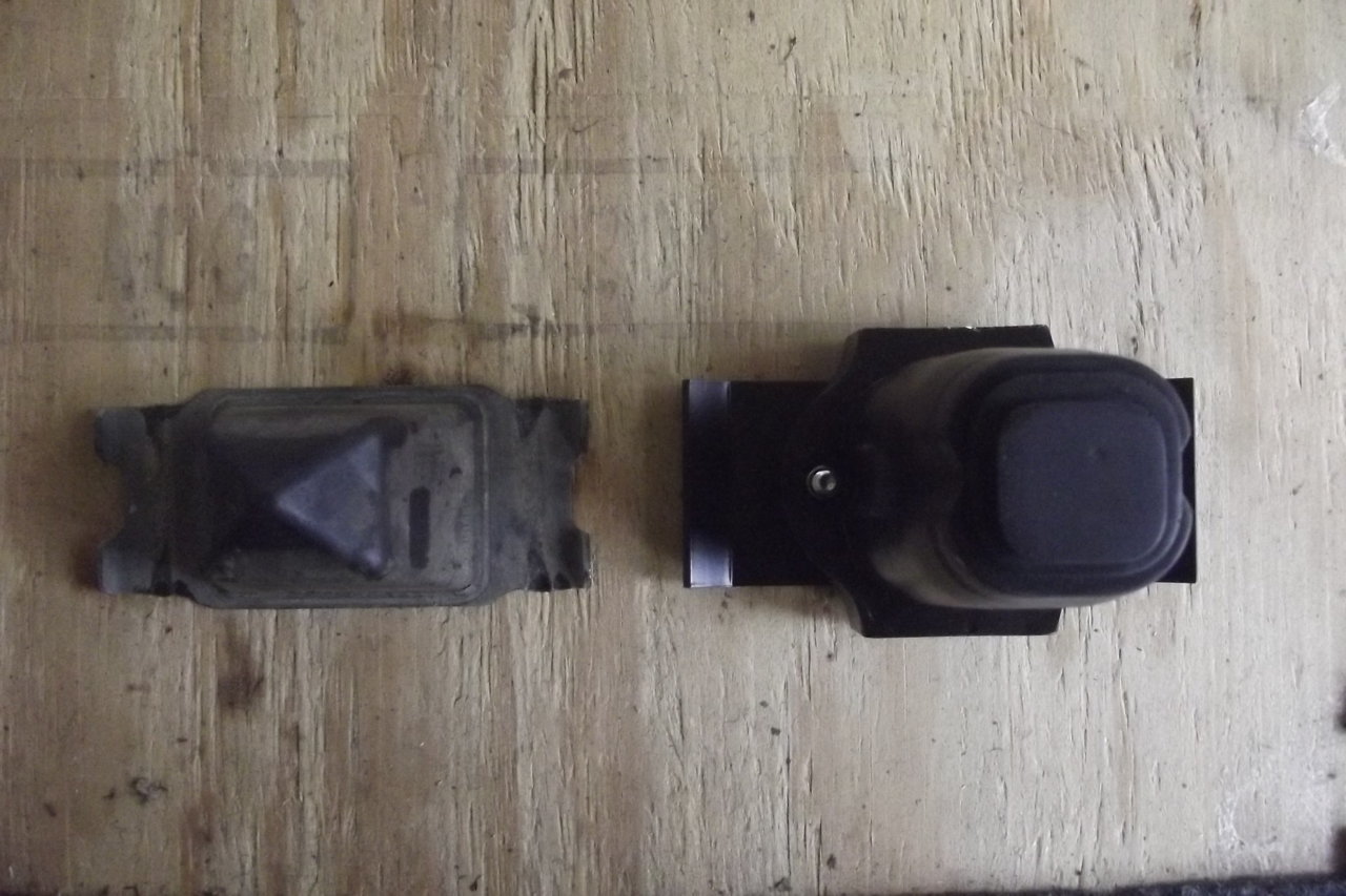

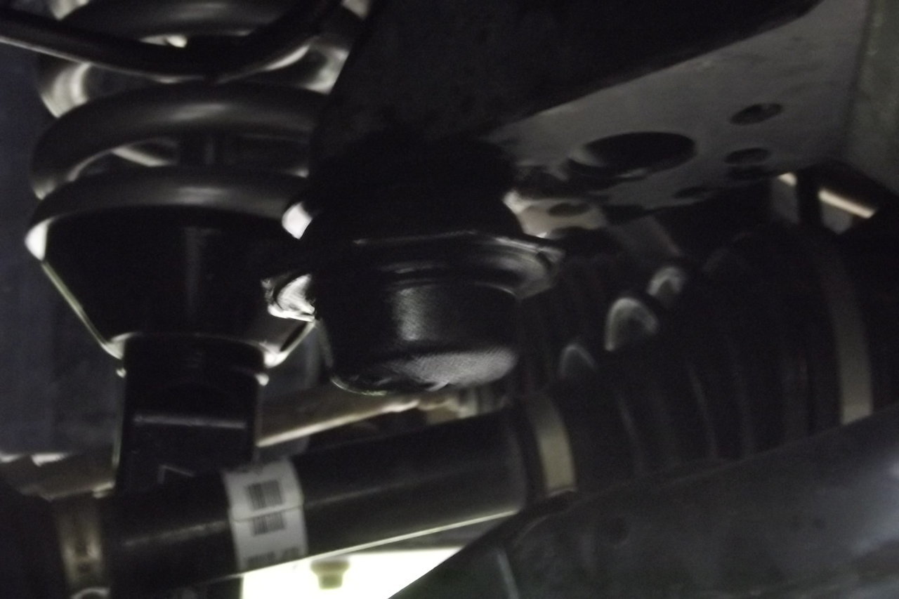

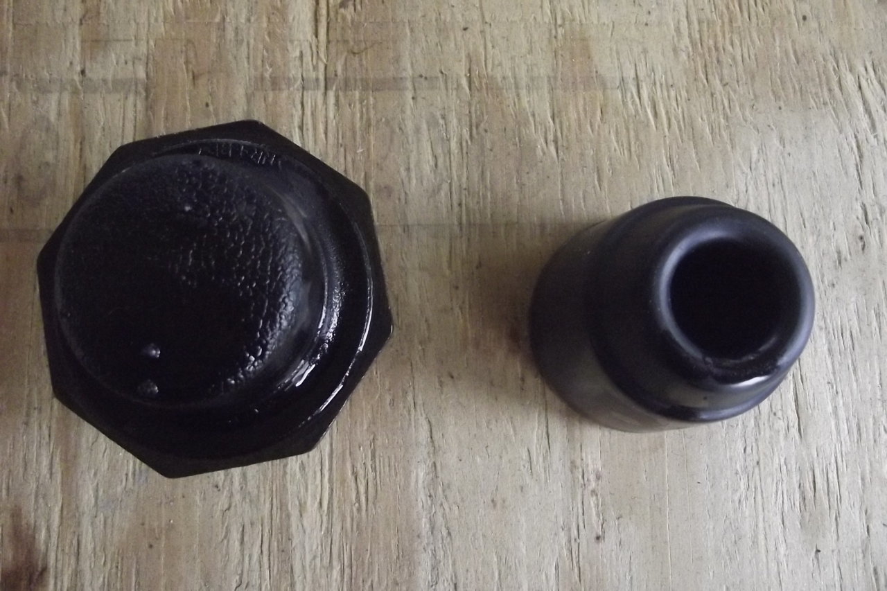

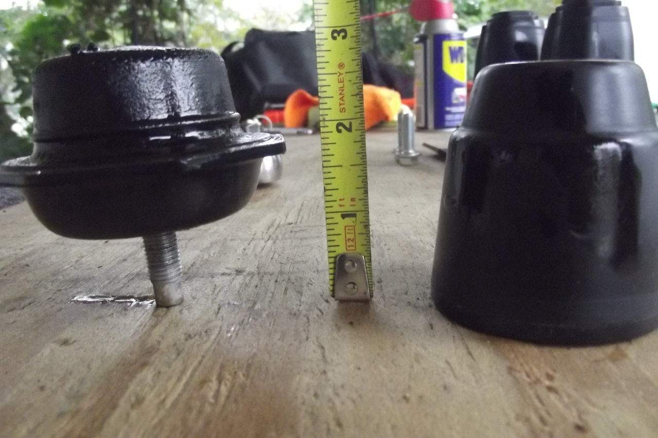

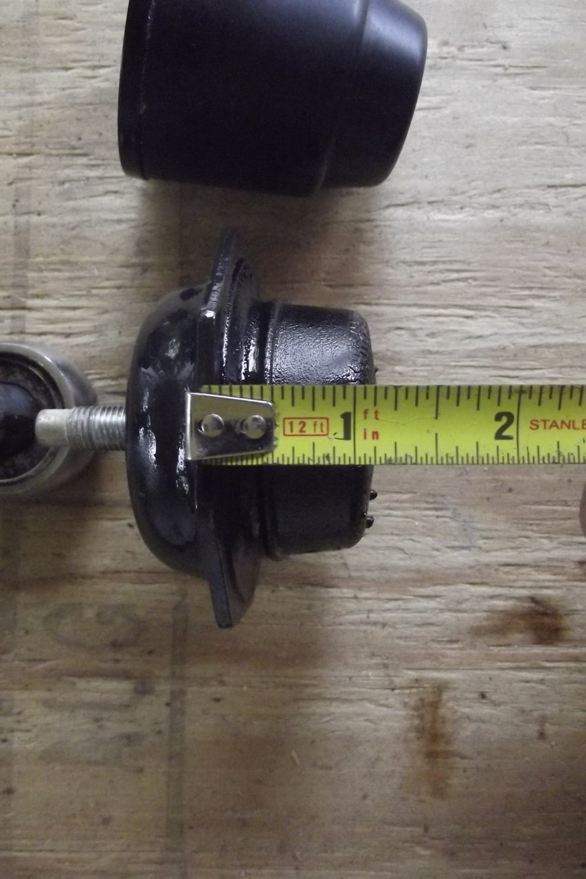

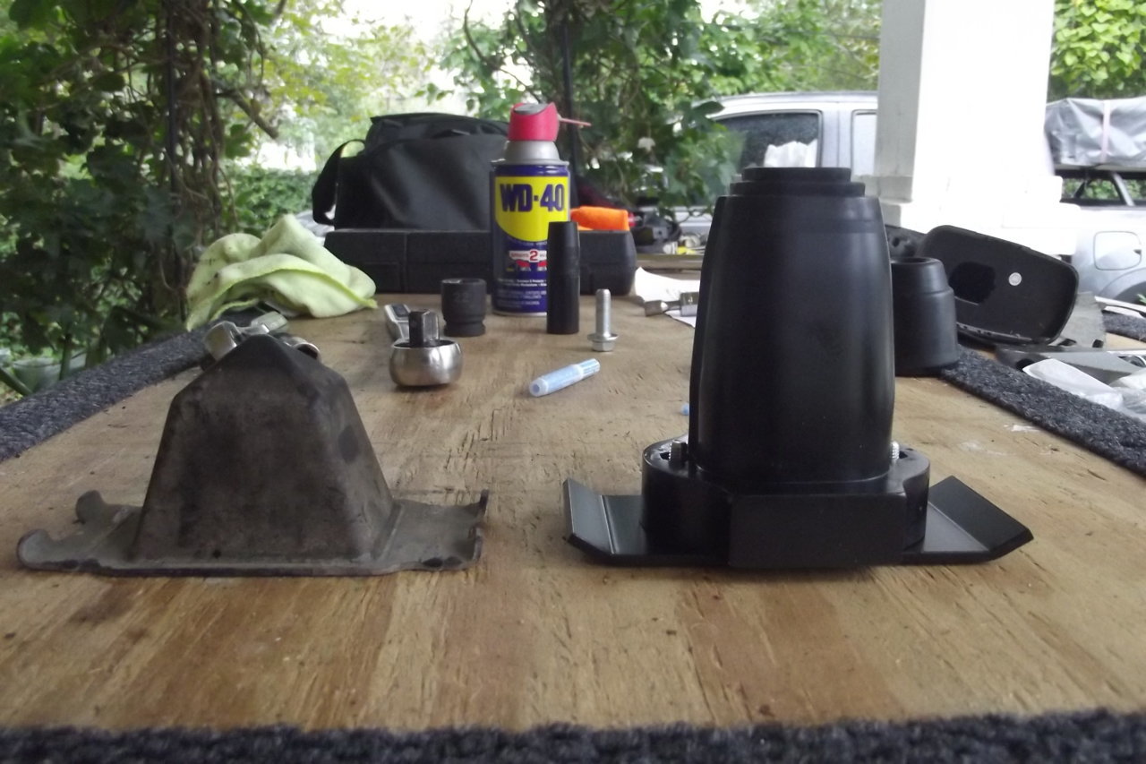

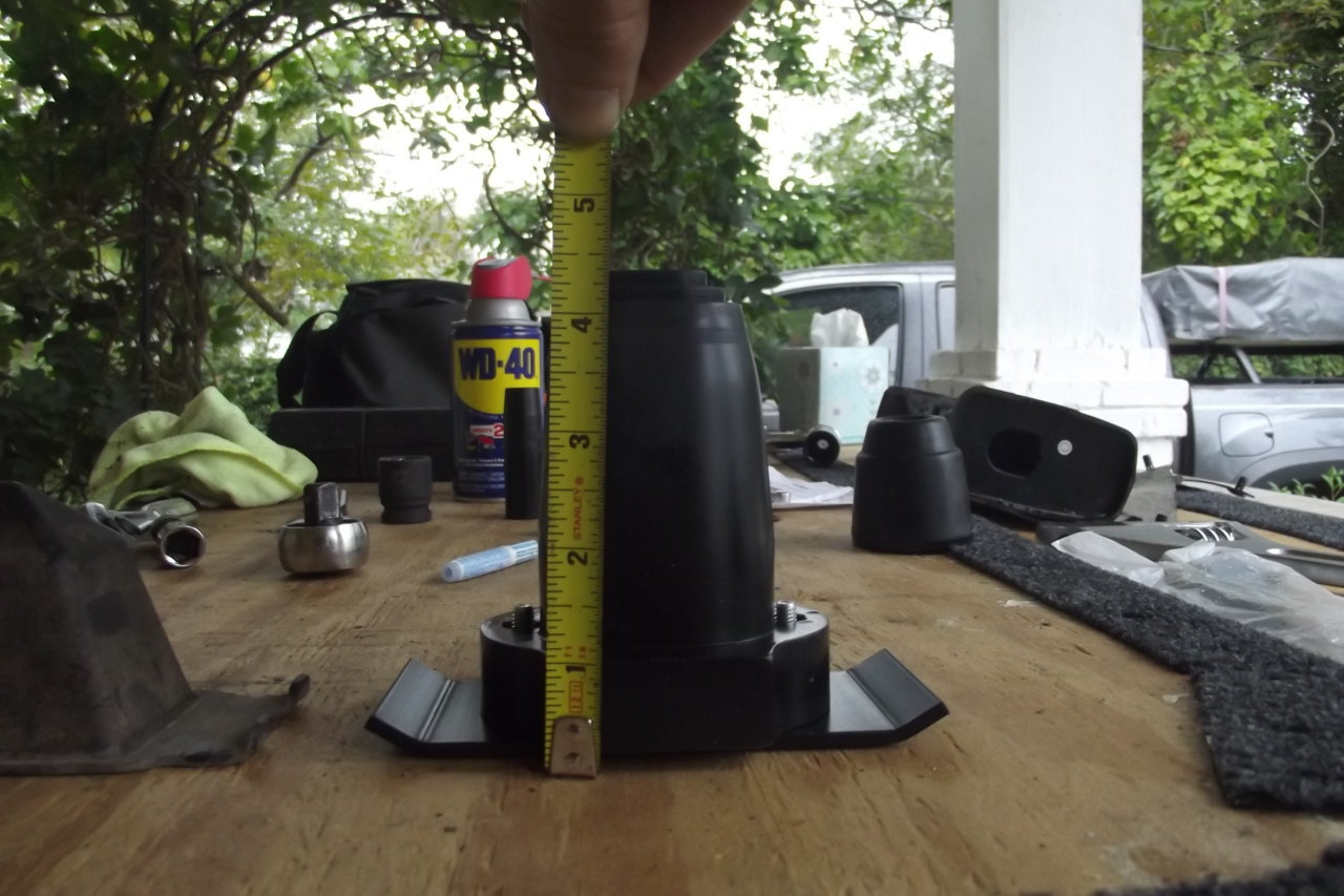

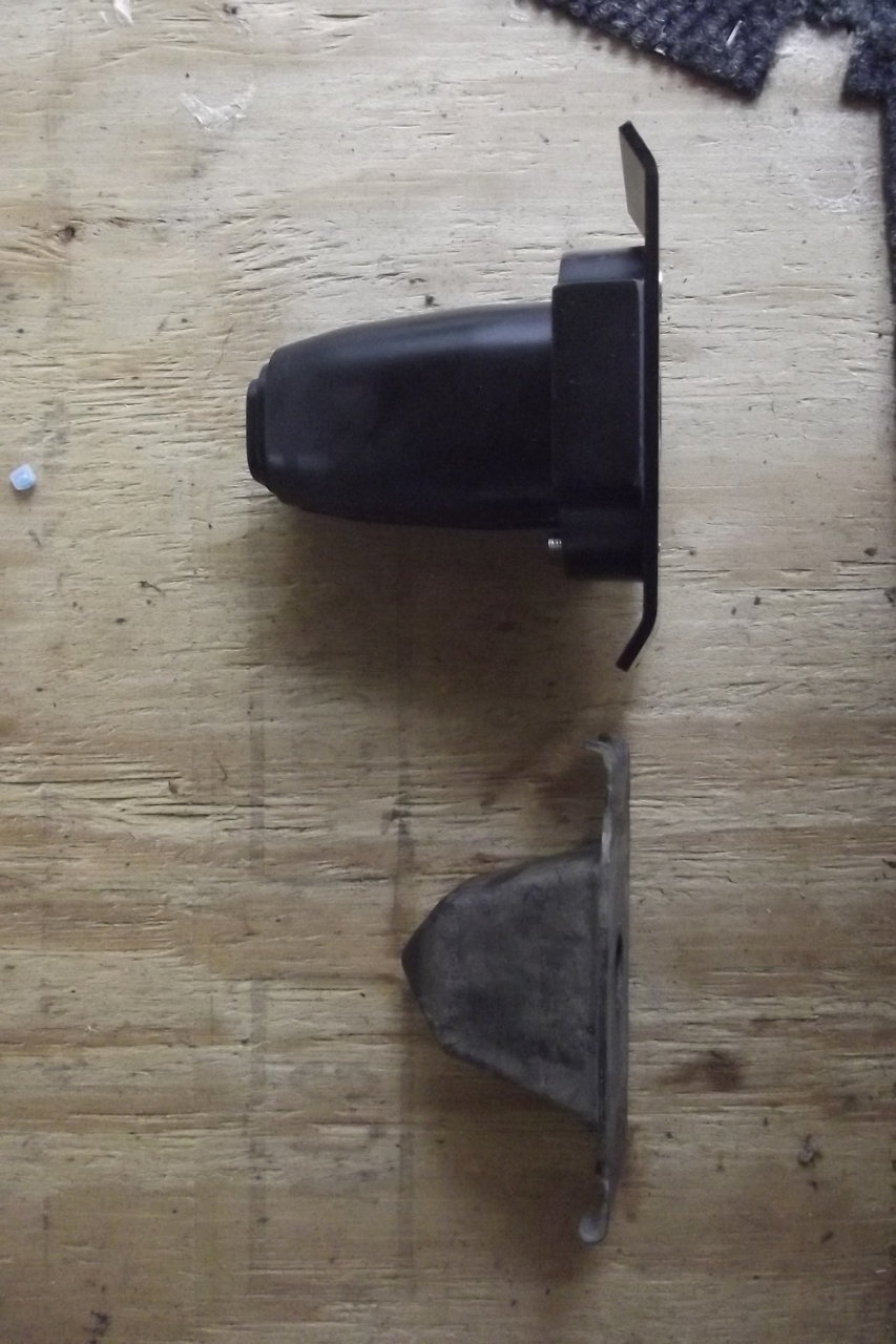

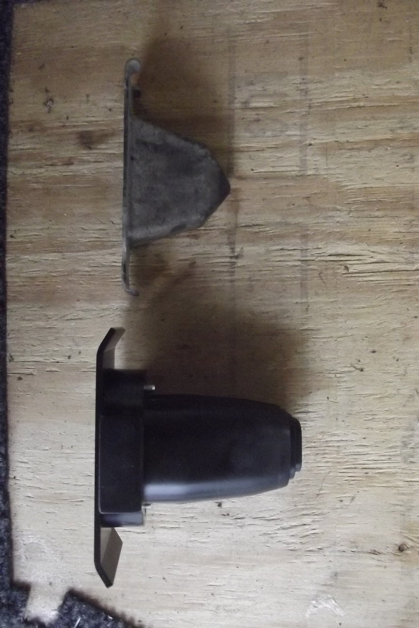

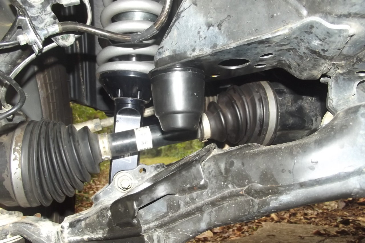

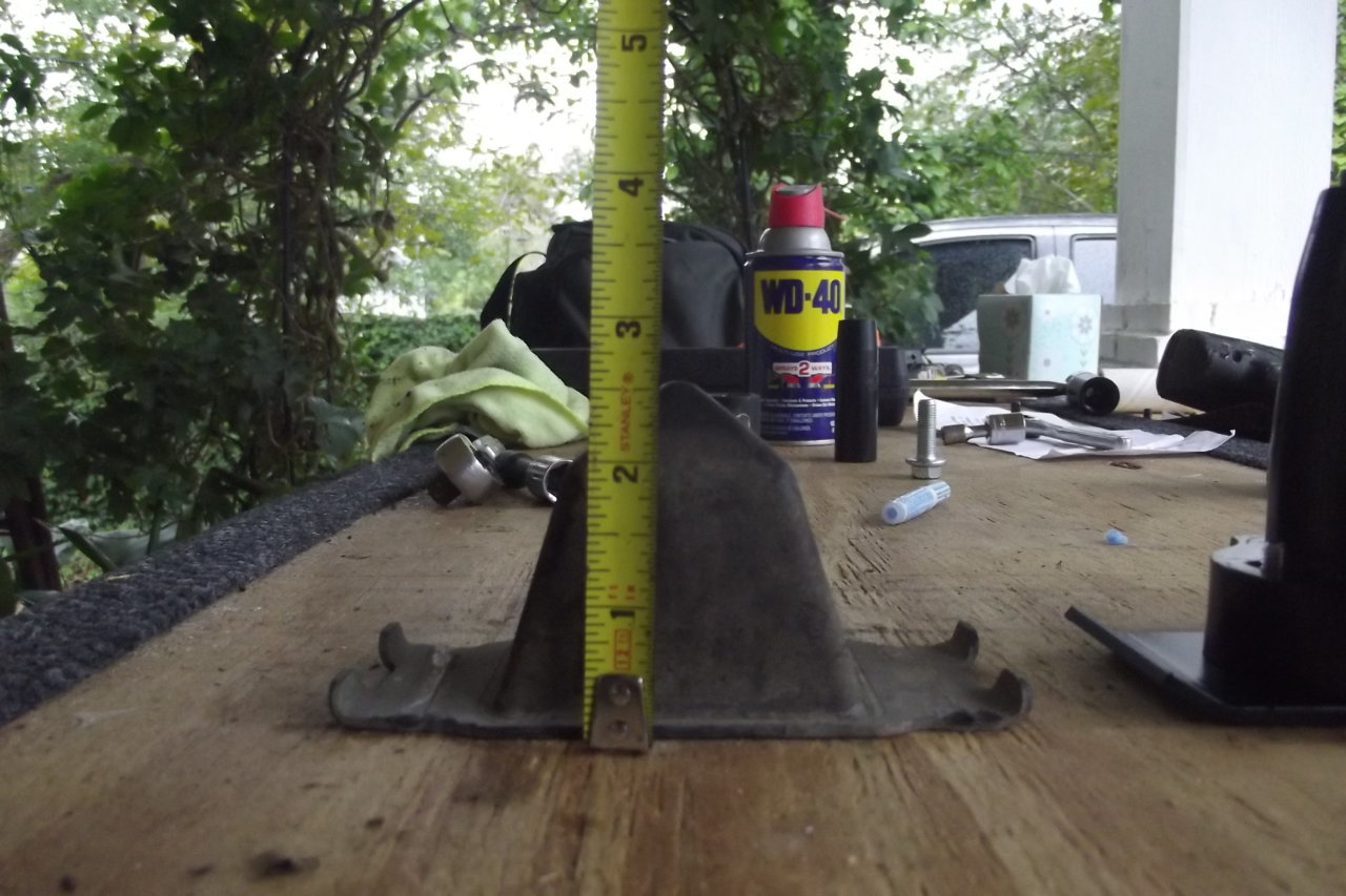

Ultra fast shipping from Plastics Guy (https://www.toyotabumpstops.com/). Paid for the bump stops on Tuesday and Received them Today (Thursday). As promised, I got them installed so they could be tested this weekend at Morris Mountain ORV.
1st impressions and install
-Packaged well and double wrapped but paint still scraped from shipping, no fault of the seller
-Look and feel like quality bumps, you can tell the difference in the rubber and the quality from factory
-Nice painted mounting points
-Easy to install, very straight forward
-Bolts and loctite is provided
Here are some pictures of the new bumps, old bumps, and comparisons:
I did not order the U-bolt flip kit but most likely will at some point.
