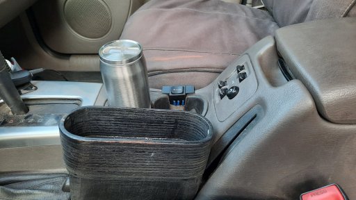

So, a double side switch which I still had, and some extra wiring and voila, now with a bypass the window can go up and down again.

Here the visible switch of all the hard work I had with this bypass and the wayt to this solution.
