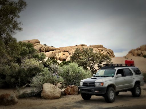

This is where it is today.
2000 Toyota 4Runner Limited V6 4WD Highlander trim. - $5,500
@Providentpathfinders on Youtube and Instagram
Drivetrain:
-3.4L V6, Original Engine 267,xxx Miles
-4 Speed Auto
-4:30 Gearing
Front End:
-Tundra Bilsteins w/ unknown springs from a 2008 TRD Taco - qty1 amazon warehouse $77 qty 1 amazon $89, Springs (which came with 4600s) $90
-Shaved UCAs with Energy Suspension bushings - Bartered
-NAPA Steering rack - $260
-Wheelers bump stops/sway bar kit - $24.00
-Toyota LBJs NIB - Buddy hookup $80.00 for both
-Duralast OTRE - 2qty $29.99 each
-Whiteline Racing LCA bushings
Rear End:
-Monroe LC shocks - $24/shock
-LC80 8 wraps - Barter
-Toytec braided brake line - $39.99
-Toytec bump stop drop blocks - $69.99
-Front sway bar links
Wheels and Tires:
-Falken Wildpeak A/T 3 285/75r16
-Factory 5 stars
Armor/Recovery/Storage:
Did this for the roof rack! Works great! http://www.toyota-4runner.org/3rd-gen-t4rs/224557-inexpensive-full-length-roof-rack-curt-rack.html
Electronicals:
-CBI CB bracket
-3' FireStik
-Cobra 18WXST2
-On board air - MV-50 hardwire.
-Dometic CFX35 and slide.
-Dual Battery system.
