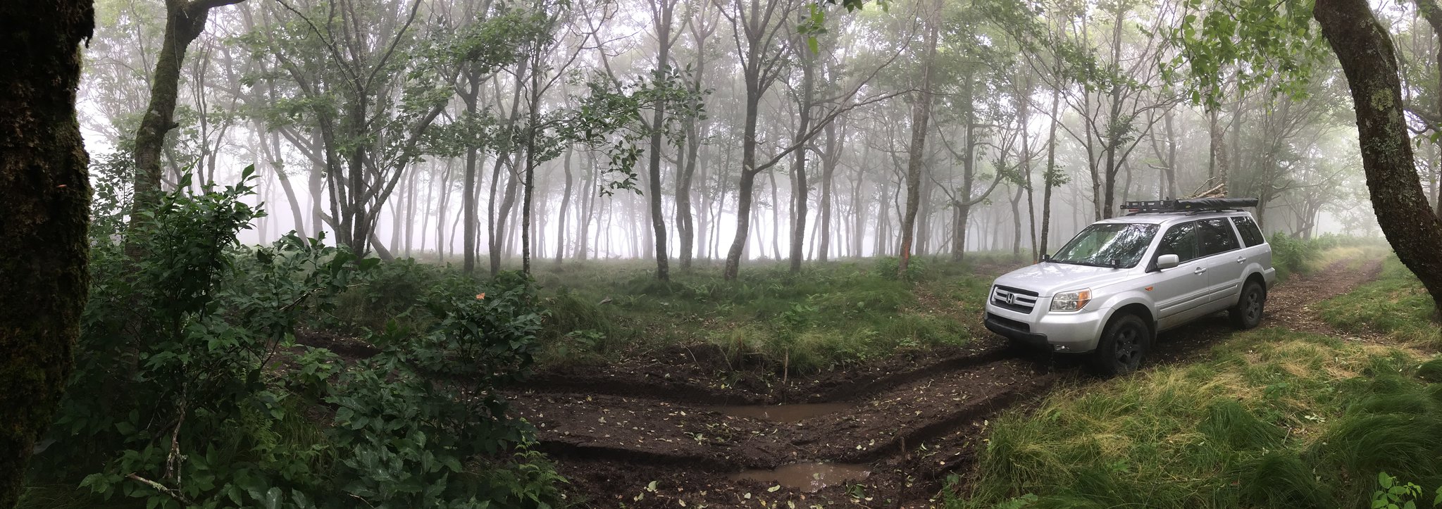

Hello all. I just joined OB as a result of a Google search for skid plates for first generation ('03-'08) Pilots. I didn't really find anything skid-plate related, but the search brought me here, which is good, because I've found a group of guys that are my kind of crazy. :smiley: (I'm tired of the "Piloteers" lecturing about how you shouldn't make any changes to the Pilot aside from the addition of a tree-shaped air freshener!)
It's been almost two months since anyone posted to this thread, so I hope you don't me sticking my nose in. I'm excited to see where the OP's build takes him. I hope to learn from you all, and maybe impart a little of the knowledge I've gained so far from my own work and other Pilot-related forums.
I'm not trying to hijack this into my own build thread, but here's what I've installed since acquiring my Pilot (about six months ago), in case anyone is interested for their own rig:
  • 2" Lift (ReadyLift, 'cuz I got it cheap; the one you find on eBay seems to be every bit as good for way less)
  • New rear springs (3/4" longer than OEM) and new rear coil isolators
  • Items 1 and 2 above yielded total lift of 2" in the front and a whopping 3-1/8" in the rear (these are gains made on a saggy old suspension, mind you)
  • Airlift air bags (Model #60909, because my Pilot is lifted)
  • ATF and PS Fluid coolers
  • Headlight upgrades: HIR (halogen infrared) 9011 high beam headlamp bulbs; H9 65W low beam headlamp bulbs; H9 65W fog lamp bulbs
  • 245/75R16 Wrangler Pro Guard E-range tires
  • Donut spare replacement (boneyard rim; 235/70 GY Wrangler tire [used], because it's all that would fit--inflated--under the Pilot!)
  • Dual NMO antenna mounts (yup...I drilled two huge holes in my roof!)
  • Ham radio (Yaesu FTM-350AR)
  • BT45-HON3 Bluetooth stereo adapter
  • Repairs since acquisition: new radiator; rear main engine seal--man, that was expensive!; new alternator; new plugs; changed all drivetrain fluids; new door checkers (four); about a gazillion interior and dash lights
After the bank account refills, I'm looking at:
  • Front trailer hitch
  • Winch and caddy
  • Wilco Hitchgate of some variety
  • 235/85R16 tires (~31.7" tire)
Before Lift:
After Lift:
Latest excursion:
Again, excited to see where you go Mr. Brooks, and hope I can give something back somewhere along the way. Best of luck to you!
