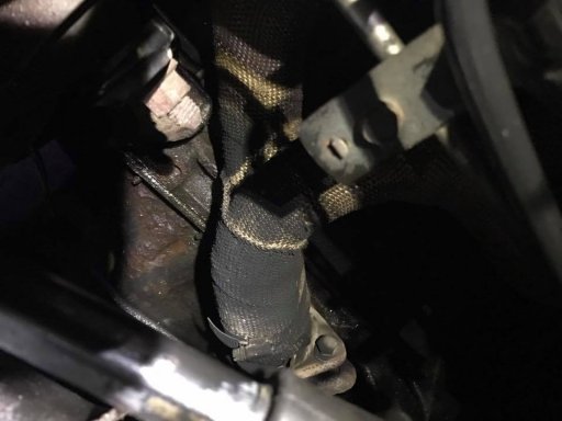

haha ok, that post is hilarious! and yup your kinda confirming my fears. Steering still doesn't feel quite right although it works. I'm concerned there is metal shavings in my box and im going to have to replace that eventually. Although i did replace the high pressure and low pressure return line. as well as flush the system the best i could 5 different times. How quickly did you have to replace the pump and box?I had some power steering issues when I first go my XJ- had to replace pump 4 times until one finally quite screaming at me, also replaced the steering gear box and all hoses. Then 6mo later the PS pump went out AGAIN, luckily warranty covered it. Funny thing was this post on Instagram- I made it and couldn't resist posting on IG and laughing my ass off.
If you do replace the box, look into the Durango box mod. I don't remember the details but supposedly there is a set of years that the durango steering boxes were almost a direct swap for the XJ boxes and they are heavier duty. There was something different about the pitman arms from the XJ to durango boxes tho. I think you have to put an XJ pitman arm on the Durango box for it to work but it bolts right up.After the 3rd pump failed within one week i replaced everything just to get rid of the issue. It worked, until this last pump failed. They flushed it again and put another pump on and all has worked great. I usually would do this work myself but this was covered under warranty.
Yup I had already looked into it! It's exactly what you said. XJ pitman arm on the Durango box. I would also put a steering box brace in as well. Even though I only plan on running 31s, heavier duty steering never hurt anyone! Thanks man!If you do replace the box, look into the Durango box mod. I don't remember the details but supposedly there is a set of years that the durango steering boxes were almost a direct swap for the XJ boxes and they are heavier duty. There was something different about the pitman arms from the XJ to durango boxes tho. I think you have to put an XJ pitman arm on the Durango box for it to work but it bolts right up.
The Durango box is built for thirty ones so it'd be perfect! Plus plans change so who knows!Yup I had already looked into it! It's exactly what you said. XJ pitman arm on the Durango box. I would also put a steering box brace in as well. Even though I only plan on running 31s, heavier duty steering never hurt anyone! Thanks man!
