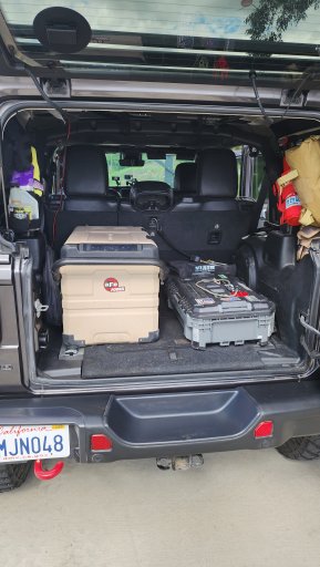

When it came to power for me I just spent some money upfront and went with a bluetti eb150 solar generator, it last forever and worked great across my trip through Colorado and Utah offroading, I used a victron dc to dc charger wired into the truck to charge while I drive and offroad.
