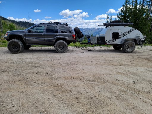

My original offroad teardrop trailer build included 31" with 5x4.5 lug spacing tires trailer tires. I got a lot of comments on the size of the tires. The problem for me is that the Jeep has 35" tires with 5x5.5 lug spacing. It was always a hassle lugging two spares around. I finally swapped out the trailer brakes/hubs to match the 5x5.5" lugs and I am now running 35's on the trailer as well. I designed my trailer with 3500# axles, so it was no big deal to find the matching pattern. I was wondering what size tires everybody is running and what luck you have had with them. How are you handling the spare issue. Do yours match?

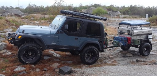

My primary tow rig is a Jeep TJ with the 2.5/five-speed, 4.88 gears, 33" tires (heavy 285/75/16"). Pulling my trailer is a bit of work for my TJ. TJ has a bolt pattern of 5 on 4.5". Current TJ tires are Mickey Thompson Baja Boss AT ("E" rated tire with three ply sidewalls - heavy tire).
My trailer has the same bolt pattern as the TJ, but the tires are an LT235/75/15" tire. I carry a spare for the trailer on the back of the trailer. They are a much lighter (and less expensive!) tire than what the Jeep's running. The axle under the trailer is mounted under the springs, and it rides level. And I've got quite a few more inches of clearance under the trailer's axle (3500lb axle) than I do under the TJ's rear Dana 44 pumpkin. I could put the trailer's spare on the TJ if I had to, but there's not enough clearance on the trailer for me to mount the TJ's spare on the trailer (axle isn't wide enough, and it would be close with fender clearance even if it was).

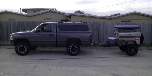

1. 1996 Dodge Ram 1500 4x4. Same size 285/75/16" tires as the TJ (different brand though now - Kuhmo AT 51's). And different bolt pattern (5 on 5.5").

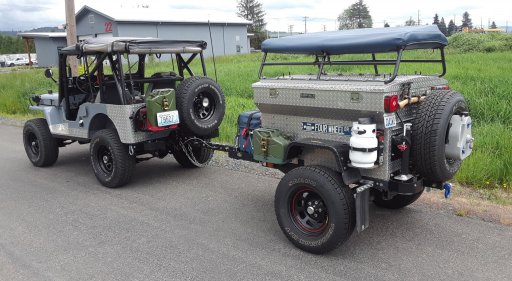

2. 1946 Willys CJ2A. 31x10.5x15" tires. And a different bolt pattern than the trailer (5 on 5.5" for the Willys).
So for me, it is easier on the TJ and Willys to carry a dedicated spare on the trailer so no matter what's pulling it, I've got a matching spare for the trailer. The truck hardly knows the trailer's back there.

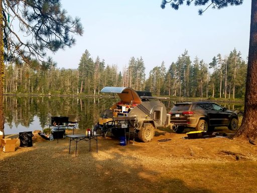

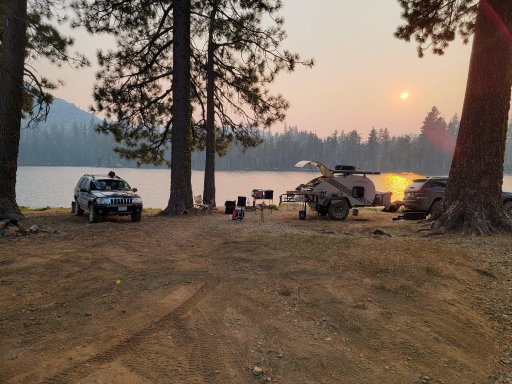

When I had my SoCal Teardrop I set it up with matching wheels/tires (including an additional spare) for both my WJ, then later my WK2 Trailhawk. With the WJ that meant I had 2 spares, or for shorter trips I wouldn't take the one for the trailer, and would just have the 1 on my WJ's tire-swing that would work for either WJ or trailer. The WK2 I didn't have an onboard matching spare (the plan was to get a matching diameter/rollout skinny tire that'd fit in the stock spare location, but sold it before I got there) so having the correct matching spare on the trailer was a must-have so I at least had 1 proper spare. I figured worst-case if I got a 2nd flat I could rotate the miss-matched spare to the trailer to keep all the tires on the Jeep matched (crucial w/ the complicated 4wd system on that thing).
And a couple pics during the 1 trip before my matching WK2 Trailhawk setup arrived for the trailer, this was not ideal since it meant I really didn't have a properly usable spare for the Jeep (the factory spare was about 1" smaller in diameter):
Short version: if it's possible to match 'em, then match 'em.
