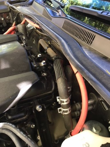

I was originally going to run the hose down the passenger side, however, it would run right by the exhaust the whole way. I ended up running it down the passenger side tail light harness which goes behind the spare tire and meets up with the main harness to the back of the truck that runs down the driver side. This is the same way I ran my wiring harness for all my lights and aux outlets.
Some heat shield was necessary for when the air hose enters the engine compartment.
Front driver wheel well w/ splash guard pulled back
Here's where it enters the engine compartment. Running it along the wire run at the top of the hood (you'll see the CB coax from the last post). Its coiled up and awaiting a Slee bracket, 1lb ARB tank, and CKMA 12 compressor. I'm going to eventually cut the excess and use a barb fitting to get the proper length directly to the outlet of the air tank.
