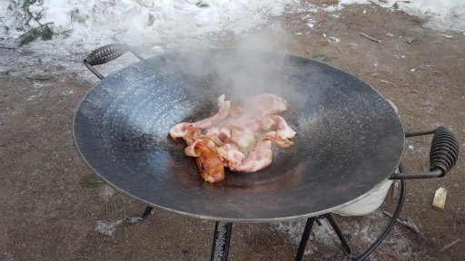

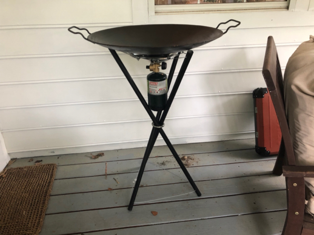

Nice, I think i grabbed the 22” one. Mine has handles. I used 3 pieces of 3/4” EMT and made a tripod and used some cable to lock it to the right tripod diameter. I’m using a Coleman single burner from Walmart to heat it.
Packs up small and I’ve had a blast cooking on it over the weekend. Dinner(steaks, chicken, veggies) Breakfast(pancakes, eggs, cinnamon rolls, bacon). I understand why folks enjoy cooking on these.

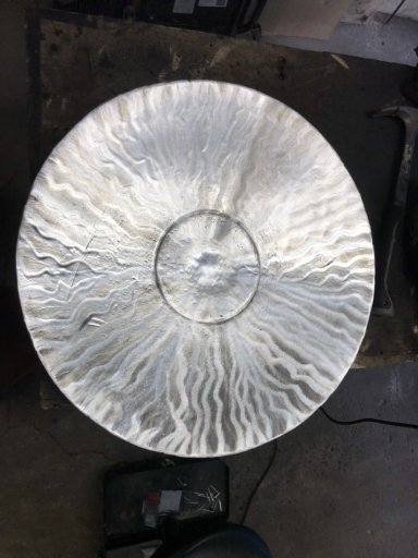

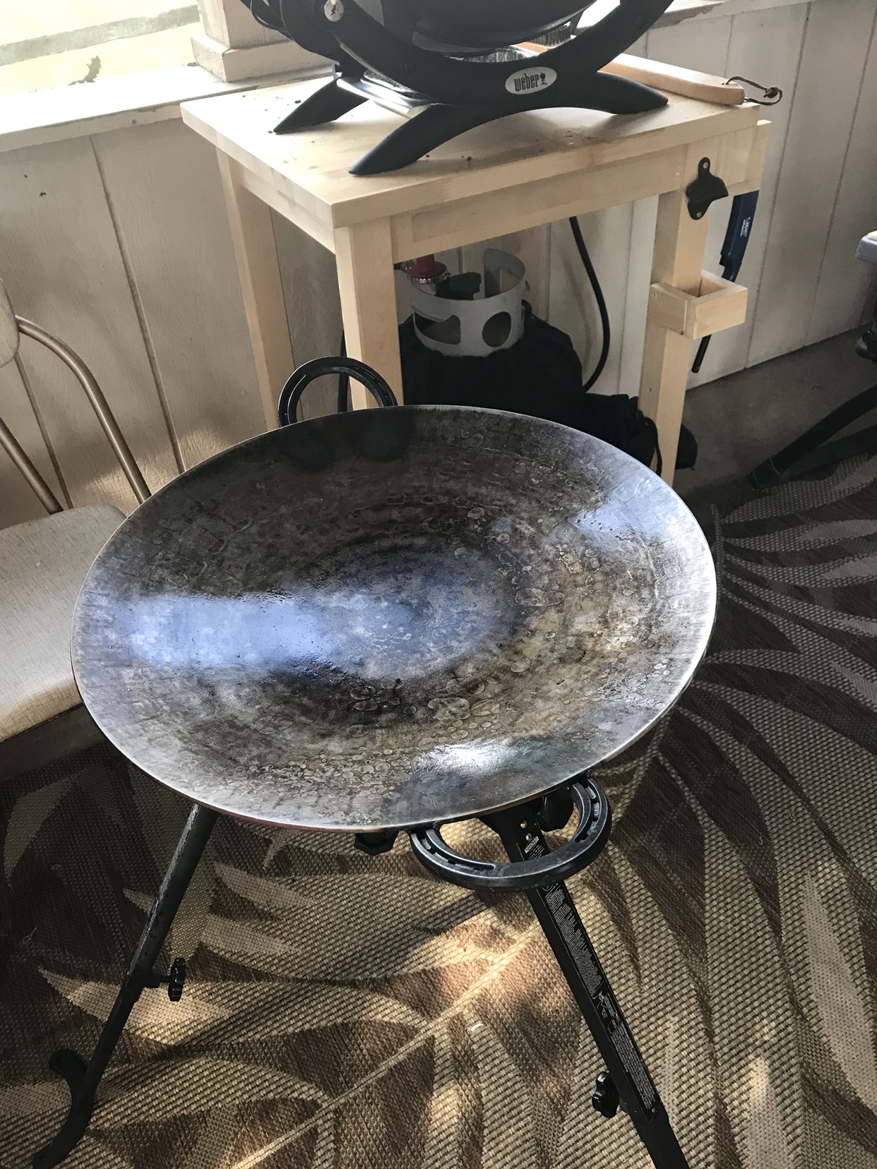

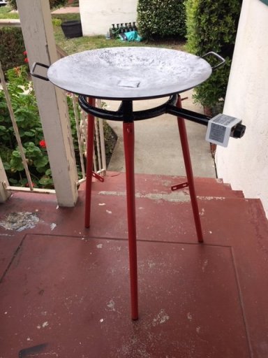

Thread resurrection. I don't have $300 to spend on a Tembo Tusk (nice item for sure) so I found an 18" plow disc from a store owner who has an organic farm in Valley Center, CA. Cleaned it up with distilled vinegar. I paid a mobile welder to patch the hole up and cleaned it up with a grinder and sander. I got the paella burner at a low price. I don't weld and paying someone to weld things on the bottom to hold the propane bottle would have added costs to the project. I'm happy with it as I don't a lot of DIY projects.IMG_3282.JPGIMG_3284.JPG
That looks perfect!!! I’m of the same way of thinking. If you can make it cheaper with the similar end result, way not! Plow disks are a dime a dozen.

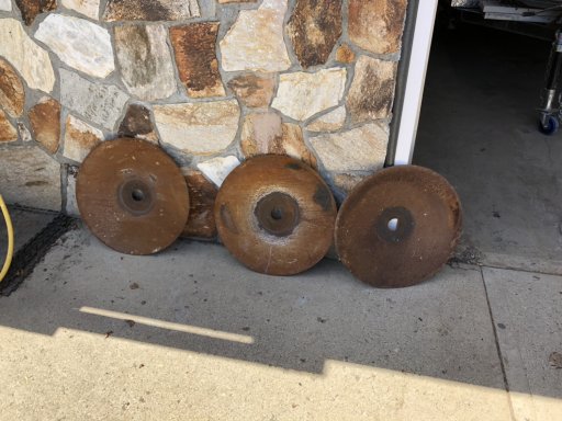

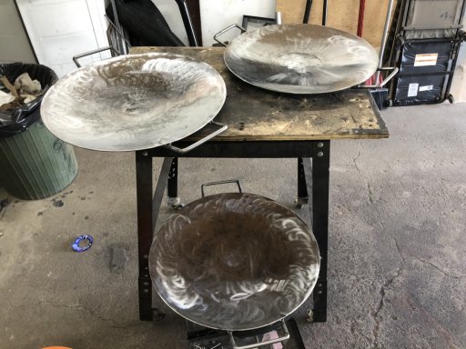

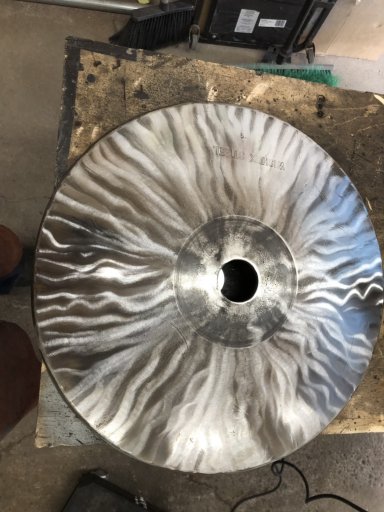

I’ve made a few plow skillets now and they are fun to make!
View attachment 99782View attachment 99783View attachment 99784
Man, you got a good grind on these things. I'd make another one if I could get my hands on a couple of more discs. Here in CA, you can't have them shipped from Tractor Supply so you gotta find a farm here that has them. The one farm owner who I got mine from won't return my emails.
