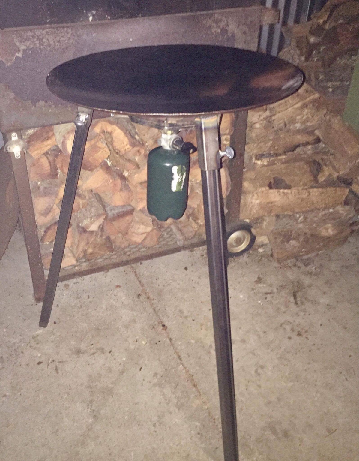

We just made a 18 inch cooker. I picked up a disk at the local farm equipment dealer for $19.00 and a Coleman burner from Amazon used leftover conduit and some scrap steel. We used it the first time this weekend and we think we are going to like it alot. Setup and cleanup is fast and easy.
Funny, I may have just picked up the same disc from the same farming supply store. Any pics of how yours came out. I'm putting mine together now.

I looked and this is the only picture I can find. I took the conduit and welded half inch nuts to the ends and half inch bolts to the disk. Easy on and off and easy adjusting. Used some angle and taped quarter inch thumb screws for the burner. Plug the hole in the disk and season with some bacon and your all set. Hope this helps.
