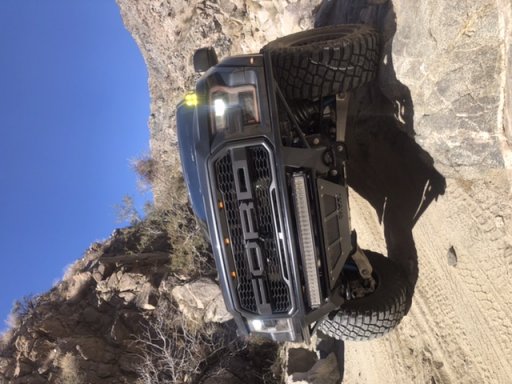

So the truck came back from SVC Off-road and a visit to Deaver Springs as well. Deaver built me a custom leaf spring pack to manage the weight of the overlanding gear and to get a bit more clearance. Then SVC dovetailed the rear fenders to align with the Mojave high clearance bumper and built a custom winch mount. The winch is now in the old spare tire location under the bed. It turned out so well! SVC also installed a 30” Rigid light bar in the front bumper.

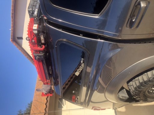

I used the Runner HiLift Mount, awning mount (which worked great with my Yakima Slim Shady), MaxTrax mount, and low profile light bar mounts. I kept my single row 40” GGLighting LED on the front, and I bought a 40” GGLighting RTL (rear tail light bar) for the white rear work lights, amber chase lights and red running lights. I then added two BajaDesign side amber lights all controlled off of the Ford factory up fitter switches.

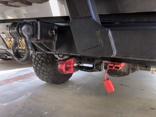

As lockdown continues I am enjoying some good garage time and getting caught up on little projects that have been on the list for a while.

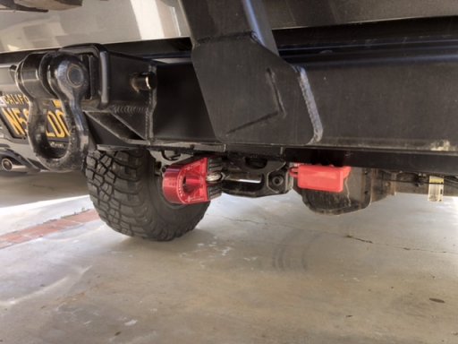

today I got the Anderson connectors mounted to my bumper and tied into my rear winch mounting solution. This will allow me to plug in jumper cables and also my air compressor without opening the hood, just a quick connect at the rear bumper.

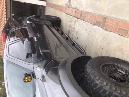

Finally got my rock sliders built for the truck! A local fabricator built them to my spec and design and I am very pleased! Can’t wait to get them out on the trail and test them.
they tuck up nice and tight and are welded to the frame with gusset plates for strength.

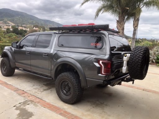

After collecting parts for a while I launched my major reconfiguration of my roof rack system and a few other projects!
I added an additional Slimline 2 rack on the cab of the truck and moved all the recovery gear to the front rack.I then added a FrontRunner RTT to the rear rack. I built all new wiring harnesses for the roof racks that incorporates the rear tail light bar, side work lights and new front light bar.
I also added four 7” Auxbeam round lights on the bumper as well.
