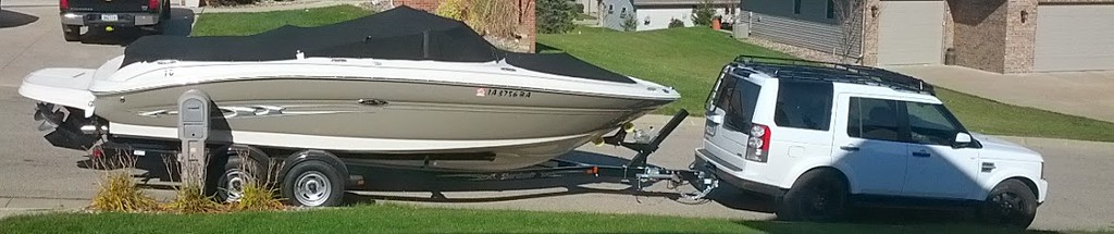

I love LR4. You have the same 5.0 direct injection V8, that's in my Jaguar XF. It's a great engine. I'm sure it handles the weight fine. The 3.6 in my Jeep, starts to struggle as I get close to GVWR.I still struggle with the weight issue. I have avoided adding armor other than sliders for a long time. My old sliders where a bit lighter. I have decided to do bumpers and skids and better sliders. My Land Rover LR4 (with the 5.0L V8) has a spec'd curb weight of 5623 lb, and weighs about 6200lb (taken on a scale) with sliders, roof rack, ladder and me and nothing else in it. It has a GVWR of 7143 and towing cap of 7716. So I should be under GVWR with the bumpers and skids and winch, which will add around 500lb. I think all loaded up with 4 jerry cans and all the camp gear, I can stay under as well. An LR4 is just stinkin heavy to start with... nearly 6k.
It has been impressive as a tow vehicle. It doesn't have much issue towing my 26 foot searay, which I think is between 6000 and 7000 lbs (not exactly sure, +/- 60 gallon fuel tank, water tanks, etc)I love LR4. You have the same 5.0 direct injection V8, that's in my Jaguar XF. It's a great engine. I'm sure it handles the weight fine. The 3.6 in my Jeep, starts to struggle as I get close to GVWR.
