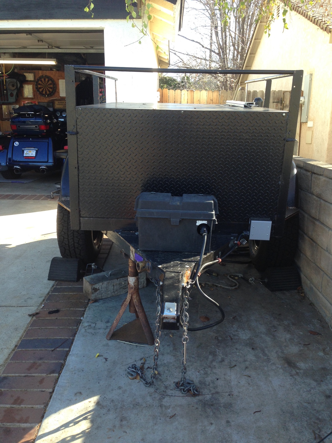

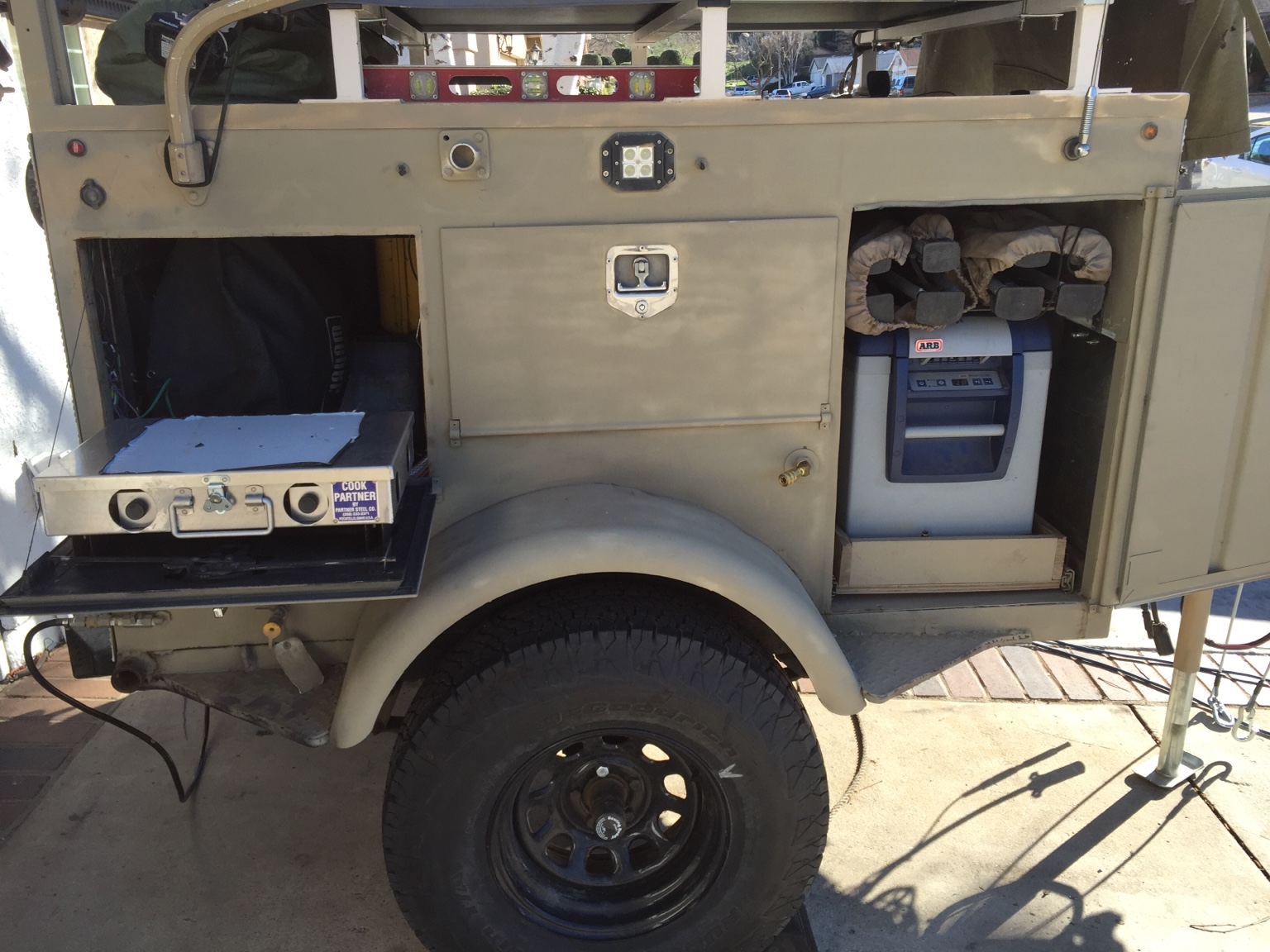

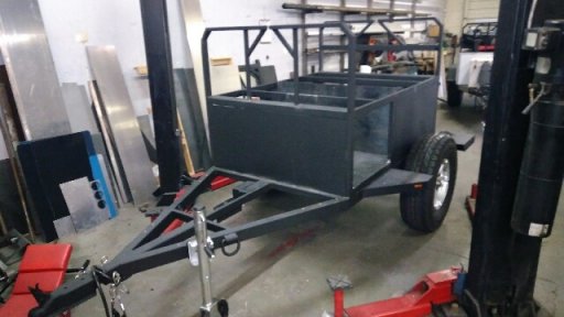

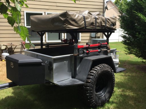

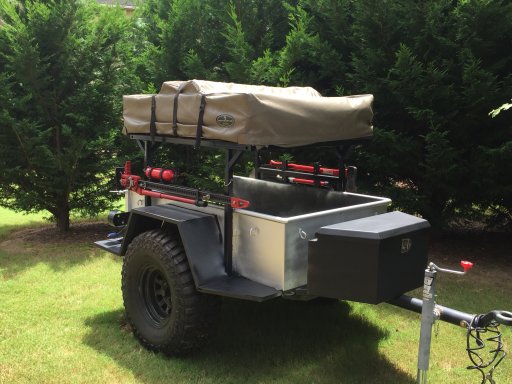

Lease let me say this about that, if you guys are buying your trailer and have the cash, glad for it, if you are building your own rig, keep in mind these little things, your base platform, no wider than your tow vehicle, be cautious of the weight of the rig, TARE the weight of the rig with nothing on board. The axle, here's the key. You do not necessarily need a 3500 pound axle, unless you're hauling elephants, t just adds weight, electric brakes ? Lots of rocks and downhills in the future, nice thing to have. 12 volt power, solar panel@ 100w or more. Stove, The Coleman is a great buy, if you are at altitude, reconsider, propane is regulated and doesn't burn as hot . Look at the high altitude stoves, a bit pricey, but well worth the effort, RTT, we all need then, keep the rack at least 40 inches off the deck (ground) any lower the bears will visit. I've had it happen. Read up on tent specs before purchasing they vary . I've built 4 units for my friends as well as my own, the (Towd) pictured below start to finish, made several mods, pulled it thru the Rubicon trail 6 times with minor scratches only,
The fit and finish of the production trailers is beautiful, however rocks don't care, nor do trees. Use simple material 16 ga, max, 3/16, frame box or channel, you don't need the heaviest dog on the trail to have fun,

Nice Trailer and Jeep!
Question, how do you like the camp chef oven?
Thank you.
I really like the camp chef oven. The oven heats up quickly and cooks evenly. I really like being able to cook biscuits in the morning while camping. The 2 burners on top put out more than enough heat to cook with. I am very pleased with it so far.

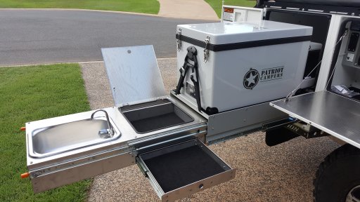

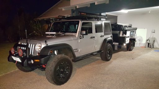

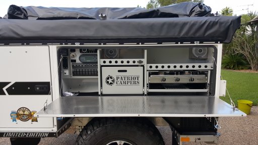

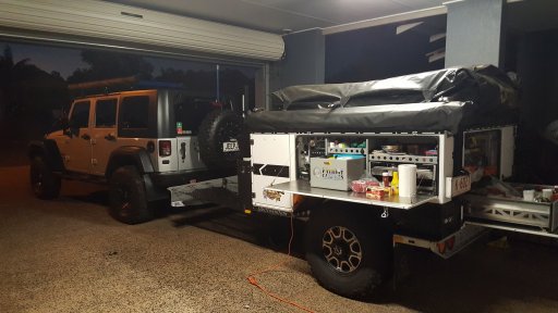

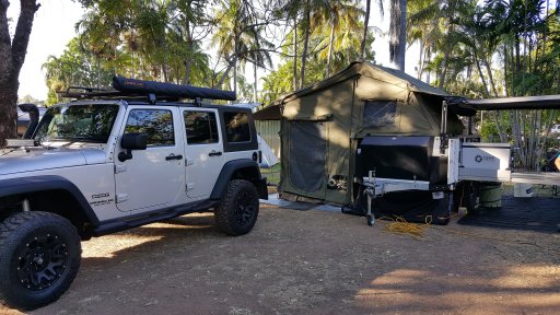

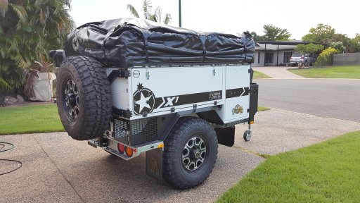

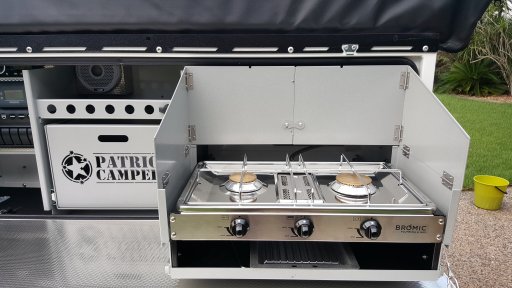

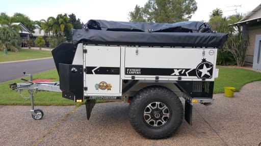

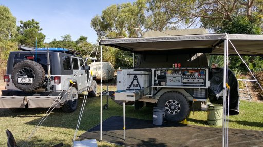

Our Patriot X1 LE (Limited Edition) camper. Absolutely love this camper which has the following additions:
- Additional 60lt water tank totalling 120lt
- Smarttek hot water system with shower
- Redarc Manager 30 state-of-the-art battery management system
- Air suspension to lower and raise each side for leveling and for going off-road
- Weber Baby Q BBQ in front man cave that swivels out
- Front BBQ porch awning
- Fusion sound system with bluetooth built in
- Main tent has additional kids room which we can attach
- 2 x gas/propane cylinder holders
- 60lt Evakool Patriot branded dual zone fridge/freezer
- 2 x Enduro ground mat sets
- Awning wall wind break
- X1 Stone stomper
- Korr 150w folding solar blanket
- 12v and 240v (Aussie voltage) so can run either solar or mains power
If you want to know more about this camper here are the full specs: http://www.patriotcampers.com.au/patriot-x1-off-road-camper-trailer/
They have started to ship to the USA

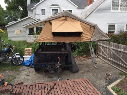

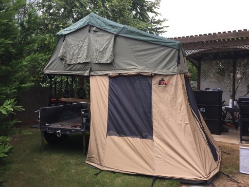

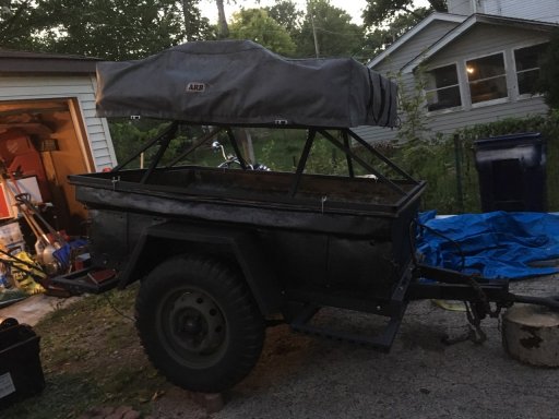

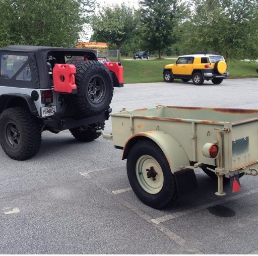

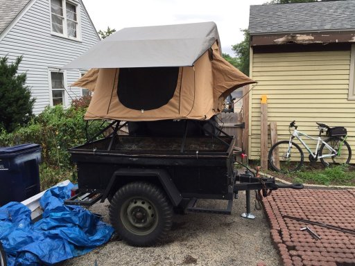

My trailer is a modified Swiss military trailer. It's still a work in progress. Here's how the trailer started and here's the progress we have made up to this point.View attachment 31238View attachment 31242 View attachment 31241 View attachment 31240
do you have the dimensions (L/W/H) (and with the height, the trailer itself, PLUS the height of the floor of the Tepui once it is set up?) When I make mine, I am looking to see how high I need to make legs, boosting the CVT up for the awning around the ladder.
Thanks!
I'll take measurements sometime this week and get back to you
Thanks!
