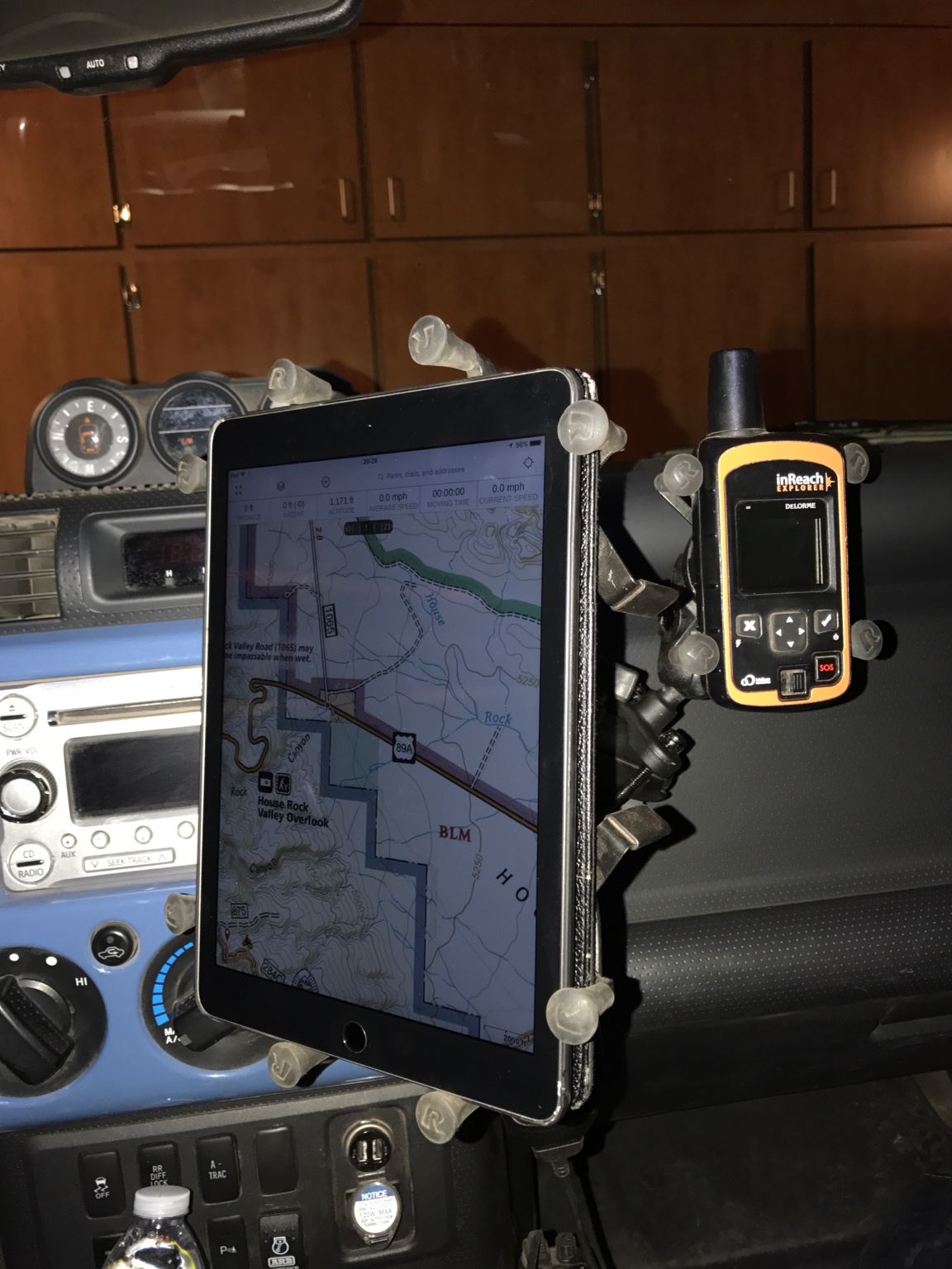

The addiction continues. Tired of my suction mount version coming of on rough trails (forest roads it works fine)
I added a motorcycle mount onto the long arm of my iPad mount. My delorme will go there or when the wife is riding shotgun she can put her phone there while charging. I had to buy the short arm with the large tightening handle vs the round dial version. The ball would not stay in place with the other version.

Lookin' good, Chris! Can't beat a solid mount.

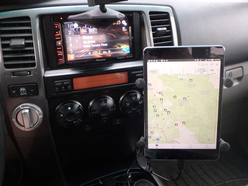

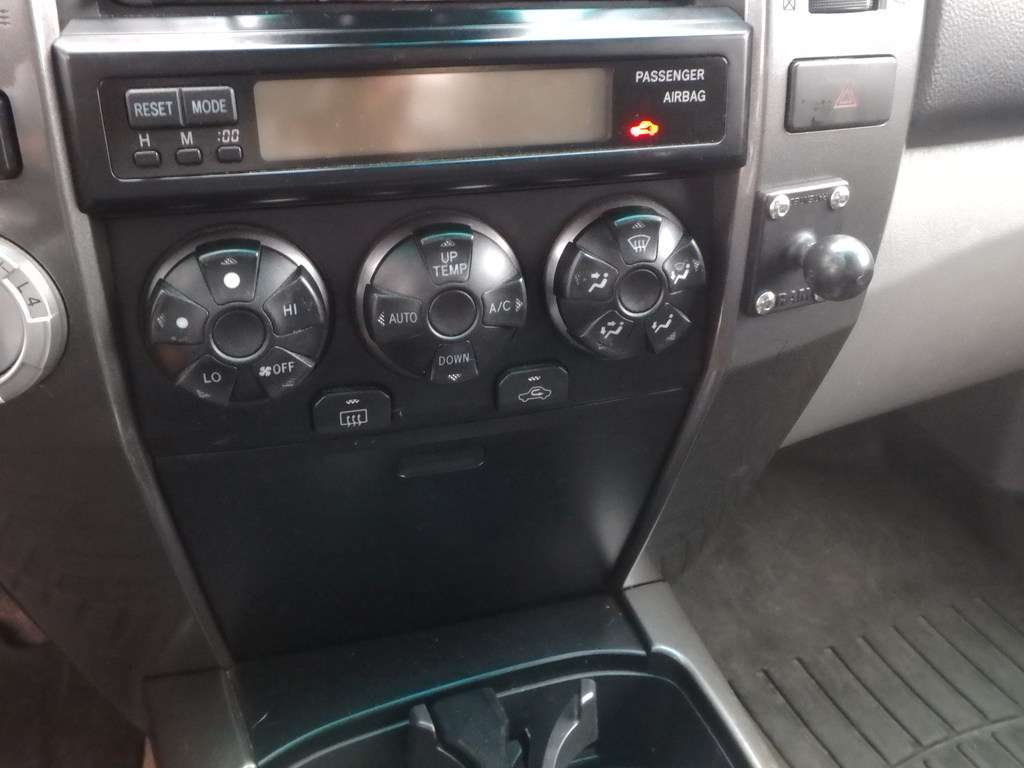

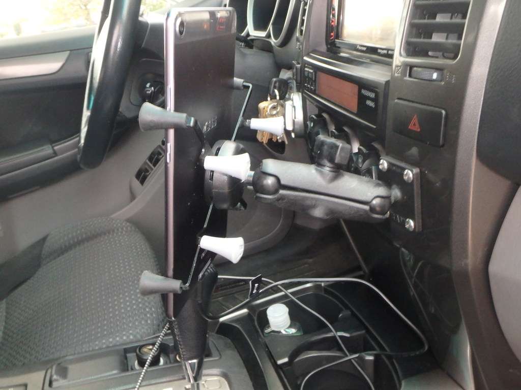

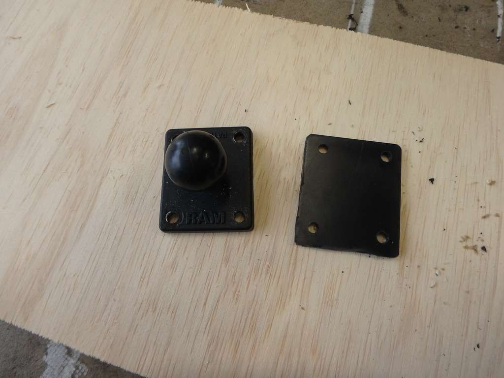

Finally got around to mounting mine up. I used a square ball mount attached to the dash trim piece with a cut piece of abs attached to the back for added support. It's incredibly solid and the tablet hardly moves at all, even going over washboards! Since installing it, I have painted the bolt heads black so it blends in better. Is nice!
I'm running Gaia GPS on the tablet and it works great!
The view from the back:
The mount and the plastic plate I made for added support.

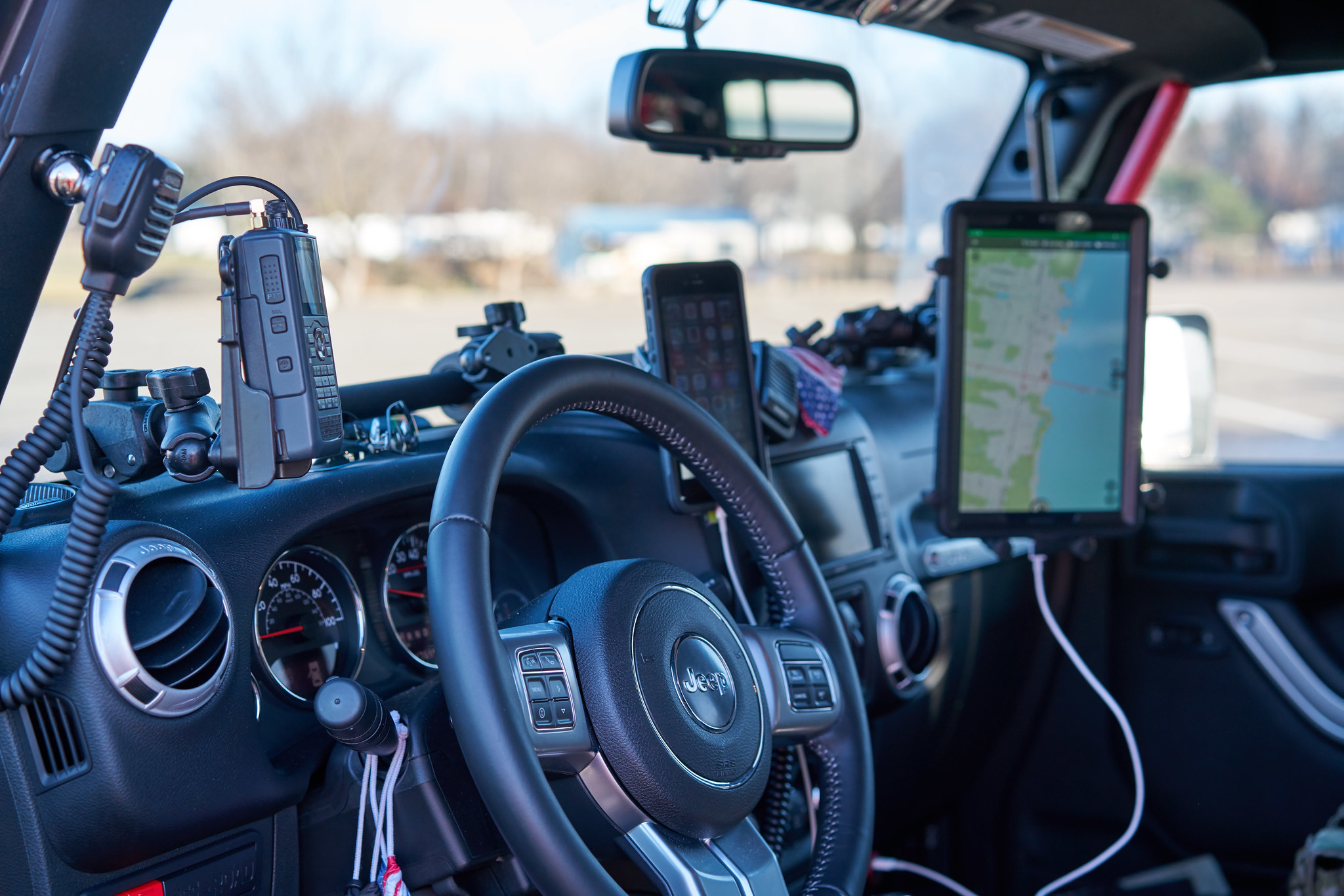

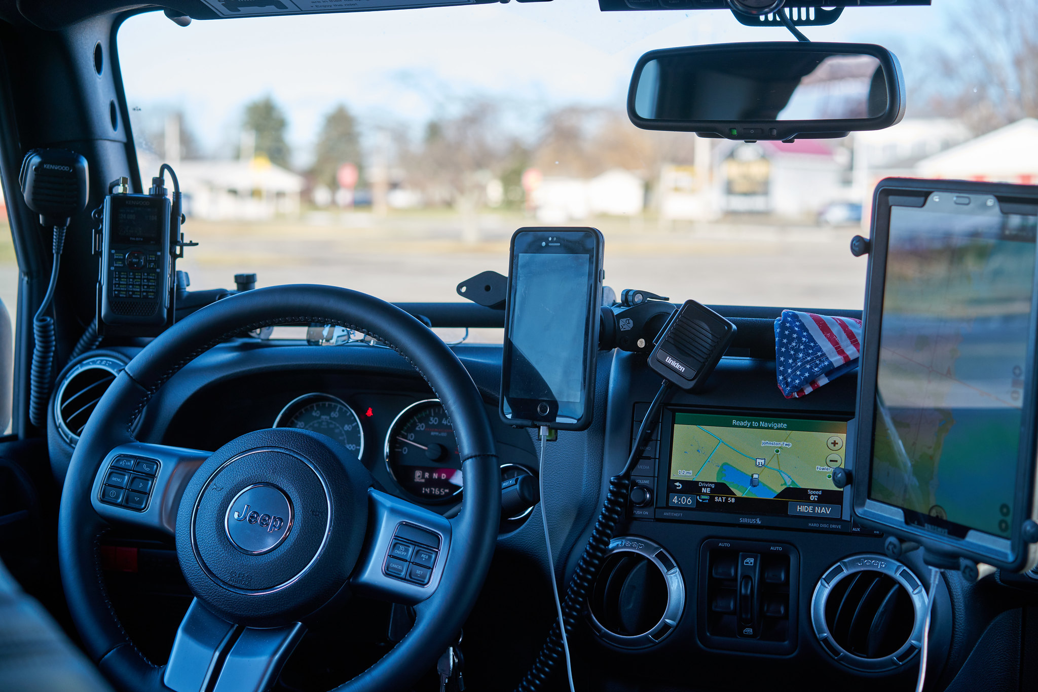

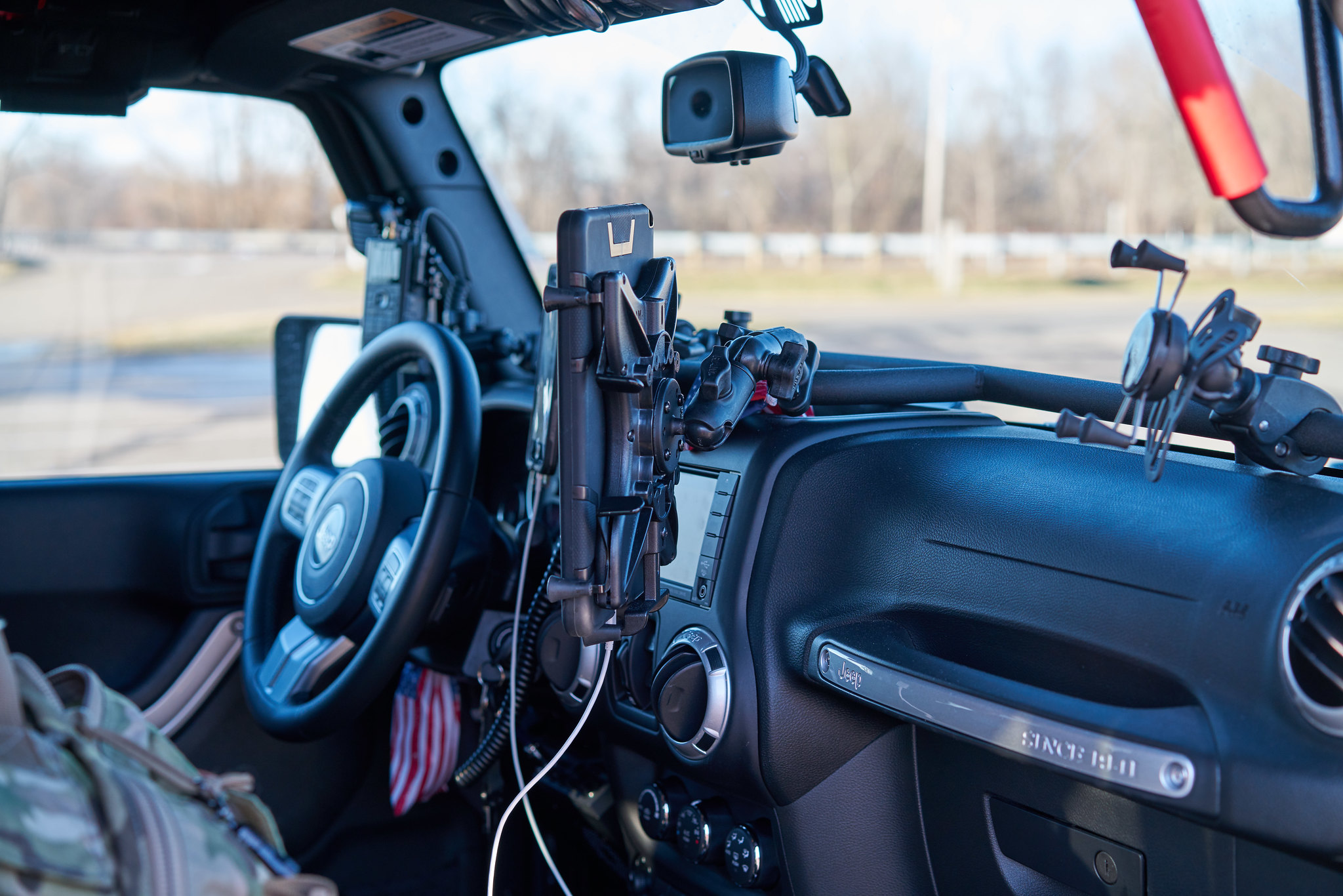

2017 Jeep Rubicon Unlimited Hard Rock with a Vector Offroad JK Dock mounted on the dash and mounted to it is my Kenwood TH-D74A ham radio, Mob Armor phone mount, Samsung Tab A 10.1 tablet, and on the passenger side is a phone holder for my girlfriend.
On highway and paved roads the tablet is pretty rock solid and doesn't move. Off road it does wriggle a bit but I never have to readjust it. Everything else doesn't move at all. So far I am really happy with it.
Installation of the actual bar took about ten minutes and it doesn't move or make any noise.

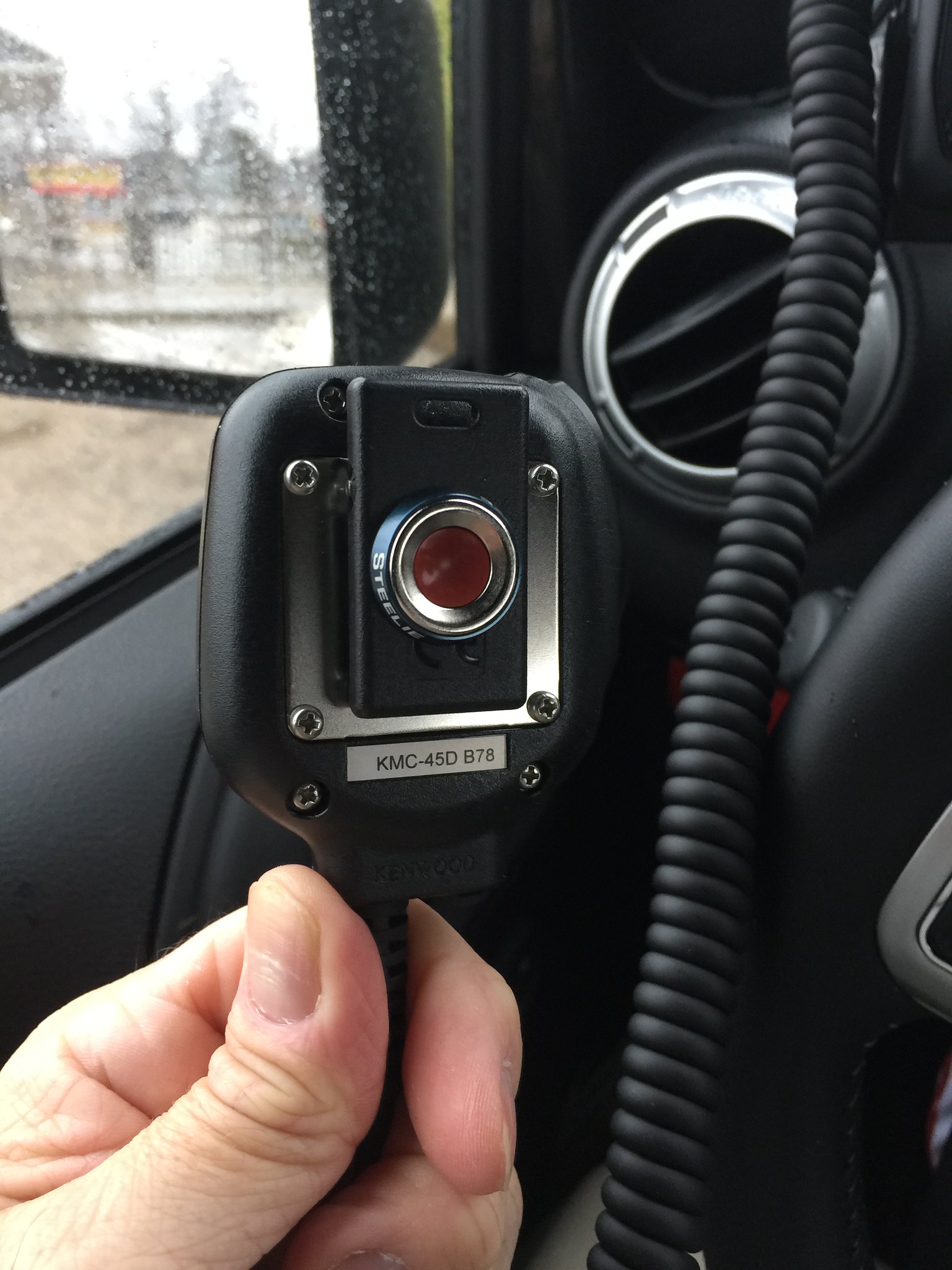

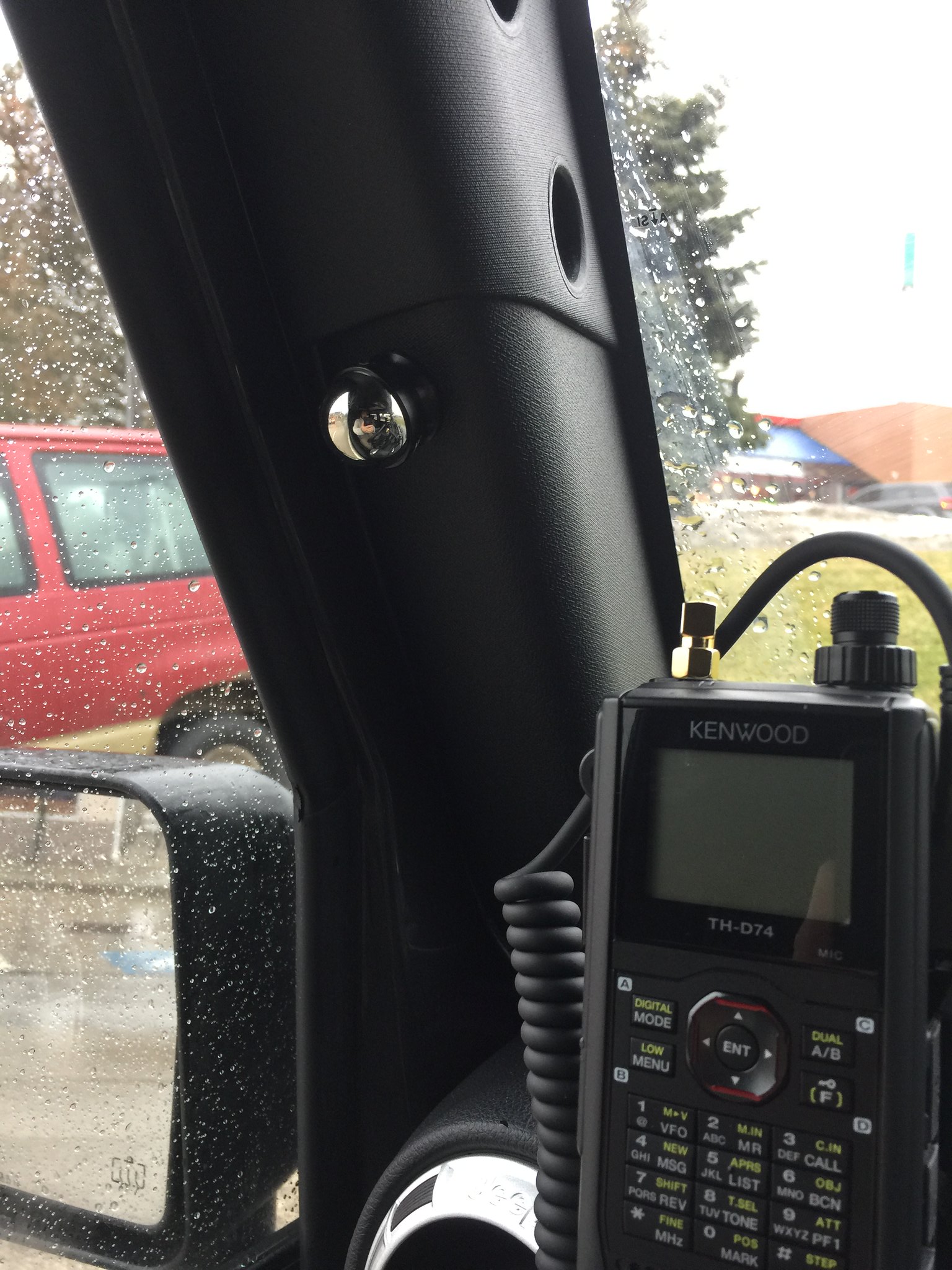

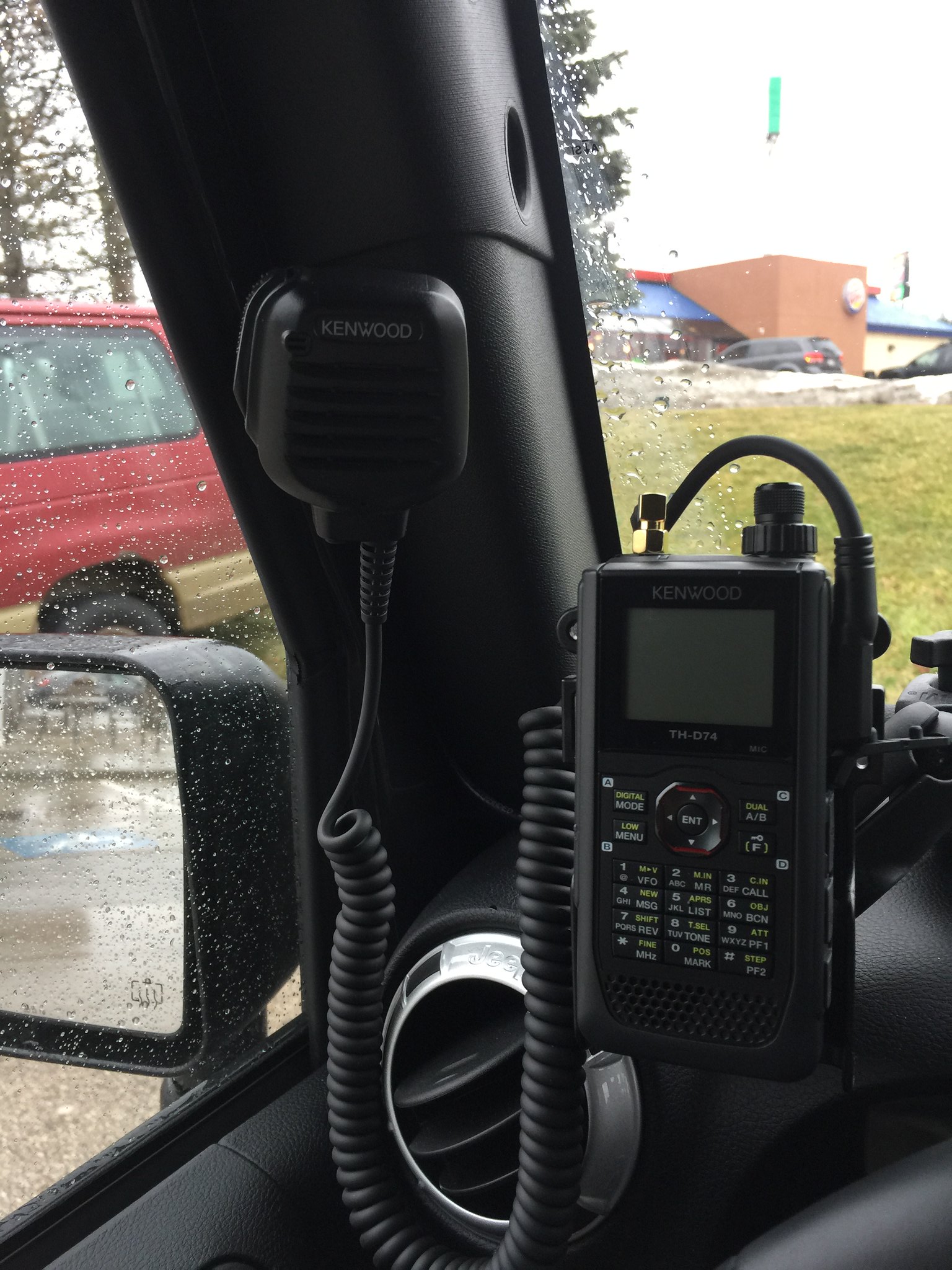

Here is what I did for mounting the ham radio mic on the a-pillar in my Jeep. It is a Nite-ize Steelie Magnetic phone mount.
The steel ball is mounted to the a-pillar with the included adhesive and the actual magnetic mount is on the clip of the mic again with the included adhesive. So far it works great. You don't have to try to hook the mic on a normal mic clip and no drilling holes in your dash either.

HK, thanks for the tip with the mic holder. I have a clip style in my JK that has worked ok over the years, but I like this option so much better. Order just placed for one.

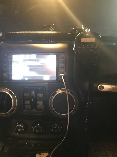

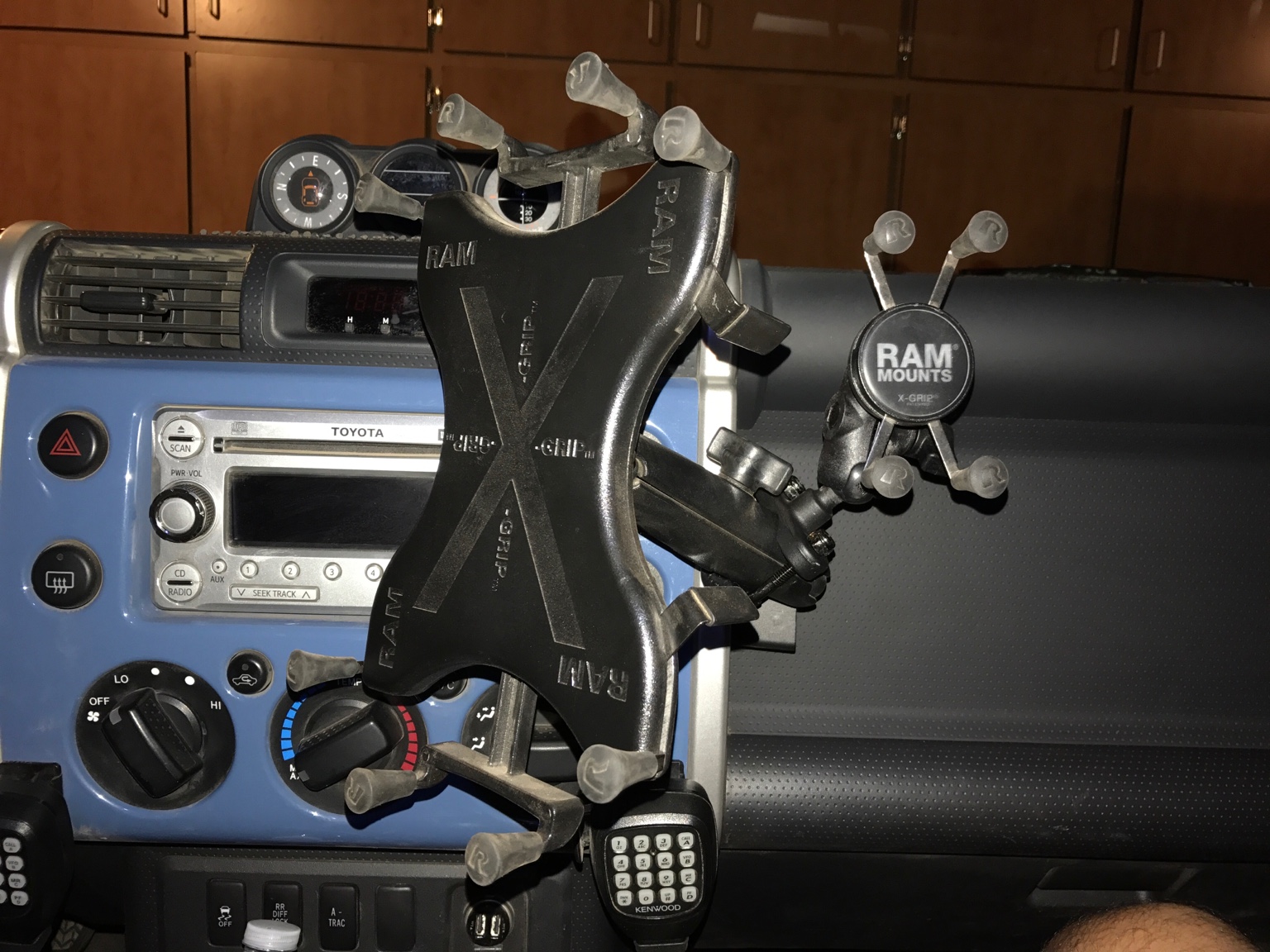

I use a Ram mount. But no holes. They just freak me out. 247FCB29-E504-45F5-A64D-FBBA982AA6E4.png

Steelie mount looks like an awesome solution! Thanks for the tip.
Update! I tried using the Nightize Steelie mount for my Cobra C75WXST handheld, and it's just not strong enough. I haven't taken it off road yet, but the mic falls off even in the city over bumps and street car tracks. To be fair, this is a heavier handheld because the radio is built into the handset, so it may still work for lighter handsets, but in my case it's not the right solution.
I have the steelie mounted on the end of a Ram Mount arm, and i really like the location! I'm going to see if i can get the standard mic clip mounted to that ram mount arm, instead of the steelie.
