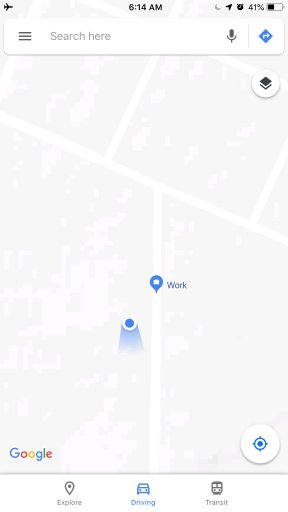

That's not what he asked. He asked if his tablet is cell capable does it have GPS capabilities too. There may be some of off-brand tablets where this isn't true, but 90% of tablets that have a network chip also have GPS on the same chip. The cool part is each can work with the other turned off even though they come combined.
The GPS chip hits the satellites without a care in the world if there's a tower connection, and is just as accurate with a clear view of the sky as any other GPS device. The hitch is if your tablet doesn't have a network capability, it probably doesn't have GPS either. Google it if you don't believe me but this is well documented.
Now, if your device for sure doesn't have a GPS chip at all, then yes, you're out of luck. It's pretty easy to test this though, turn on airplane mode and open a map app. If it can pinpoint you, even if it won't display the map itself, then you have a GPS chip.
