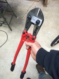

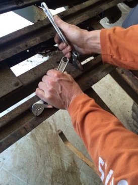

I went out and bought the bolt cutters. I’m glad now that I bought them. I’m Really glad that I bought the bigger ones.
First of all, everything was a rust ball of mess and I didn’t want to spend a month coaxing out all the fasteners. The bolt cutters really sped things up.
Also, the design of the body of this machine uses a lot of threaded inserts. These are are like special shaped nuts designed to be premaritally attached to sheet metal. Its like having fixed nuts already in place wherever you need to attach something with a bolt. A really slick design feature.
Sadly, 75 years later, when all is rusty, the threads tend to seize up, the sheet metal rusts and the little suckers tear out. Now you have what is basically loose rusty rivets. Nearly impossible to get apart.
Snip! Problem solved.

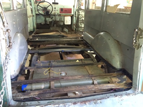

They built these by kinda’ grafting the Carryalls rear body to a pickup cab. The front, where the driver sits, actually has a pickup cab cab floor. This floor has four body mounts. All four had failed. The front two just the wood had rotted away and the metal was still in pretty good shape. The rear two, by the door pillars, had completely rotted away. Also much of the rear of the cab floor was rotten and beginning to fall apart.
Luckily the frame and its mounts looked ok.
The other side..

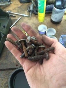

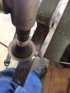

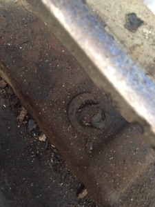

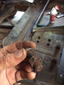

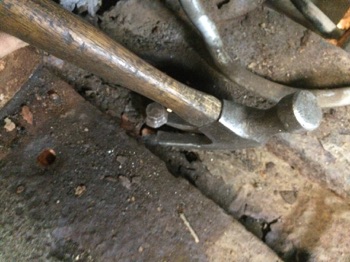

About this time I’d been thinking about the three chopped off screws at the base of the tailgate. It would be really nice to reuse those inserts if at all possible. But how to get the sawn-off screw ends out of them?
I crawled underneath the truck and had a look. Sure enough there was about a quarter of an inch of screw hanging out the bottom.
Using two snake oils and some cleanup work with a die grinder, I was able to run the screw ends out the bottom. Yay! I we can now have the correct screws showing at the tailgate.
Steve, using the same idea to pull the screw ends out of the inserts from the cross member that fell out. He was able to use the torch on this one. That seemed to work really well.
After you get the old rusty screw ends out its best to run a tap through the hole to clean up the threads. We did this to all of them.

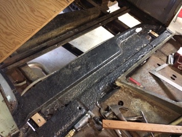

As the body sits now. The lighter colored cross member is a new one I had made up to replace the 2x4 that was in there before.

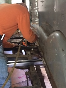

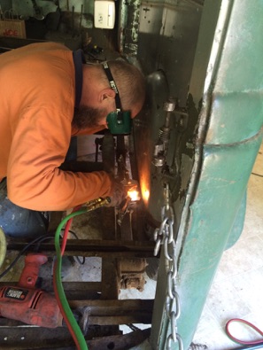

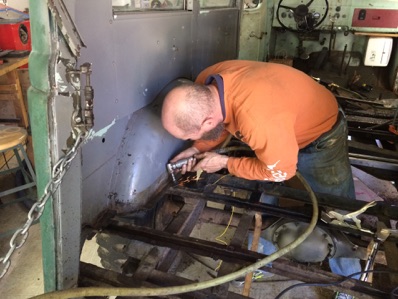

Getting ready to weld the cross members back into the body. We found chunks of metal on the cross members that matched missing bits on the body wall. This we used to “key” the position of the cross member and also the width of the body at this point. I’d been worried about the width because I could pull the body wall out almost a foot at the corner. It was a bit frightening.
We used the first cross member to set the body width for the second cross member. The second one was the new one I had made for this.
And the welding begins.
Well actually..

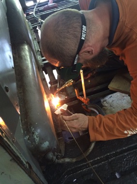

I’m not the best welder, Steve used to be really good, in High-school. Steve wanted to do the welding, I didn’t argue.
He said that these new modern welding rods worked really well and the metal really flowed out nicely. Then I realized I’d handed him a brass rod not a steel one.
Whoops!
So most of the cross members got brazed in instead of welded in.
Clean up with the die grinder.
And more “welding”.

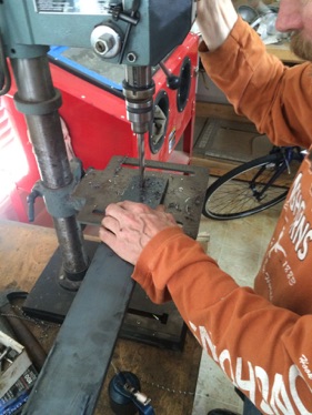

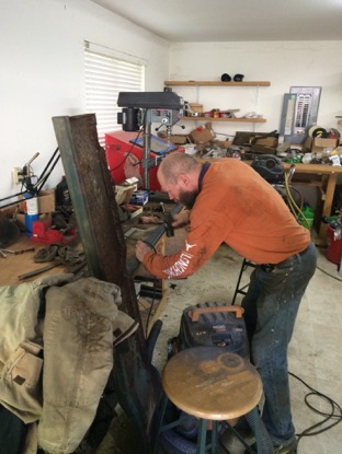

The design for this machine has the wood laying on top of the cab floor right behind the driver’s seat. The original design had a flimsy trim strip going around the front edge of the wood. In this new design, we beef up the trim strip to a custom sized angle made from steel. This locks the wood from the bed down to the cab floor as a structural member.
Here Steve is setting up to drill the mounting holes.

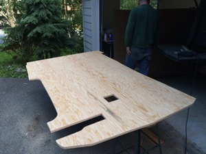

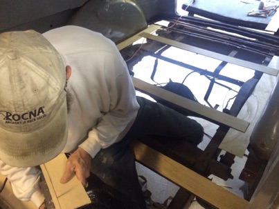

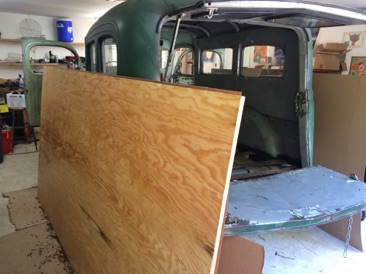

Steve, starting to make the template for the floor.
At this point things have changed a bit in our plan. Getting planks for building this turned out to be harder than we thought. Then I decided plywood would be fine. Seeing that the wood is becoming a structural part of all this, I’d like it to be one monolithic piece. I ordered a 5‘x10’ sheet of 3/4” plywood.
Meanwhile I’m working on replacing all the body mount rubber bits. Seeing that almost nothing is holding the body to the frame, I’d just jack the body up and carefully slip in the rubber pads.
This is one of the rear corners. The taillight is a dead giveaway. The rear corners were two of the three that actually had bolts in them. Not doing a lot, but there.
Jacking up the body to slip in more rubber pads. This it taken laying on the ground under the truck looking up past the frame rail.

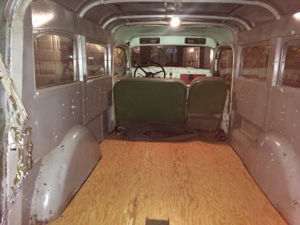

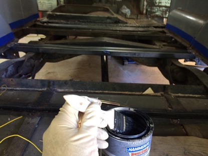

After the floor template was complete, Steve had me paint the perimeter with Hammerite to stop the rust under the wood. I wonder if this is just more snake oil, but I complied.
I’ve also been giving the plywood a coat of varnish. Really low quality sheet I might add. I didn’t see it until I unwrapped it at home. But time is rolling on, so it’ll have to do.

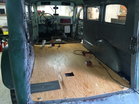

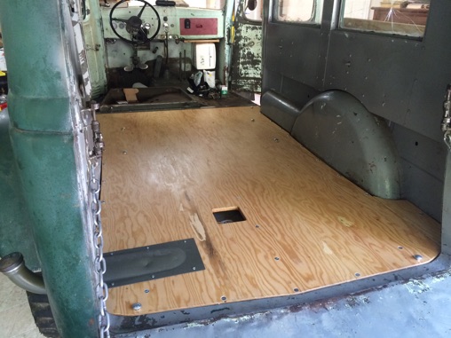

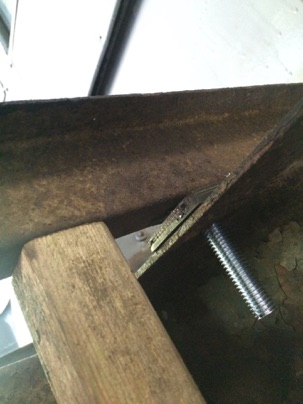

Ok, steel beam is in, body mounts at least have their pads, cross members are welded back in, Hammerite is painted on..

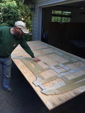

Steve, laying out the template on the plywood sheet.
Cutting begins.
And pretty quickly its finished. Notice the fender cutout in the left side but none on the right side? We found that there was no way we could get the full sheet in or out of the truck. So in the end we had to chop off the rear right corner. But the wood will still give the truck plenty of strength.
First test fit. I went under the truck with a pencil and marked where all the known holes were. And Steve, better more accurate craftsman than I, drilled them all out.
Once all the holes were at least pilot drilled, if not fully drilled. I spent a day getting as much of the screws and bolts aligned and installed as possible.

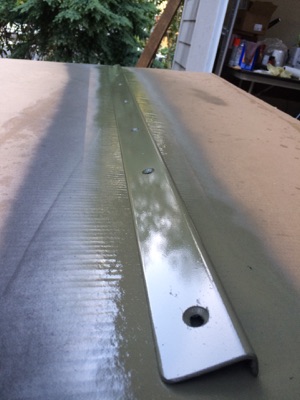

Painting the forward steel angle.
Artsy shot of test fitting the steel angle.
Everything your seeing now is just test fitting. Steve and I have not yet ironed out how the steel beam cab mounting is going to be completed. We go around and around about how it should be done. It spans under the plywood between the two bolt heads just aft of the steel angle.

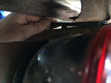

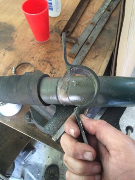

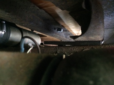

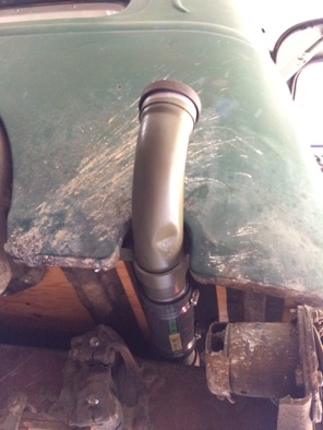

You are laying under the truck looking up at the fuel filler pipe. Notice the left (rear) end mounting hole comes nowhere near the hole in the body? This has been an issue since I got this machine. Seeing that much of this was missing before, I just ignored it and left it somewhat floppy.
Time to do something about it.

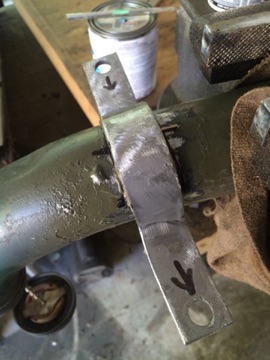

Not wanting to make this into yet a bigger project, I tried to heat it up and just bend the tab over some. It was working, sort of. But really it needed.. And of course I broke it.
Why do I even try? I can never get a quick fix to work.

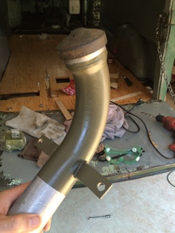

Cleaning up the mess.
All cleaned and ready to go. There was brass, copper and solder on there.
Starting my solder job.
About the fourth re-solder/adjustment. Its almost embarrassing how well this cleaned up in the end, knowing how many horrible things I did to it, trying to get it to fit properly.
Final cleanup and sand blasting.
Paint.
Installed. Finally its where it should be and bolted in correctly.

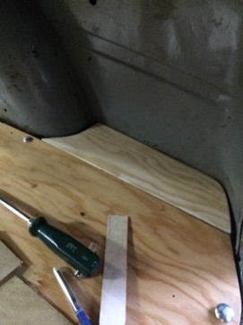

Using what I learned watching Steve, I was able to make and install the filler piece for the cut off corner.
NOTE: The grain matches up perfectly. This was a complete accident. I cut this out of whatever I found on the garage floor. Installed it then noticed.

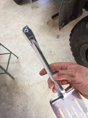

See that nut? I couldn’t get my fingers in there to get it started. So, I used..
Magnet on spatula handle.
Even so it wan’t easy! When imagining this approach, I never thought about the fact that I was going to try to shove a magnet on a stick into a steel lined cavern. It tries to stick to everything!

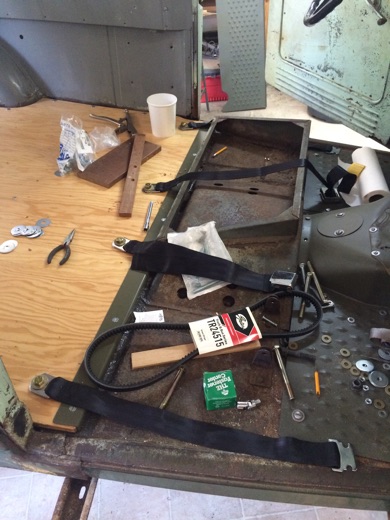

Finally, all the bolts, screws and hardware is test fitted.
Five minutes later, Steve shows up. Time to take it all apart and deal with the design of the steel bar.
I’d spent a bunch of time bolting things together thinking about how I wanted to do it. Julie caught Steve and I discussing it.
I know it looks staged, I swear it wasn’t.

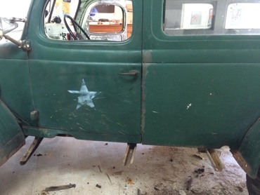

Final plan. Cut out the rotted ends. Measure the height difference between the original end depth and the depth of the mid channel where the bar will lay. Add wood shims of that height on top of rubber pads to the tops of the frame mounts. Next is the bar itself with holes drilled through it for the seat belt mounting bolts. Remember this was all about seat belts? Measure the depth of the channel minus the height of the bar. Make four blocks of that height with 1/2” holes for seatbelt mounting bolts. Drop those in place and reinstall the floor. This, in theory, locks the cab back to the original level that it was from the factory. With the the combination of the steel angle and seatbelt bolts sandwiching everything together.
Seatbelts..
Fender washers holding all the weakened metal together.
Brand new running board.
All done!! Well nearly. Still need to add the gas gauge sender cover. And I should pick up my jacket before snapping the picture as well..

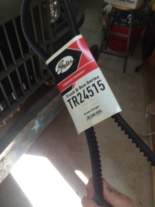

And install that fan belt..

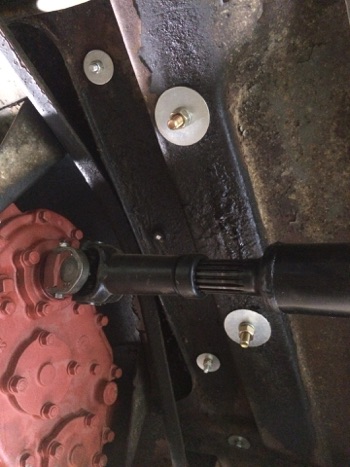

It is a lot nicer in that respect. I still have an issue with something in the driveline though. Sounds like a U-Joint failing and I can hear it thump thump thump down as I pull in to stop. I'm sitting at home today waiting for the FedEx truck to bring my shiny new driveshaft. I'm thinking this should fix the issue because I can feel that the slip joint is shot on the one I have.
Oh but the seatbelts -really- helped with the ride. Not shooting into the ceiling on every little bump is a HUGE improvement!

First order of business was to replace the driveshaft, again. For some reason, the driveshaft I had built out of what was supposed to be a NOS one, wore out. There is a slip joint that you can see at the near end. This joint wore out. When that happens the driveshaft wobbles and goes out of balance.
Vintage Power Wagon had a NOS one in stock for this machine. So I ordered it with new U-Joints installed. When it finally arrived, the U-joints were almost an eighth of an inch too wide. I was furious! All that work on the body and floor. Now I couldn’t drive the truck because my driveshaft was shot and they sent the wrong one!
Wondering if there were different sizes of these things, I posted online about how it didn’t fit. One guy asked if I’d tried squeezing the cups in with a C-clamp. Another said that no.. They are all the same size.. I went to bed.
Next morning I measured the two driveshafts and.. They were the same. Only the cups on the u-joints were different? So I put a big ‘ol C-clamp on them and gave it a good squeeze. Now the cups were the same. Sigh.. I’ve been stupid again. The new driveshaft popped right in. Live and learn. I went back and posted an apology to VPN. Yes, it was the right driveshaft. And yes, you need to use a C-clamp on them.
