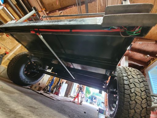

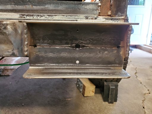

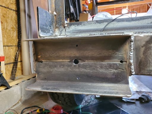

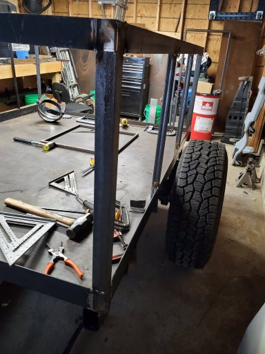

Took a little more time than expected but tail light brackets are actually welded on and tail lights wired. I know my weld jobs are horrible but I am new to this all and still learning a lot. I was having trouble with porosity but other than that I'm slowly getting there.
View attachment 155417View attachment 155418View attachment 155419View attachment 155420

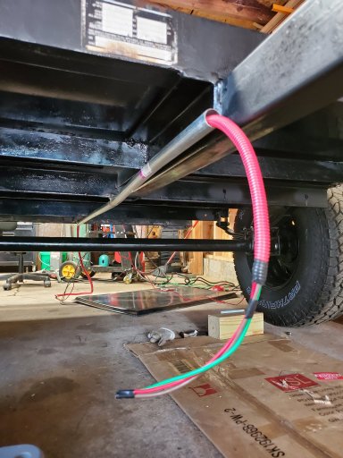

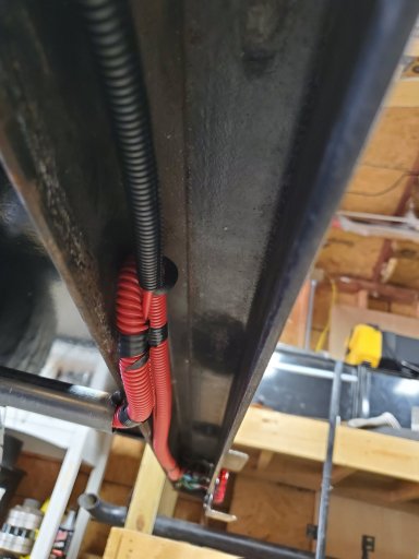

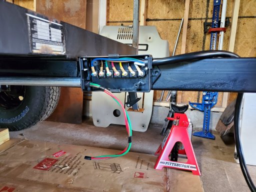

For the lights I tacked ¾" conduit down the middle of the and fed the wires through the conduit in a loom and just crimped all the connectors. I will eventually redo all the connectors and run the wires a little cleaner but for now this work and the lights work.
I did run into one issue. I bolted the box on the trailer. Ran wires from the box to the lights. I was able to get them to work but if you shook the trailer both lights would flicker and want to go out. I know nothing about how trailers wiring works but assume it grounds to the ball. Once I removed the trailer from the truck the lights wouldn't work. I ended up grounding the box to the frame which fixed the issue. Sorry for the mess of wires but just trial and error for me.
View attachment 155424View attachment 155423View attachment 155429View attachment 155425View attachment 155426View attachment 155432View attachment 155438
Took it for a test drive and check some clearance. View attachment 155433View attachment 155434View attachment 155435View attachment 155436

Your trailer is really taking shape and looking great!
I think you might be inspiring me to do something similar and look forward to seeing the end result...
Thanks for sharing!
Thanks man. I'm really just winging it. Trying to figure everything out as I go.
