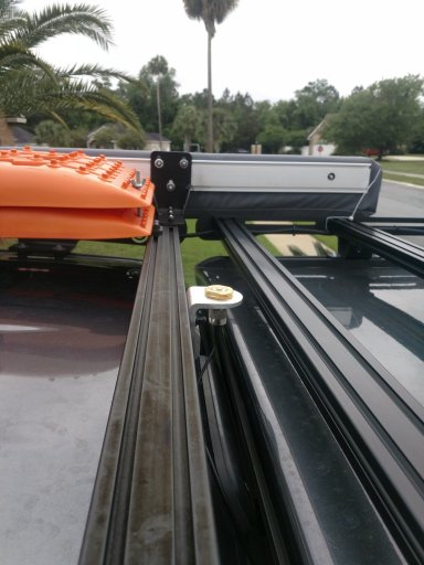

Just installed my MXT400. I'm a fan. I just wanted to know if anyone had a suggestion for an antenna that I can keep mounted but still enter my garage with. I'd like to keep the antenna on. I know the 6db it came with will snap if I pull in with it.
Antenna is mounted in the middle of my roof rack. Thank you!View attachment 147763
There are many NMO mounts on Amazon that fold over. They come with the cable. You can use the 6dB antenna from Midland or any other NMO antenna meant for a Gmrs radio. That’s what I will eventually install. If I find one that works with my roof rack I will share what I bought.
Motorized fold over roof/luggage rack mount for use with non-ground plane dependent antennas (i.e. 1/2 wave, though I am sure a braided ground strap could be fastened): Diamond Antenna K9000LRMO
RhinoRack has a pretty nice looking manual fold over mount as well: #43196 - Folding Aerial Bracket | Rhino-Rack

I have the base of the antenna mounted this way. I'm still learning about the different requirements.
Would I need a ground plate for the phantom?
Downs
Hunt County Texas
Joshua
Downs
20468
KK6RBI / WQYH678
USMC 03-16, FIRE/EMS
The phantom antenna, a 1/4 wave, or a 1/2 wave antenna would work fine.
See the antennas Downs posted above or the Tram 1181 like I use.
1/2 wave or the TRAM 1181 wont' clear his 10 inch limit with his roof mounted NMO. 1/2 wave is about 12 inches and the 1181 is 18 or 19 inches. He'll have to go with the 1/4wave or phantom.
The Phantom looks like it will work fine in your application. The Truck roof makes a good ground plane. The middle of the truck roof would be perfect but everything is a compromise.

Thank you all. When I'm in the field or doing our yearly hurricane evacuation I can easily put the taller one on so that's great.
Do you guys mind explaining the difference between the 1/4 wave and the phantom?
Just overall height. Instead of being a whip antenna like the 1/4 wave I posted the Phantom is a can with the antenna wrapped up inside it. It's how you'are able to get a shorter antenna and still have it be resonant. CB antennas typically do something very similar. If you look at something like a firestick antenna they take a resonant length of wire and wrap it around a fiberglass rod to make a resonant antenna that's still short enough to be useable.

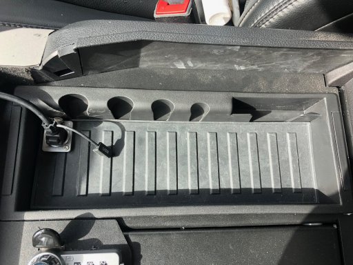

After installing the MXT275 in my center arm console, I had to make a modification so that I can still use the coin tray with my F-150. I got the idea from Midland's blog (here good write up for 5th gen 4Runner owners who want to hide their's in the glove compartment). I bought a ethernet connector mount and drilled a hole into the tray. The screws weren't long enough to go through, but for now the fit seems pretty tight and I don't think it will budge but the first off road test will tell. Added a 3' ethernet cable between the connector and the base unit, and now all I need to do is open up the armrest and connect the mic. Once I close the arm rest, the cord fits perfectly in the factory spot and the install looks really clean. When not in use, I have the mic in the glovebox.

Oh okay. So Is it a matter of looks at this point? Seems like the 6 inch is about $13 new and the the Phantom is $25
Is there anything that would put one over the other? I don't mind spending the extra $12 if there's a point to it. If it's just the visual style I'd rather put the $12 in the tank. :)
I'm using the Midland mount on my Prinsu rails. They're aluminum.
You'll probably get SLIGHTLY better performance out of the 6 inch whip but it'll probably be imperceptible in real world use. The Phantom should take tree limbs better as the little whip antenna will probably take a bend if it get's whacked hard enough.

Thanks everyone! I really appreciate it. I went with the 6 inch because with the awning and Plano case I should have just enough coverage.

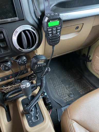

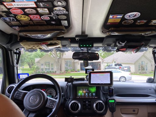

I installed a Midland MXT 275 with the Midland 32” 6db antenna today in my Jeep. Upon testing, I was able to reach @Mrprotaganist about 7.5 miles away. Pretty impressed out of the gate and look forward to trail testing soon. A few pics for reference.

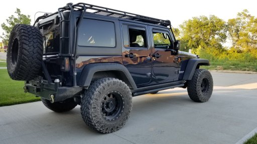

I am looking to pick up the MXT275 for the Jeep JKU. I was also looking at picking up Midlands 32" 6DB whip antenna.
I am curious what the impact of mounting the antenna on the spare tire carrier of the Jeep would be to the signal? Also if I swapped the antenna out to one of their ghost antennas would the signal be crap being on the spare tire carrier blocked by the hard top on the Jeep?
Attached is my CB antenna but I am looking at doing the same setup for my GMRS setup.
The 6DB whip will mostly be above the top, but the ghost antenna would not.

I can only speak from my limited experience, but I have the MXT275 with the 6DB antenna installed in my JK. Antenna is placed via a hood mount as my CB antenna is in the same place as yours. Being in the lower placement, @Mrprotaganist and I could speak over 7 miles away in the city. I would gather that the ghost antenna would work well, but not as well as the 6DB. I am keeping the CB antenna in place for now as I have different groups I run with and some are still using CB. I think for most trail runs, you would be more than fine with the ghost. I attached a quick pic for reference. UNADJUSTEDNONRAW_thumb_30b8.jpg

I considered putting the GMRS antenna where you have yours. But I run limb risers and it would be bouncing off of those all day.
