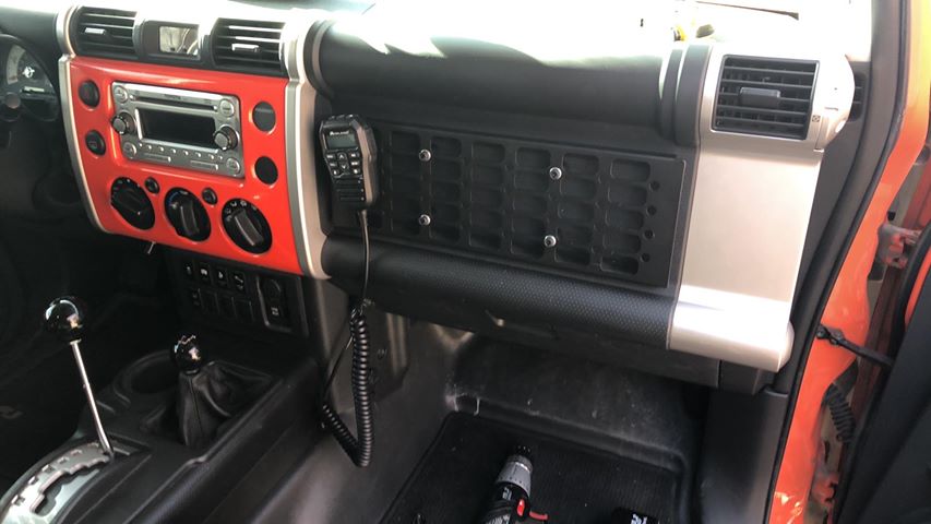

So I was able to install an MXT275 in my vehicle a couple of weeks ago. So far I'm pretty happy with it. Did a write-up with a few pictures on the FJ forum (link below).
I approached the question of what communication method to select with two things in mind. The first was what capability do I really need? The second is what will I use it for?
Suffice it to say, GMRS meets my need right now. When I get a chance to do more frequent trips I'll look at upgrading my capability. Even if I do eventually expand, I'll likely still keep a GMRS capability if for no other reason that the ability to communicate with various handhelds - whether in a recovery situation or just maintaining contact while away from a campsite (fishing, hiking, etc).

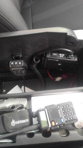

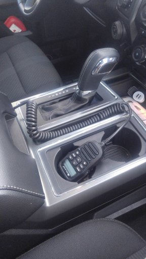

I got a new ride and decided to not go "full radio guy" this time (last truck had HAM & CB radios). The only mobile radio I installed was a MXT275. For 2m/75cm I'm going to just use my handheld & call it good.
I installed the MXT last week. It works GREAT. We have 3 repeaters in my area which is pretty nice.
GMRS is the way to go in my area.
I have used my GMRS radio more in the last week than I ever used my mobile HAM radio in the year it was installed. Apparently HAM is pretty dead in my area.

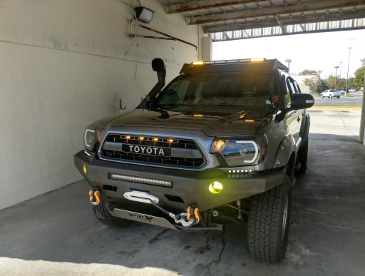

Just installed my MXT400. I'm a fan. I just wanted to know if anyone had a suggestion for an antenna that I can keep mounted but still enter my garage with. I'd like to keep the antenna on. I know the 6db it came with will snap if I pull in with it.
Antenna is mounted in the middle of my roof rack. Thank you!Tacoma_Front_Clean_Nov2019.jpg

@13XSPX what kind of clearance do you have between the top of the vehicle and the opening to the garage?
Need this info. The shortest you will be able to go will be either a Phantom type or a 1/4 wave.
3.5 inches tall. DOn't let the looks fool you these still perform really well as long as you have a ground plane for it. This is pretty much as short as you are going to be able to get.
This little guy is one of my favorite antennas for trail use. Only about 6 inches long and still gives excellent performance. Look up about 2 or 3 posts to my post about antenna gain. in many cases off road a 3db gain antenna is one of the best choices you can do. I keep an extra antenna or two in the Jeep because they take up basically no space and are easy to change. Allows me to change antennas for a given situation.
