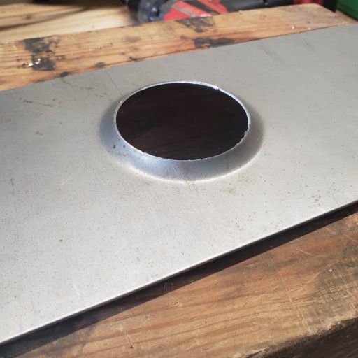

testing out a 3D printed dimple die... 2" hole in 16 gauge mild steel
I have a few idea for the bed rack where this may come handy.20200624_123739 (1).jpg20200624_123749 (1).jpg

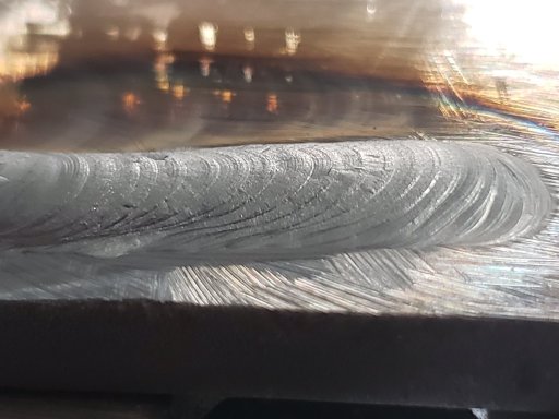

Couple shots from today's practice seasion on 1/4" mild steel
I also ground down the first days practice plate,
A bit of porosity at the start and appeared to.clear up at the end....

I don’t know much about TIG, but it looks like you are moving the toungsten too fast. The stack of
Coins should be a rainbow color.

It didn't look like very much penetration to me. I'm not familiar with tig but with arch welder you can see it penetrating as you weld. I bought a flux welder to play with one of these days. I like the idea of being able to weld sheet metal..
In the past I have only used acetylene torch and bailing wire or flux copper wire for sheet metal. Flux seems simple and will weld 1/4" steel nicely. I like because no gas is needed and any 110v outlet will do. You could probably use a car battery with inverter for power.
Yes no penetration.... the color told me that alone... also the puddle tells that he’s not welding with his wrist and the power settings are low...

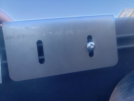

Got the bed brackets bent up today.... Discovered a few minor adjustments that will likely get done at final assembly.
I may need to extend the bolt slots a bit.
Top of the bracket is a hair longer than I would like, once the bed bars are welded on I may trim this a bit to keep it flush with the bed side.

Test printed a slice of the brackets to double check the slot location and over all fit..
need to shift the slot down ~1/4".. that should get the mounting bolt in the center, and allow for equal room on each side to adjust as needed.
Test print #2... only a portion of the bracket printed again
Turned out much better with the slot moved down

The flats for the bed brackets arrived., remember the first set i ran into an issue where the part was bent wrong. This was mainly due to how I designed the original part and a lack of understanding of the sheet metal design tools in inventor2020....
As you can see this time they turned out to be much more useable over the prior version. They sit on the top of the bed nicely with no overhang and the s3/8" slot is centered on the mounting rail. I added the slot to give a bit of room if I ever needed to raise the bed rack. To compensate for sealing material or a metal bed rail cap in the future
