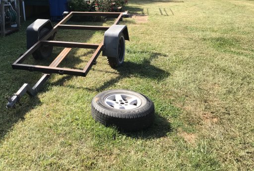

I had bought an old wooden dump trailer awhile back and used to carry my old Polaris and odd and end jobs till it finally fell apart. So far Ive striped off all the wood and brass wheeled the rust and old paint and now Im going to paint it with truck bed liner. Im still getting ideas on layout but Ill keep posting up dates as the build comes. Please any ideas or tips are welcome. fullsizeoutput_f2.jpeg

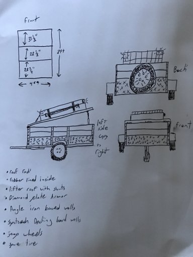

My first question would be, What do you want it to do when you are done? This question has saved me a lot of money. Ron

Solid design thoughts. You'll need to balance trailer weight and tongue weight, loaded and unloaded. I'd try to keep the water tank centered over the axle, then shift the load to keep the correct amount of tongue weight.Ron

Looks like a pretty solid platform with which to begin.
I would straighten out the crook in the tongue if you plan for a higher clearance build.
I like a torsion axle for clearance if you intend to drag it through those types of areas.
As @ohiowrangler mentioned, if a water tank is part of the plan, pay attention to where you put that, and as I planned mine, I wanted to keep the Center of Gravity (C0G) as low as possible.
And I'd plan for some type of articulating hitch rather than just a ball-mount. I've been very happy with the Max Coupler, it's easy to hook/unhook.
That's my $0.02, as people have said, it all depends on what you want out of it, truly drag it off road or only campgrounds, etc.
Good luck, I'll be watching the progress!
Dan.

Thank you I’ll keep that in mind.

View attachment 37746 Here’s a rough drawing of my idea. Also what’s the rules for non trailer tires on a trailer because I want a set of general grabbers AT2s on the trailer is that legal?
"Trailer tire" or non-trailer tires doesnt matter... its the load rating. If you have a 3500lb axle your tires must be rated for 1750lbs each MINIMUM, which most light truck tires will be. The problem generally comes when people try and use regular car tires.
Reactions: Elan
