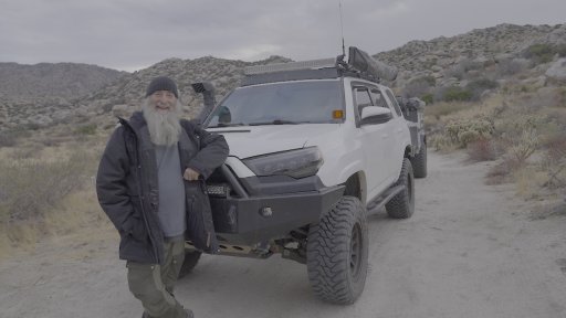

2015 White 4Runner TRD Pro (build update as of 3/1/2025)
  • Icon Stage 7 from and rear with secondary shock system in front
  • 2.5” front lift with front diff drop
  • Dobinsons C59-749VB rear springs providing 3" lift
  • Dobinsons Adjustable Hydraulic Bump Stops
  • Method Wheels 18”
  • Toyo Mud Terrain 33" 12.5" 18"
  • Shrockworks front bumper with 2 Rigid D series amber fog lights, 30” Rigid E series amber bar on front bumper
  • Rigid D-serie Pro lights mounted on each side of hood as side gutter lights for switchback night driving
  • Warn Zeon 10-S Platinum winch with synthetic line and Factor 55 Prolink attachment point
  • Full Shrockworks skid plates incl primary gas tank.
  • Budbuilt rear diff skid plate heavy duty
  • Budbuilt bump out rock sliders with diamond plate in rear
  • MagnaFlow cat back exhaust
  • Shrockworks dual battery kit and windshield reservoir relocator
  • IBS dual battery set up with controller installed in central console
  • deep cycle secondary battery
  • Safari snorkel with fully sealed air box
  • Gobi roof rack with ladder
  • Rigid 40” white light bar front mounted on Gobi rack
  • Rigid SR series light bars on left and right side of gobi rack
  • Rigid white SRM chase/dust lights mounted on Gobi Rack
  • Rigid 4 piece rock light system
  • Console vault safe
  • AlphaRex Nova Series LED headlights
  • Icom ID-5100A ham radio with motorized antenna mount.
  • Staun deflators
  • CBI steel rear bumper with dual swing arms and drop down table on passenger side.
  • ARB front / rear differential breathers.
  • Nitro 488 differential gearing
  • Driver side 23zero 270 awning with front and rear walls.
  • Driver and passenger side rear window CaliRaisedLED molle racks
  • Dometic CFX3 45L refrigerator.
  • Long Range America 24 gal auxiliary gas tank providing a total of 47 gal fuel.
  • Goose Gear rear seat delete with full platform, 3 drawers and sliding mount for Dometic CFX3 45L.
  • ARB twin air compressor with air chucks mounted on each side of vehicle
  • Patriot Campers X3 trailer (gen 1) with Dometic 75L dual zone, Cook Partner stove, Weber BBQ. Converted Webasto water heater from diesel to kerosine.
Photo taken February, 2025 in Culp Valley of Anza Borrego Desert State Park, CA after install of Rigid D-series gutter lights on hood, AlphaRex Nova-series headlights, Dobinsons rear springs, and Dobinsons hydro bump stops.
Photo taken in Tuktoyuktuk, NWT, Canada in July 2023
Photo taken on Thomas Mtn, CA during ham radio Field Day 2020
Photo taken in the Alabama Hills, CA in 2019
