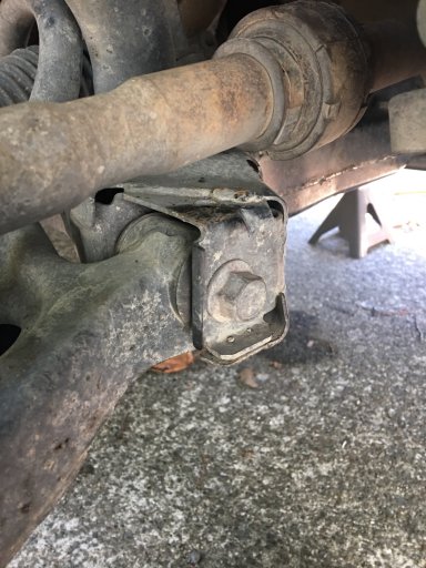

So the passenger side drive shaft is longer then the drivers by almost a foot, so that must obviously count for something.... but yeah, this is my point of contact IMG_7418.JPG
JaxxaLuca
And those are with the 40mm spacers? The pic of it up on the jacks looked so promising. Even with the axle touching it looks like the bolt holes on the strut were still a half inch off, so you might have to shave off about 10mm of that spacer.
You could also rent strut spring compressors or find some other way to pre-load the strut to get it to line up-- you just have to make sure that wheel for sure stays on the ground when you're driving, I can't imagine that would be an issue unless you go off a jump or drive on something aggressively off-camber.

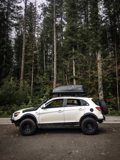

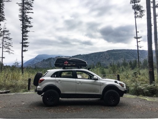

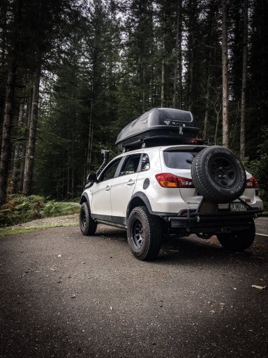

I got the lift completed this morning. Woke up early to finish up the front and bang out the rear, which went much smoother lol. Car feels great and handles really well. Pretty much same as stock did! I’m digging the lift, not too much but it’s definitely noticeable and will help a ton on some of the trails!! Onto some pics!

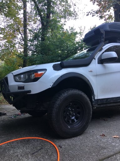

So how you liking the lift after a few days? Think my next upgrade is rims tires and fender flares. Don't want to cut it up yet, but need something to help block crap from hitting the car. Wheels will stick out an inch over stock

I’m loving it! The more we see it the more I’m digging the look. All the other mods make much more sense now lol. I always thought the snorkel looked a bit odd being low but it flows good. I haven’t been off road yet but plan to get into the woods soon [emoji12]
With fender flares you’re still going to have to drill holes into your body which is just as much to me as cutting the body, maybe start with a good mud flap or something? Also with fender flares you need to cut the body to get the arches right or you will have some under-hang from the original body.

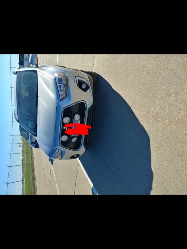

Gives me something to think about. Mounted some front lights on it, similar to the rally light plate style. I'll throw a picture on later. It gives me something up front until I can find a bumper to cut up or til warranty is out.
