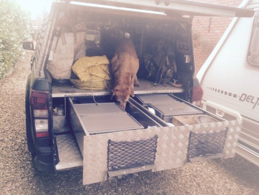

@Graham That bed box setup is really slick. Love the built in space for your pups.
Not really for pups the middle box is for my gundog and the side opening doors for my. Terriers but everthing doubles up as storage for work and leasure , good thing is that set of draws has been transferred off and on 4 nissan navaras then into 2 isuzu d max , the top but did not fit the dmax So a new one was built but i got a good price for the used one i would never go back to fibreglass The constrution lasts unlike snugtops
just a few pics of my draw system

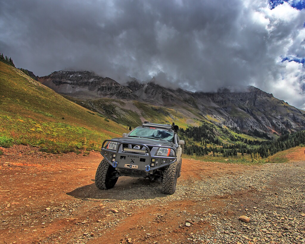

Mine has gone through a couple of pretty major rebuilds the last couple of years.
First one consisted of basically changing out Everything, less the front spindles for the "Titan swap" of the suspension.
That requires converting over to Titan truck components (direct bolt-in [emoji106])
The front m205 diff, lca's, cv's, tie rod ends, aftermarket uca's, and then adding Titan swap specific coilovers to the setup to give you over 2" in width per side and almost doubling wheel travel to close to 11"!
New heavier Alcan springs in the rear with tuned Fox remote rez shocks, timbren bumpstops F&R, radflo hyd bumpstops in front to boot.
Heavier M226 rear axle (d44 variant) w e-locker. Front ARB air locker.
Then last spring I pulled diffs again and switched to 4:56's so I could run 35's. 2" body lift for clearance. Cst aluminum radiator, 200a alternator. Air horns to compliment my viAir oba system.
I've built all of my own armor, less the gobi ladder.
I occasionally run a Cvt RTT when I need it.
Still need to install the national luna dual battery system and odyssey batteries, but always too backlogged with bumper orders[emoji848]
About ready to pick up a frontier or new Titan I'm thinking for the next project.

Wow, that is a great looking X. I had an '07 I bought new with the intentions of doing similar stuff, but it wasn't the rig I had thought it would be.
