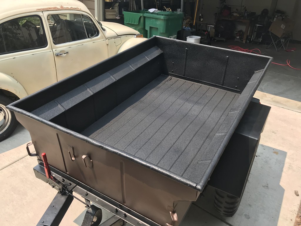

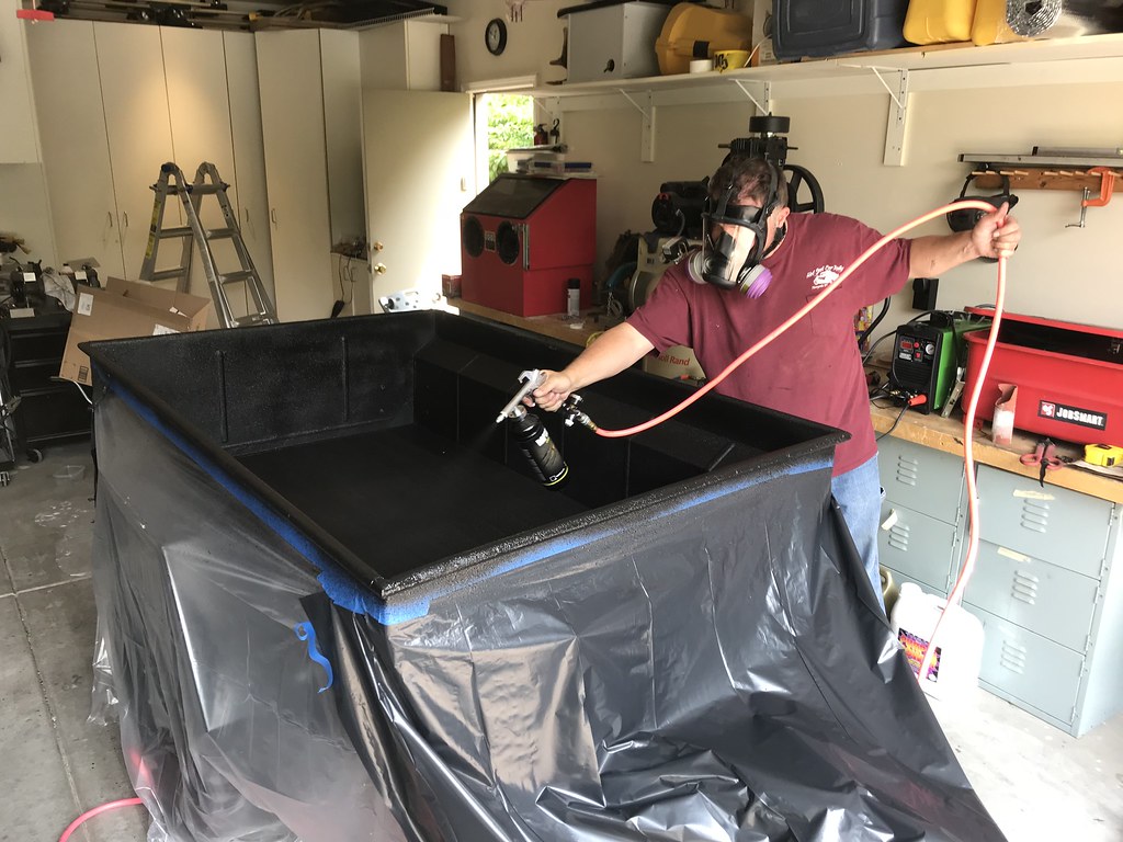

Is that the Raptor DIY spray liner? How'd you like it? was it fairly easy to use and clean up?
Yeah, raptor liner. Install was easy and it wasn’t bad to clean up.
I’m not in love with it, it’s worked well but on the lip of the trailer it has chipped off in some areas where I connect hooks and or bang stuff up against it. I need to touch up those areas.

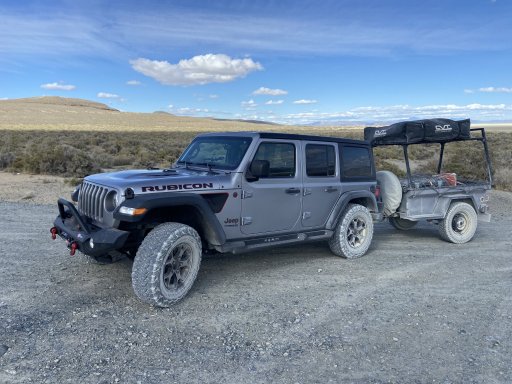

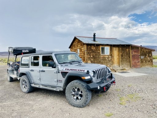

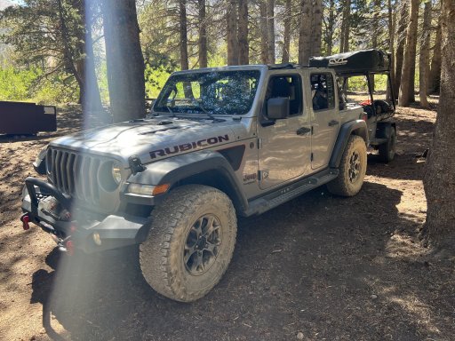

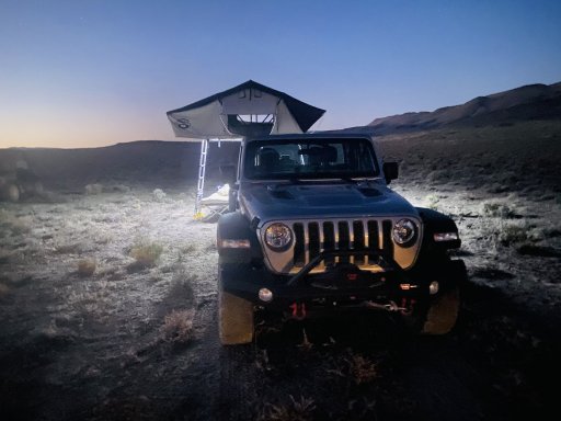

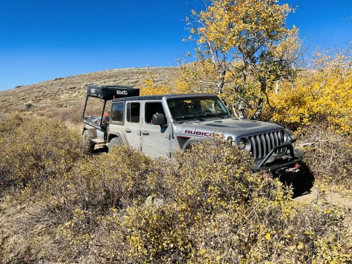

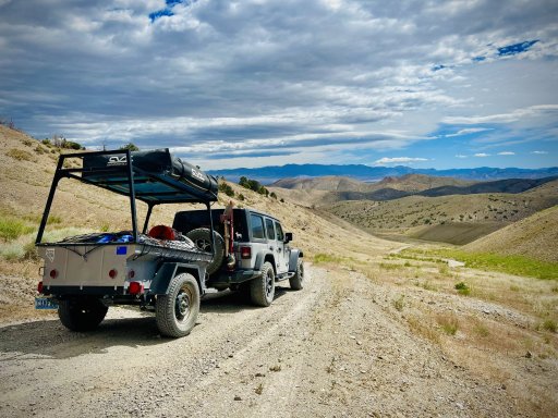

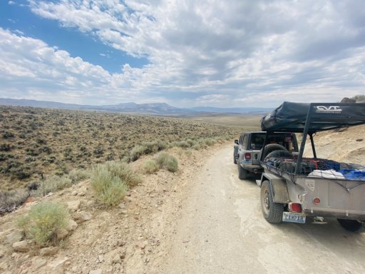

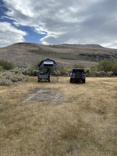

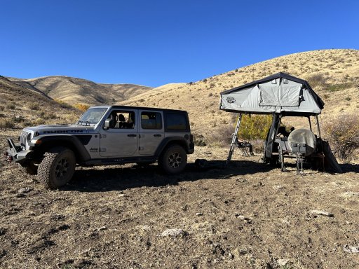

Since I’m logged in, here’s some more pics from some more trips, mostly to the same areas as above because we were headed to my hunt unit.
F5241E40-A7CB-459A-84DA-3F9893753E94.jpegE6C47ECF-33EF-45B5-838D-76C5FD475C46.jpeg1BD95E28-32DF-4C41-9B6D-E2EEEEF4C48E.jpegCD95DC78-CE0D-4756-8A4B-1D4153D50D5D.jpeg5E4DF45E-BCA6-40C8-96DF-56F1CB9B0710.jpeg77ED8131-943A-4AA8-B5F9-2900179911A2.jpeg3CBAA12B-1AC5-4959-938B-612CA9A58738.jpeg
When you prepped it, what grit of sand paper did you use. I sprayed Raptor on my M-100 and had it chip. Turned out I didn't use coarse enough sand paper when I prepped it.

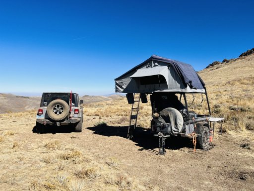

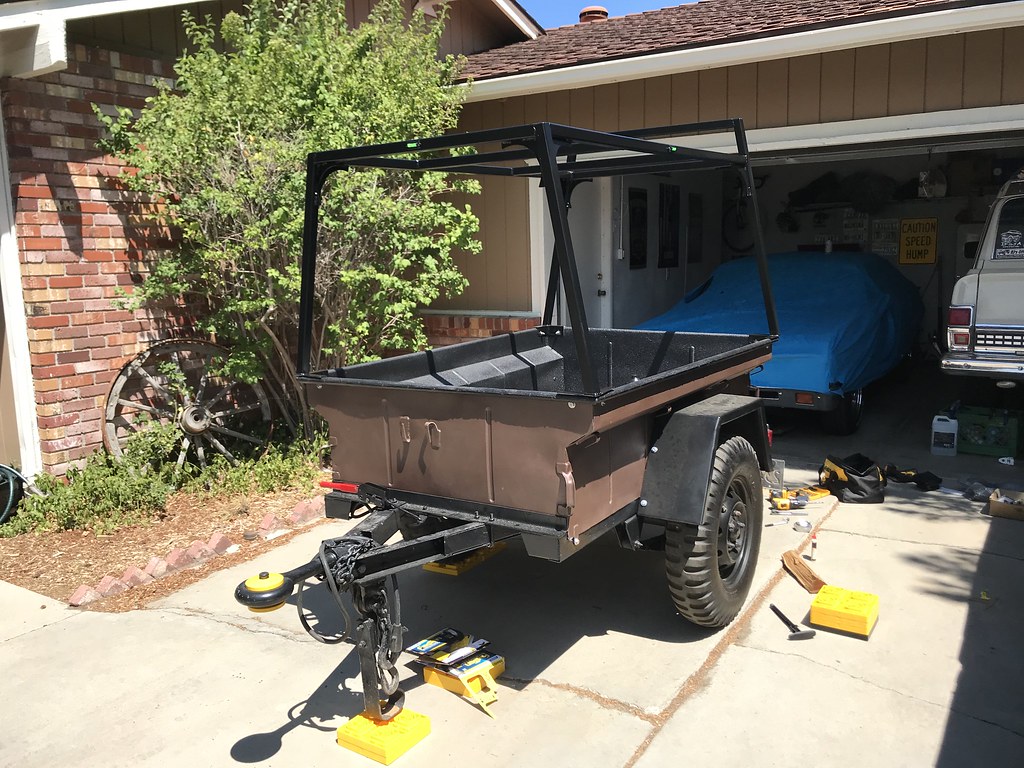

More work done. Painted the rack, added some bubble levels.

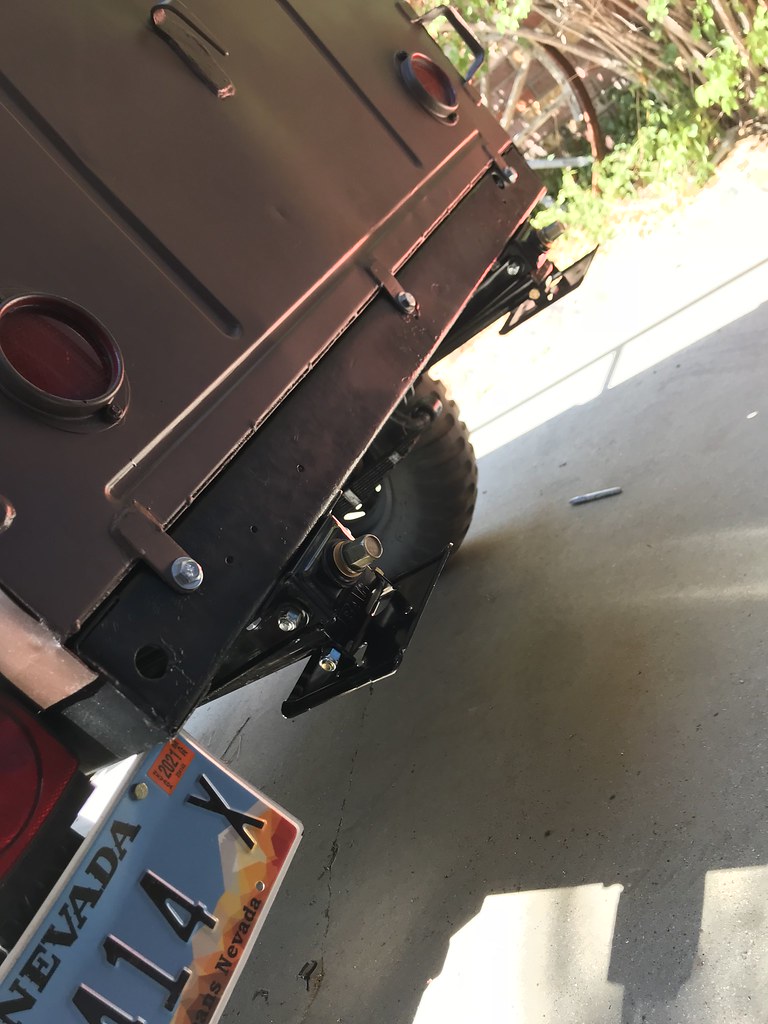

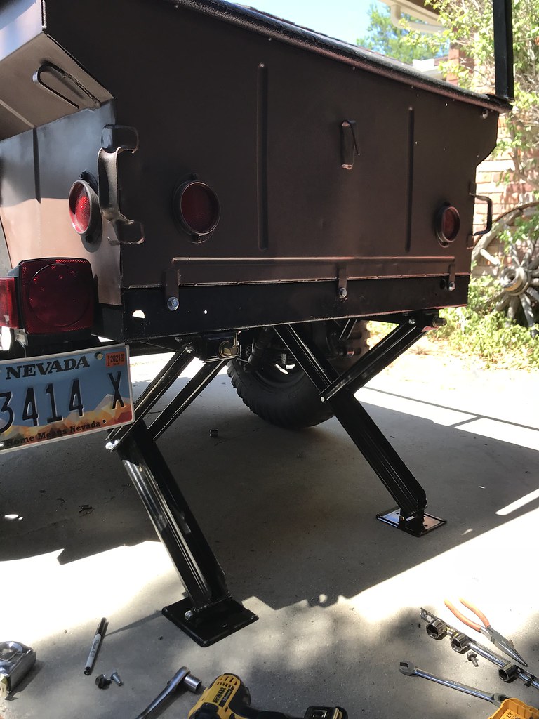

Added stabilizer jacks under the rear to make sure it doesnt go tippy tippy backwards. I can jump up and down in the back now and no issues.
Picked up some lvelling blocks so I can get it pretty close to level in every direction. also makes it easy to level the front using the stock landing gear. Looked briefly into adjustable landing gear but said nah.
Picked up the most sturdy bin I could find. Looked at sportsmans, cabelas, and home depot. All the stuff by plano was flimsy. This thing is solid as a rock. I can sit on it and it doesnt bow. Plenty of locking points to keep honest people honest, and will allow me to store my smaller gear securely when we are away from the trailer for the day.
Last thing I need to do before the first trip this weekend is mount up the spare tire in the front. Have a rack designed, but havent built it yet. Should be easy peasy.
Untitled by Marn, on Flickr
Who makes the stabilizer jacks and where can I pick up a set? Thinking of the same set up for mine.
Thanks.

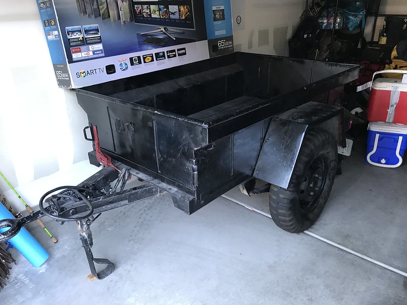

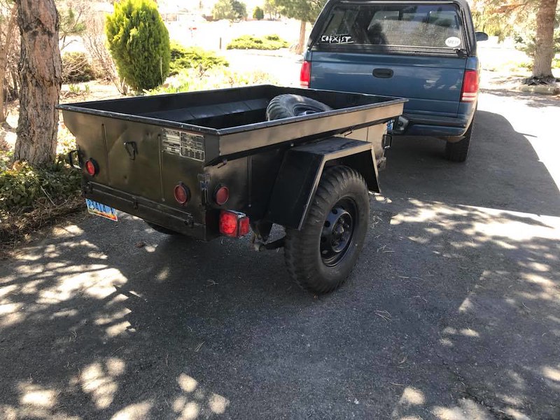

Nothing super special here. My old pop up that I drag down a lot of back roads is really starting to fall apart, so I picked up an M416 on my last trip down to Vegas. I looked at a couple, and landed on this one It was 100% ready to roll, with 2 year old tires, the original rims and tires included as spares, LED lights, 2 year old bearings and a brand new set of replacement bearings, and it even included a pintle hitch. Aside from the LED lights, it's 100% stock which is what I wanted.
No visible rust, some flaking paint and a little surface crust underneath, a couple dings and dents in the tub, and it had been very sloppily painted. I had intended to paint it without doing a complete tear down and refinish, but there were so many runs and drips in the paint I figured I'd do it right.

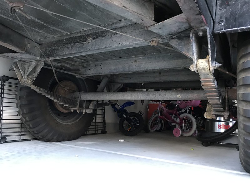

The only odd thing I have noticed is that it sits a little low in one corner. I've seen a number of other trailers that in pics at least LOOK like they sit a little off camber, so many its from a hard life of use, or 1960's government contract manufacturing, who knows. I've decided to simply shim the tub in that corner to get things a little more level. about 1/2" shim should take care of it. the frame sits level across the axle, so its just one of the corners.

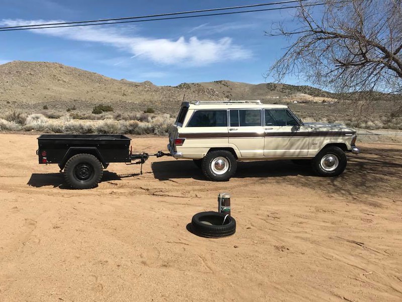

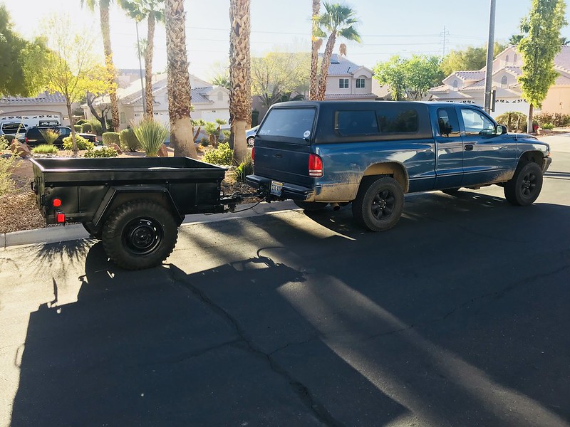

Anyway, drug it home with my lil' truck. 500 mile trip and I didn't even know it was there.
trailer1 by Marn, on Flickr

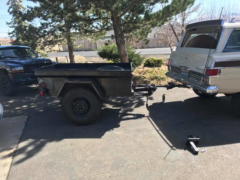

Hooked it up behind the wag to see how it'll sit, looks pretty decent. SLIGHTLY low in the front.
trailer3 by Marn, on Flickr
trailer2 by Marn, on Flickr

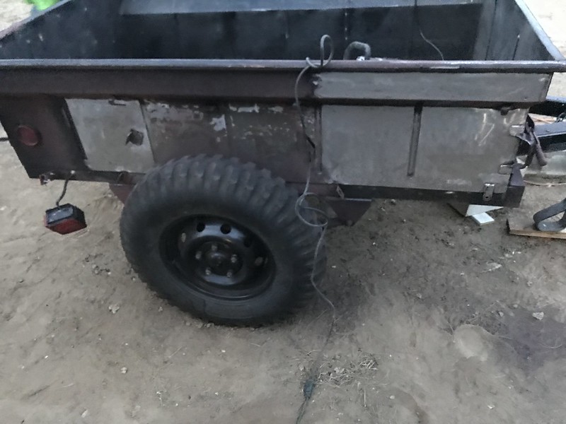

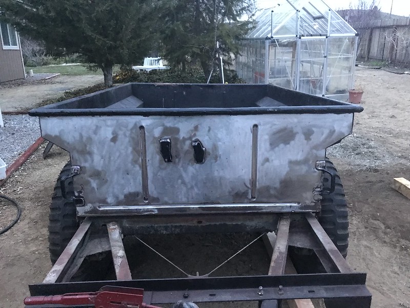

So, as mentioned, decided to do a full repaint. So, threw on my respirator and went to work with some grinding wheels.

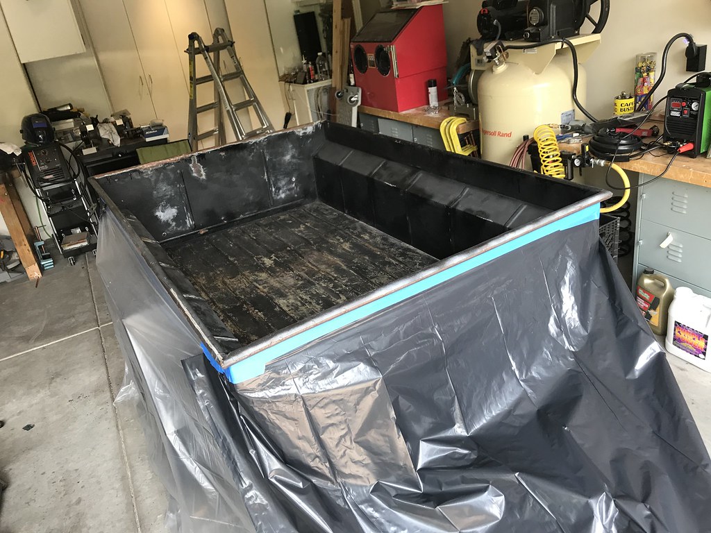

Presently, the whole tub is primed on the outside sides. For the underside, I'm going to hit it with a wire wheel and bed line the bottom. I will also be bed lining the interior up to the top rail. Just going to use black Monstaliner. I've wired wheeled the interior and removed any of the flaking stuff in there, but I'm not intending to strip it down to bare metal.
I need to finish be stripping the fenders, then I will move onto the bottom of the tub. The frame has been wire wheeled, and will be getting shot with a coat of summit racing's chassis paint. Then the tub will get shot with whatever color I choose, and plopped back on the frame. At this point, the actual "build" will begin as time and money allow.

@Marn Great looking m416. I have a BantamT3C (Post War Civilian version with a tailgate) that I have slowly been working on over the years. Did you weld up the scissor jacks or bolt on? Been planning on adding some on my trailer.
R
RN J
Guest
I had to look up what a scissor jack was…still don’t understand how or where you’re using them in relation to an RTT?
Marn
1,135
Reno, NV
Sorry for not seeing this.
i bolted them on, just through the frame. I took them apart and drilled a hole/used a bolt up through the center of the Jack so that they mounted to the rear crossmember as well as one to one of the center ones

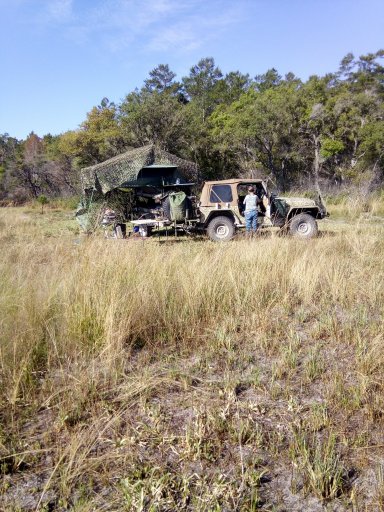

Hey nice rig ! Here s one from Florida , the rtt raises up an down to 7ft on 4-100lb gas struts an the lid raises on 2 -50 lb struts , also trailer spare tire is mounted inside rear of trailer. Jeep an trailer wrapped in mossy oak shadow grass blades. Very tough wrap! Did it myself for around $700 for booth. Trailer lid is fabbed out of sheet metal.
