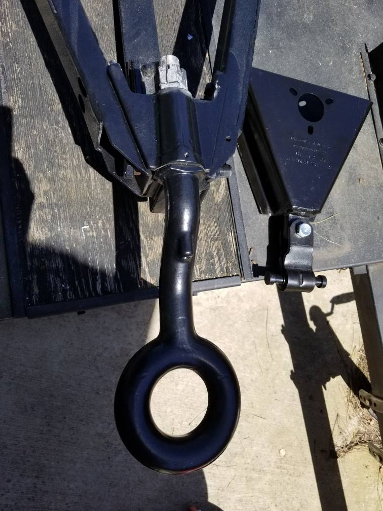

It took a Herculean effort, 24" pipe wrench, and a 6ft breaker bar to move it, but its off. I've removed the entire end and will replace it with the Lock & Roll in the pic. 4 grade 8 bolts should hold it together nicely. Because it was powder coated before deciding to remove the existing hitch, it'll need to be re-coated. Luckily, I have a batch with the tent rack, LR4 sliders & tank plate going in this week. Just need to drop off the two hitch rails.

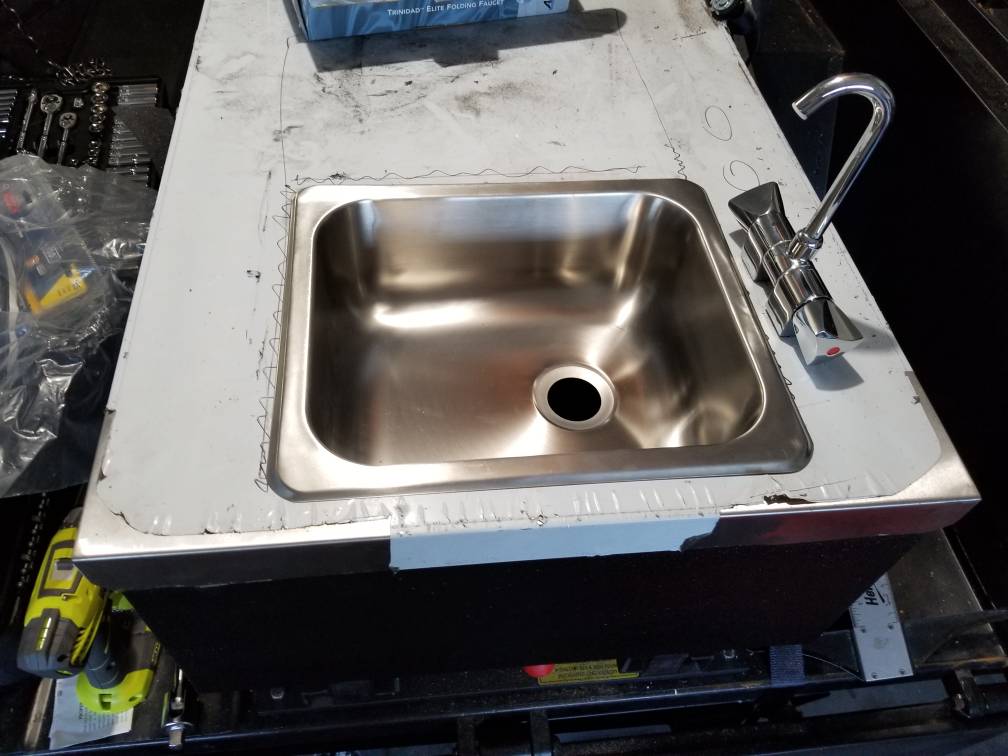

I measured the sink twice or 12 times. It went in great, after lots of cutting and removing some sub frame in the counter top. The faucet folds flat, but is a little crooked due to the subframe holes. Stove is next.
Not a bad weekend!

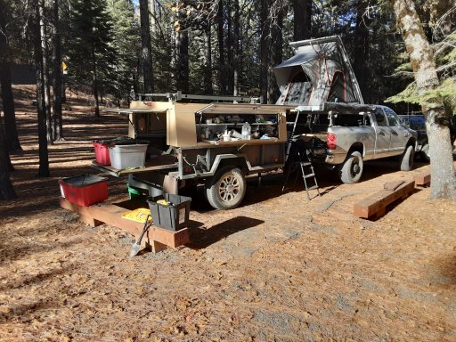

Selling my shell going in different direction. 82458B02-33C7-4DBD-9023-39C712368C21.jpeg
