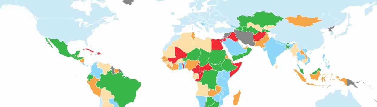

Keep in mind it's ULTRA-low sulfur diesel (ULSD) that is needed for 2007+ trucks. Low-sulfur diesel has been around for decades and is what was available before the ULSD mandate. This is critical to know because if you think it's LSD that you need and are looking to make sure locations have LSD, not ULSD, and you have an emissions-intact 2007+ diesel that LSD will eventually kill your DPF. Last time I checked, ULSD was rare south of North America. Can even be hard to find in parts of Mexico.
Also, Ag/off-road/marine diesel is dyed ULSD in the US. It hasn't been LSD for a long time, the only risk you have by running Ag/off-road diesel in your truck is if you get pulled over by a DOT/commercial enforcement LEO that wants to dip your tank or inspect your filters to see if you're running untaxed off-road diesel.
If you're planning on heading south with a diesel then I wouldn't recommend taking a DPF-equipped vehicle.

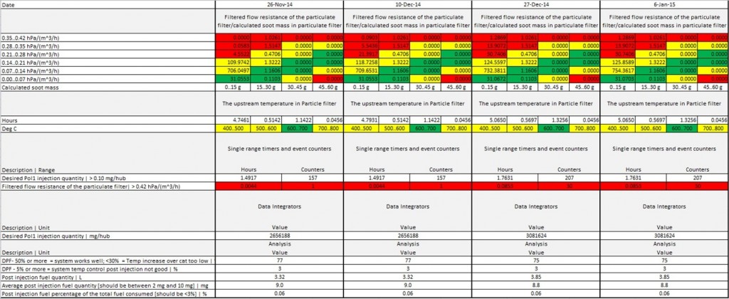

Can the DPF just be cleaned more frequently if exposed to a lot of non-ULSD?
There is a guy doing a world tour in a new Iveco diesel truck. He is very knowledgeable and makes very good research .
To resume, it depends a lot on how well the DPF and injection system is designed. Iveco daily or mercedes Sprinter 4x4 vans seem to do fine. 500 ppm Diesel it is a non issue. More than that, the effects seem to be temporary.
That being said, if the particular model you want does not have a good rep even in ideal conditions ( meaning running with the fuel it was designed for ) , you might have a lot of problems.
For sure you will need to half you oil service interval when running on high sulfur diesel and you DPF burning cycle will kick in more often.
Makes life a bit harder with a modern diesel but it is doable.

The problem is not only finding 50ppm diesel in some remote / rural areas but also the quality of diesel. I would recommend a pre-filter (2-micron) regardless. This has saved my motor a couple of times.
I have a 2012 Toyota D4D diesel and it doesn't mind 500ppm every now and then. I also had a 70 series Land cruiser before and opted for the 1HZ motor instead of the V8 specifically for sulphur and diesel quality.
For a global overlander I would seriously consider gas instead of diesel;
