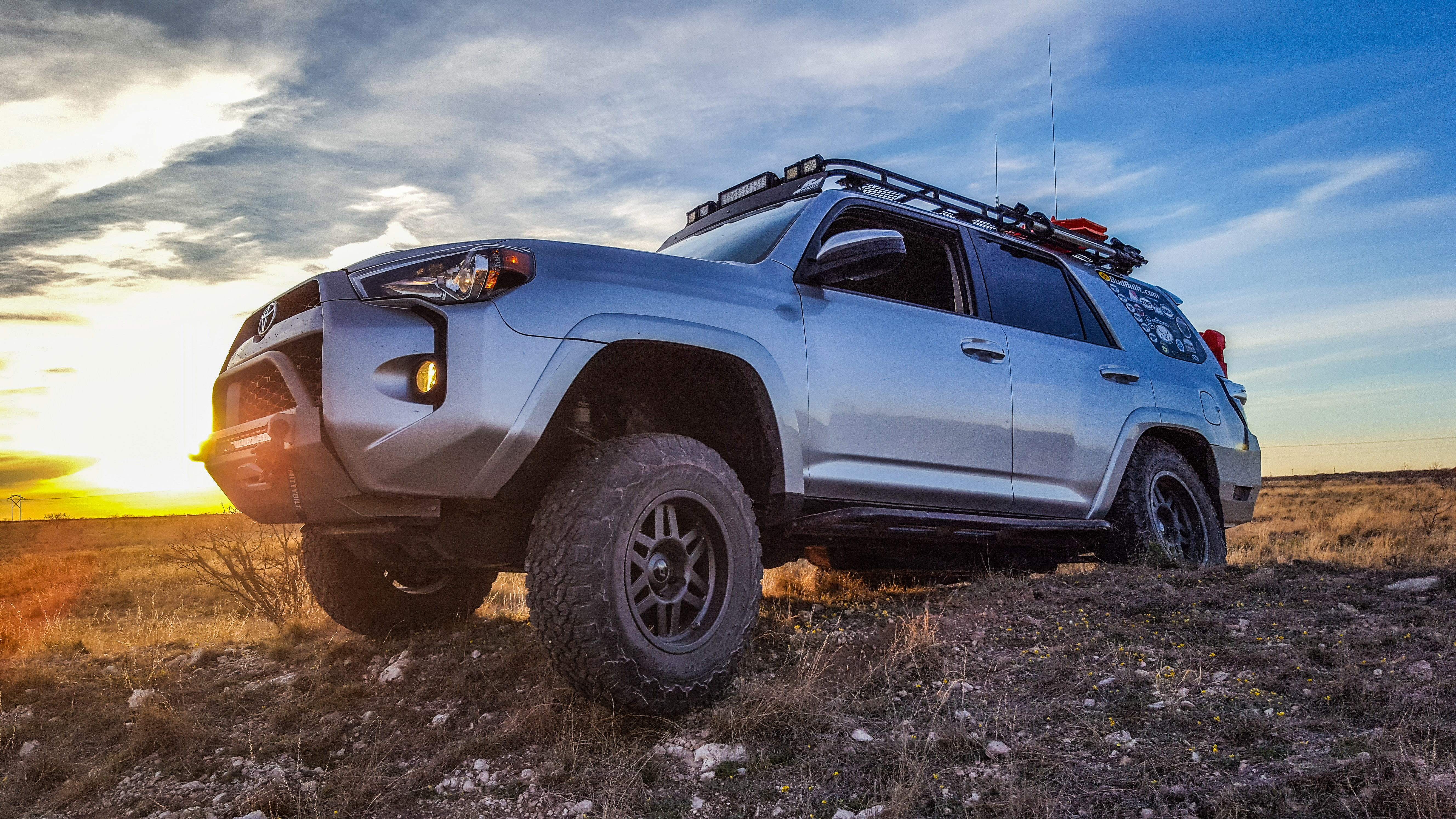

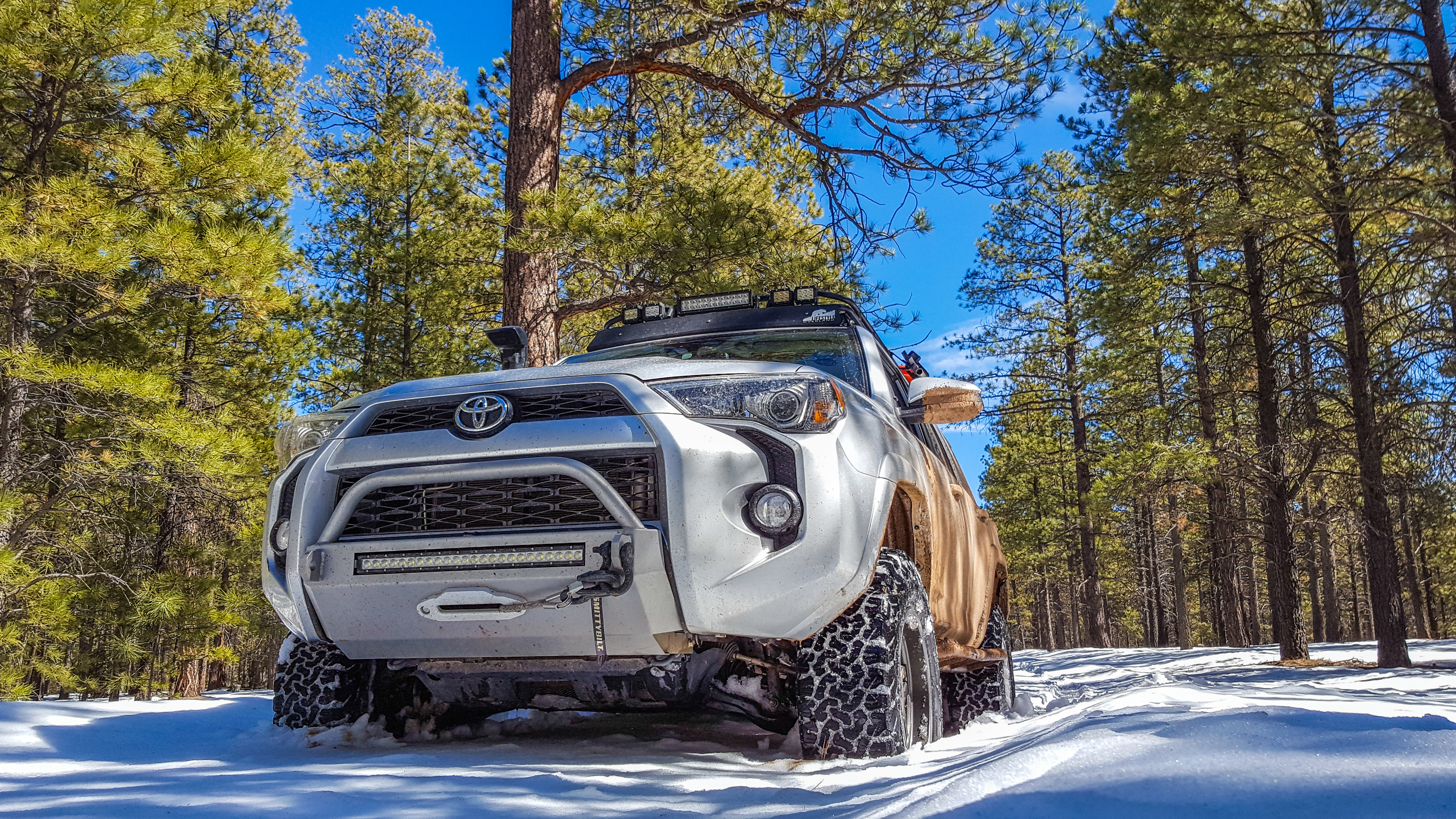

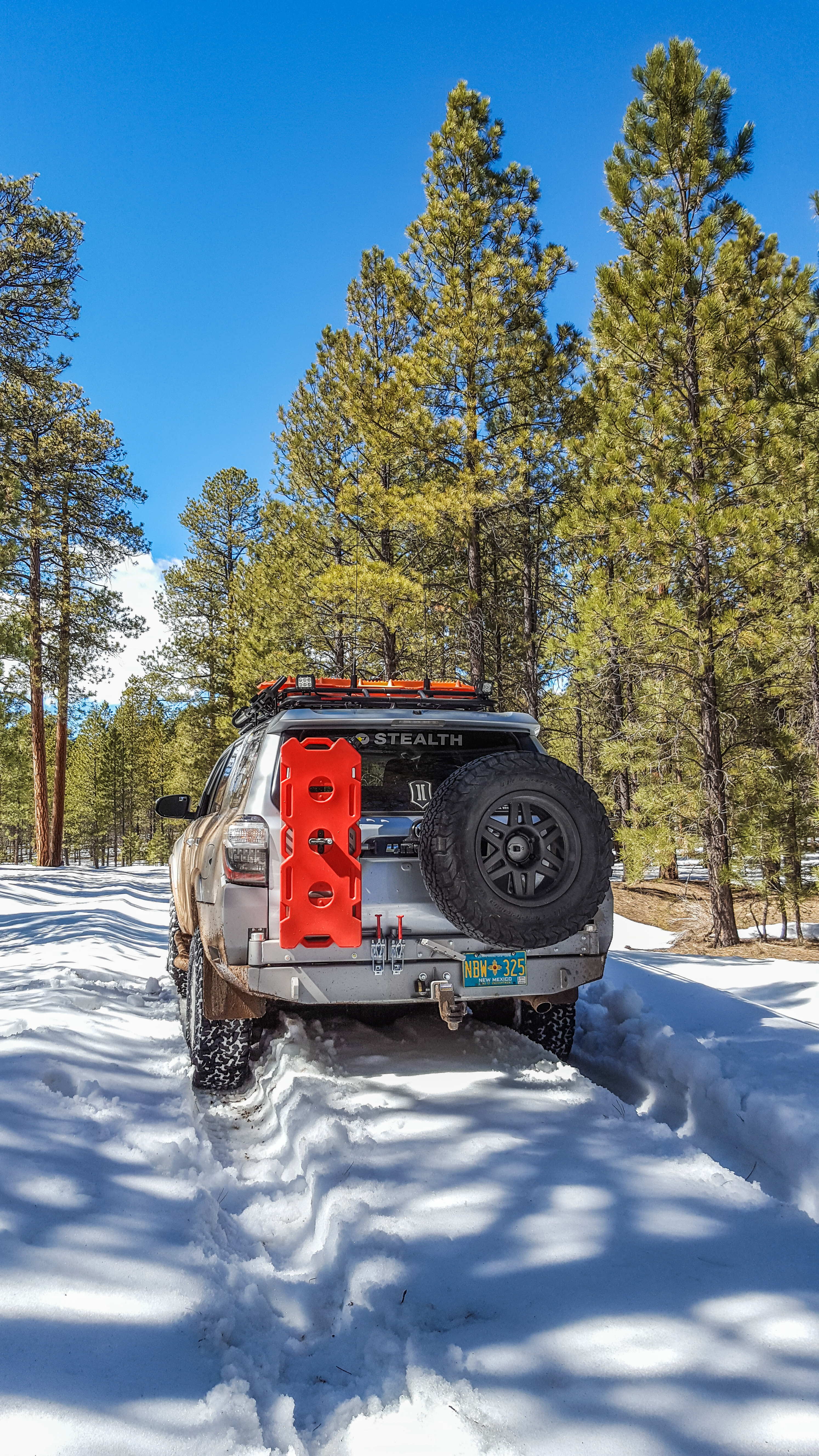

Here my wife's project and the family's primary Overlanding build:
Current Configuration:
Current Stats:
2014 Trail Edition 4Runner
  • 4.88 Ratio Nitro Gears
  • ARB Front Locker
  • Toyota Rear Locker
  • ICON Stage 2 Suspension
  • Old Man Emu 2899 "Super Heavies" Rear Springs
  • Bud Built Sliders
  • SCS Stealth 6 Wheels
  • BFG T/A 285/75R17 Tires
  • ARB Dual Compressor on portable skid
  • ARB 50qt Freezer/Fridge
  • Uniden Bearcat CB
  • Larsen CB Antenna w/Diamond Rack Mount
  • Yaesu FTM-400XDR Dual Band Radio
  • Larsen Dual Band Antenna w/Diamond Rack Mount
  • Gobi Rack with Hi-lift and Pull Pal Mounts
  • Southern Style Offroad Slimline Bumper w/25" LED Bar
  • Southern Style Offroad Rear Bumper
  • Smittybuilt X20 10,000lb Winch w/Synthetic Line
  • National Luna Dual Battery System
  • Shrockworks Aux Battery Mount Sytem
  • OPT7 and Nilight LED Rack Lights
  • BAXF OBDII Reader with Bluetooth
  • Torque Pro Engine Diagnostics App
  • Samsung Tab 2 on Ram Mount
  • FTS Snorkel
Upcoming:
Auxbeam LED Headlights
Auxbeam 40" Curved LED Bar
Custom Rear Storage and Fridge Slide
Roof Rack Mounted Solar Panel (100W)
Zamp On-Board Solar Controller
(Previous Stages of the Build Below)
Borrowed the Shoes from the Beast for a while... he was not pleased but they look awesome on Momma Bear:
Rockin' the Ghetto Rack with full size spare until the Gobi shows up. 2x2's and a ratchet strap worked great for our Big Bend trip.
I've always been a GM and VW guy but I've recently gotten attached to the Toyota's and I have to say... I've been extremely impressed with this 4Runner so far!
