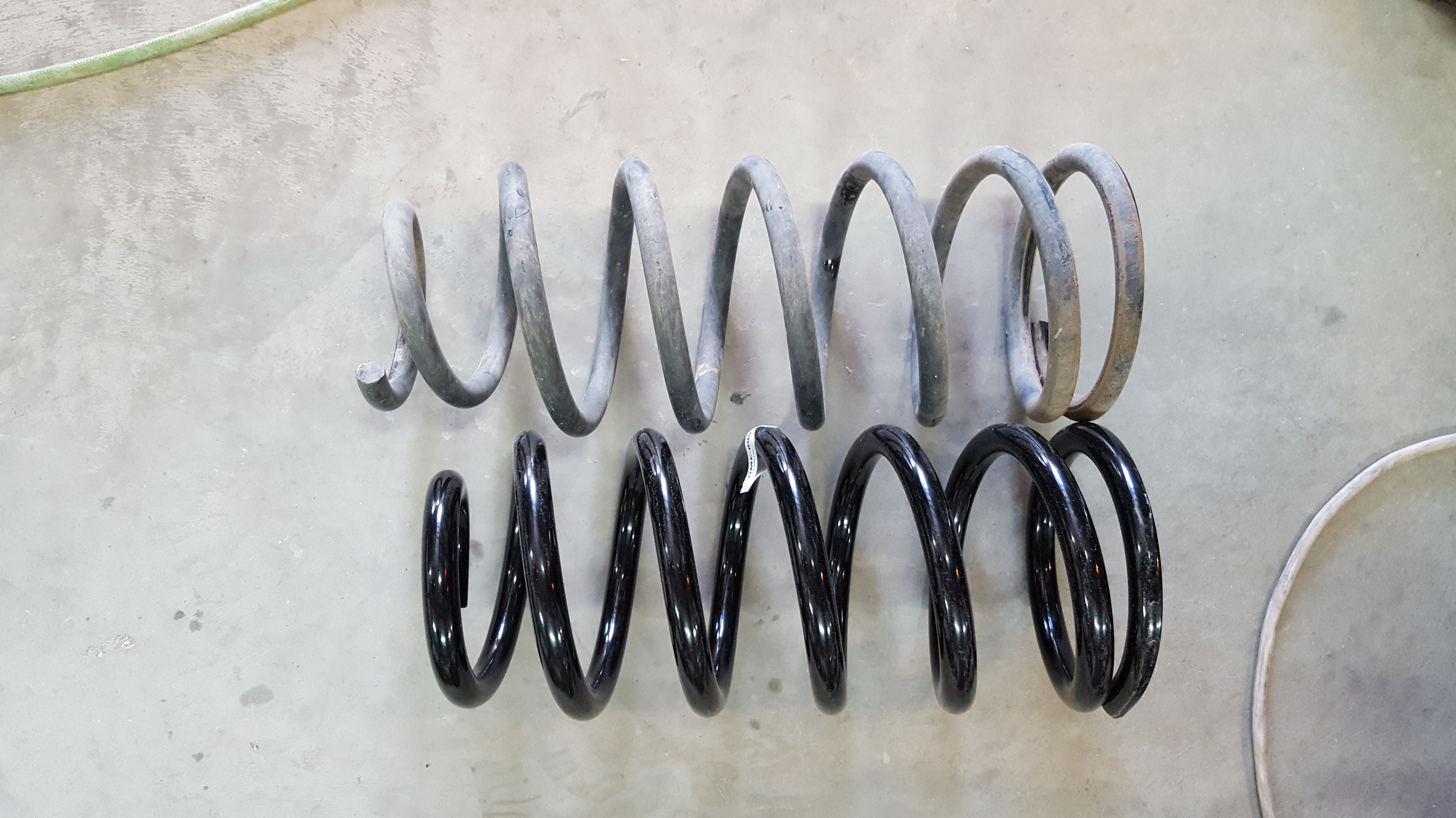

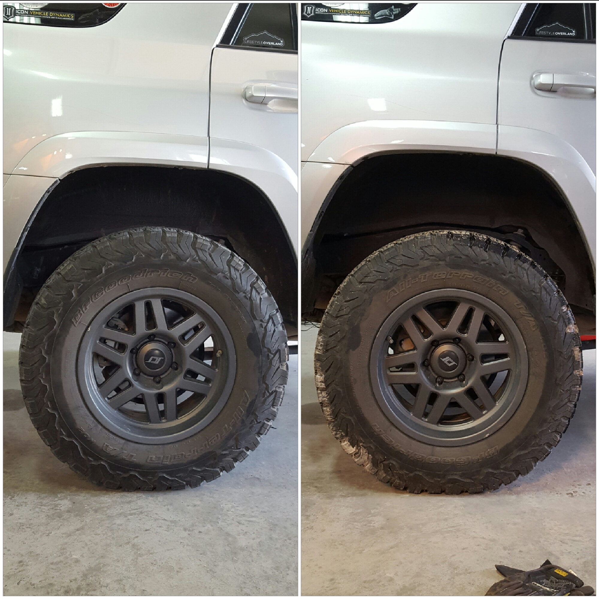

Installed some Old Man Emu 2899 "Super Heavies" rear springs in anticipation of our Southern Style Offroad rear bumper with is going to put some junk in our trunk.
Ended up with 1.75" of extra height over the Icon 3" springs we were running! Gotta weigh this baby back down soon!
Icon (Top) compared to OME (Bottom).
Before and After
Sits ok fully loaded for now, even without the rear bumper installed it doesn't ride too rough. She certainly has a nasty rake unloaded though!

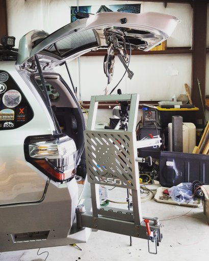

Got the Southern Style Off Road bumper installed this weekend after about 9 months of lead time (worth it). The packing job was exceptional, the hardware was well organized and individually bagged and tagged. Unfortunately, I had to modify the ladder to clear the rear hatch and was missing lower bearing seals for the swing arms as well as a few misc bolts. I was able to get it all installed but will have to remove the swing arms when my seals arrive later this week to install them.
Have to give kudos to Kevin and Gwen at SSO for answering my emails on a weekend at 10:30 PM. I know they are growing faster than they expected and are playing catch-up so I have a lot of grace for the missing parts. I heard they have stopped taking orders for this bumper until they can work down the backlog and improve quality so again, kudos to this company for their efforts.
We will have a full installation video of this unit on our YouTube channel in the near future.
On to the pics!
Naked Rear
Main Bumper Installed
Sexy Side Shot (There are LEDs in that step cutout)
Camera Relocation (Worst Part!)
All Dressed Up (Minus the Hi-Lift, gotta get some hardware)

Hey, did your 4Runner Trail come stock with Bilstein shocks? Mine did and I was wondering if you switched those out with the ICON configuration, or did you leave the original ones on? In addition to that question, did you need to raise it to the full 3.5" lift that the ICON let you for those 275 BFG tires?
Lifestyle Overland
Pathfinder II
4,387
United States
Kevin
McCuiston
0102
Mine did not come with the Bilstein. I upgraded to the Icon Vehicle Dynamics stage 2 about 20,000 mile in. I think I ended up with about 2.5" in the front and 3.5" in the rear with the new OME 2899 super heavy springs. You can actually run stock suspension with the 275's. Just get a little rub full lock, in reverse.
