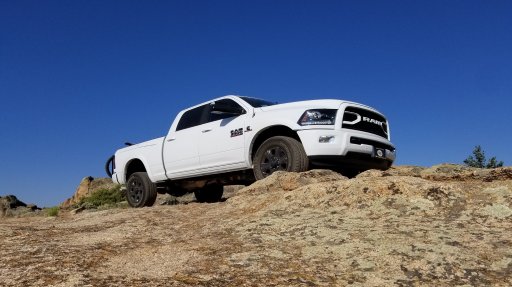

Nice looking rig. Great to see another RAM here. I would suggest browsing the ram forums and going through the lifted section. A lot of great info. My one piece of advice is if you lift do uca as well. Even at stock heights our trucks have been known to pop ball joints at full droop. My build is slow as wellI currently have a 2018 Ram 1500 Laramie Crew Cab 4x4. I want to do a slow build up on it, since I’m new with 4wheeling and it’s my Daily Driver and 5th Wheel Camper Tow Rig(currently).
I do plan to do some light modifications to get it leveled and sitting it correctly with wheels and tires first. Any tips or advice would be great!!!![]()
Nice looking truck. I have the same truck just a couple years older. When it comes to suspension the Ram beans does have as large of an after market follow as Ford and GM. Not to mention the rear coil springs makes things a little different. After looking at options for a while now I figured this much out. For a simple 4-6 inch lift pro comp is probably the most complete solution you will find. If you want something like long travel suspension then you be ready to pay and and you aren't going to have many choices. As for time like uninstall control arms and coil overs you will be best severed buying them as individual components and adding then onto a lift kit.Nice looking rig. Great to see another RAM here. I would suggest browsing the ram forums and going through the lifted section. A lot of great info. My one piece of advice is if you lift do uca as well. Even at stock heights our trucks have been known to pop ball joints at full droop. My build is slow as well
I am going to go with custom set of kings valved and tuned by Carli plus a set of Carli rear springs since I will be towing a lot. More than likely I will be going with maxtrac uca. They are about the same price as everyone one else but they seem to be slightly beefier in their design. I will also be adding a set of bags in the rear just to help with the squat from the trailer when towing.Nice looking truck. I have the same truck just a couple years older. When it comes to suspension the Ram beans does have as large of an after market follow as Ford and GM. Not to mention the rear coil springs makes things a little different. After looking at options for a while now I figured this much out. For a simple 4-6 inch lift pro comp is probably the most complete solution you will find. If you want something like long travel suspension then you be ready to pay and and you aren't going to have many choices. As for time like uninstall control arms and coil overs you will be best severed buying them as individual components and adding then onto a lift kit.
