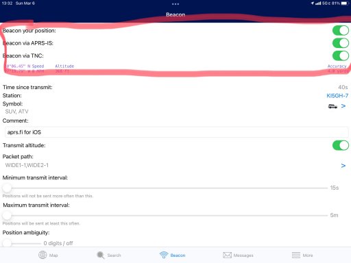

Easiest amateur radio equipment setup I have ever done
I’m having trouble with my tnc3. It won’t beacon. I can sometimes force it to manually, but it won’t appear on APRS.FI. I can see the radio transmit visually, and hear it with another radio, but nothing is getting out.

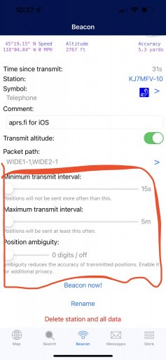

If you are transmitting off of the radio with the TNC3 and hearing it in another radio, but aren’t being spotted on APRS.FI, then you aren’t hitting an iGate. You either need a better antenna, more power, or a combination of the two. If you have a buddy with an APRS enabled radio, see if he hears you and your information is displayed on his radio.
As for it not beaconing, make sure you have the settings correct in APRS.FI. Position all three sliders to the far left and you should beAvon every 15-20 seconds while moving and up to 5 minutes setting still. To manually beacon you have to wait 15 seconds from the last beacon.

I reset those slides. I drive through the heart of Austin twice yesterday. Dozens of stations are on the map, but nothing. I have used the same radio and antenna to kerchunk a repeater 40 miles out from me, so I don’t think that’s the issue.

Did you install the Mobilinked TNC Config app?
I did. I also just had a SMH moment. I have APRS.FI on my iPhone and iPad. One had these three toggle ON, the other had them OFF. Poor TNCs couldn’t figure what was coming or going. So for now anyway, I’ve told my phone to forget the device.
Yes you can only use one device at a time. Is it working now?
