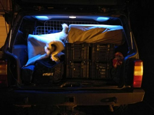

I also put these in the back of my Outback that I had prior to the 4Runner, and will do something similar in the new truck.
Copied from my Outback build thread: Here are the LED light strips I added to the cargo area. $7.19 a pair on Amazon. http://amzn.to/1IwVlO9 I'll be adding two more on the lift gate to act as flood/puddle lights.
I installed the other two LED strips on the lift gate today. Same parts and wiring as above, except this time I used the always hot side of the third dome light, and added a switch on the inside of the door. This way I can have the lift gate open and not have the overhead lights on, or if I'm sleeping inside, I can have these lights on without any other interior lights. There's adhesive around the switch that I'll peel off after it drys.

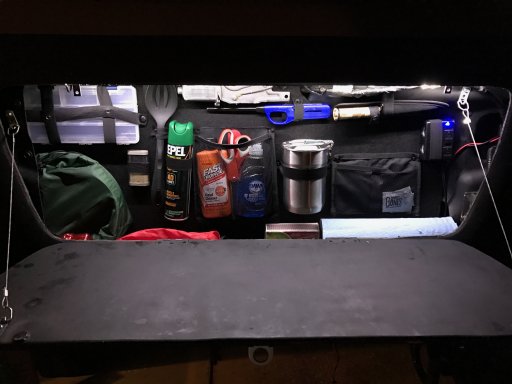

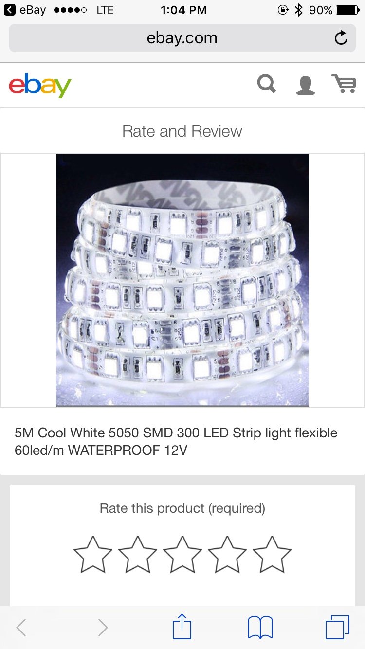

I buy the reels of LEDs off Amazon (or Ebay) for my lighting. Have a strip just inside the cargo door on the inside on the roof to light up the cargo area and another strip in the storage area in my cargo door. Both are on switches and run off the house battery. I have the dome lights in the truck turned off so they are not wearing down the battery when camping and the truck is open.

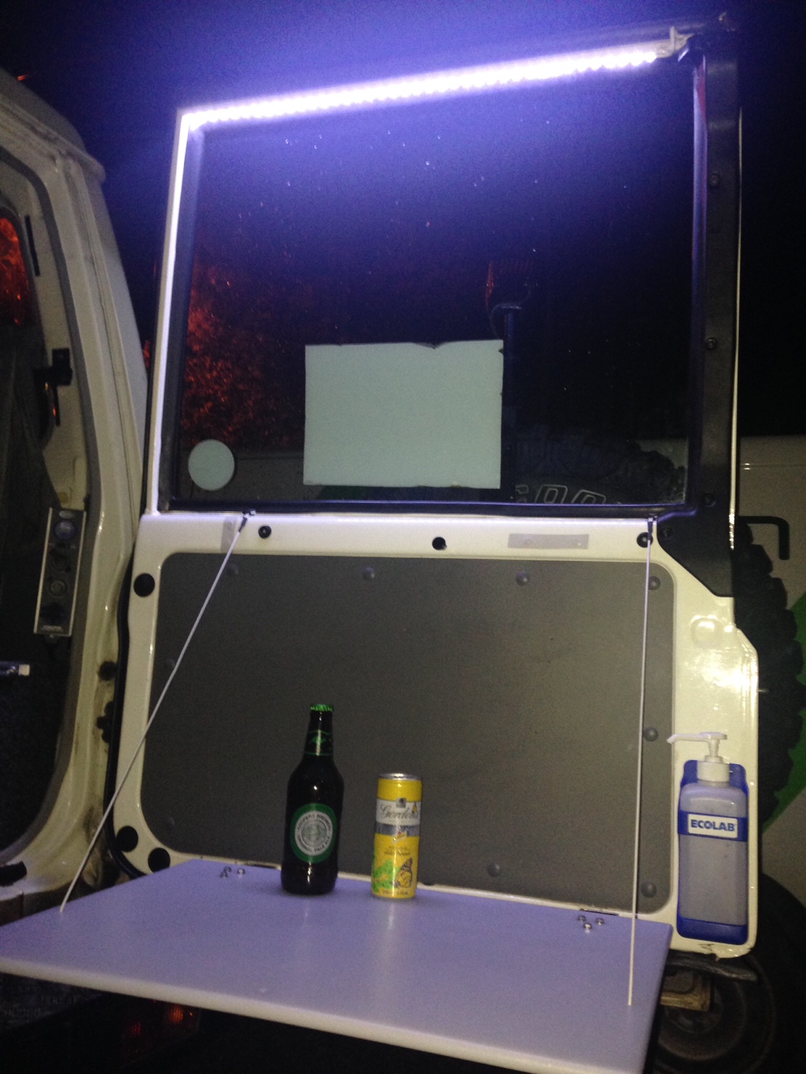

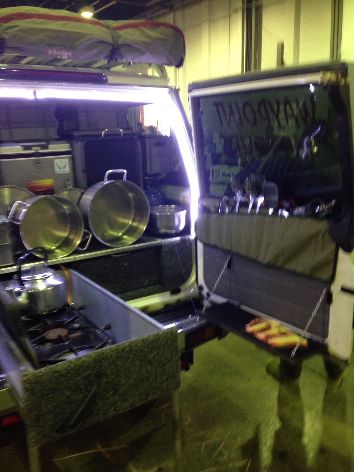

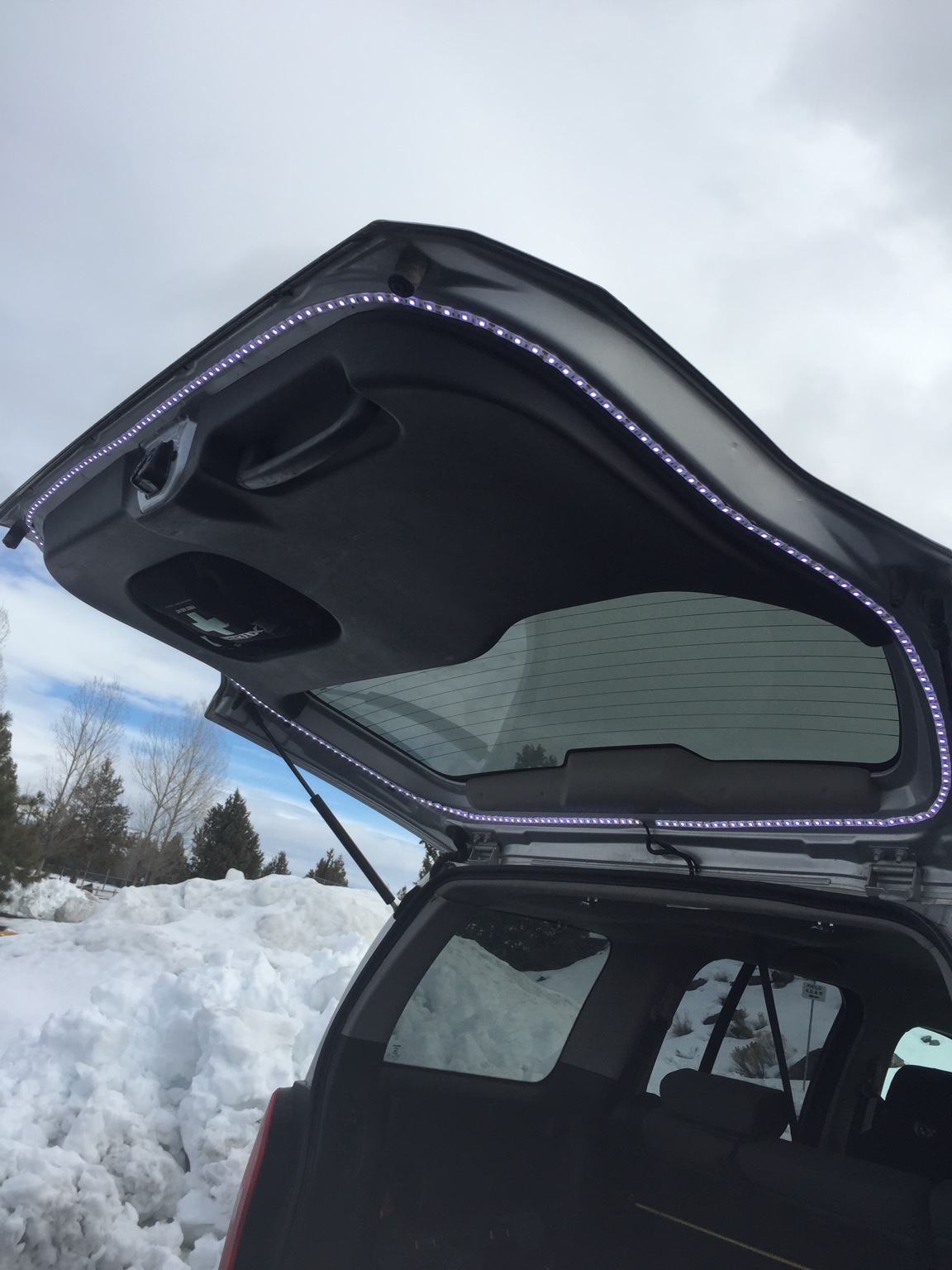

I've used the LED lighting strips that come on a roll and you cut to your own length too. This one has been there a couple of years and gives out surprising amount of light.
Also saw this setup using the same idea.
