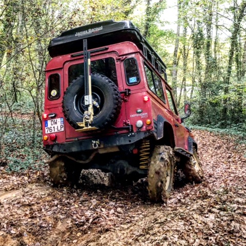

Been in this cracking rig and a realy nice french lad who built itNot my rig, though it is pretty cool...

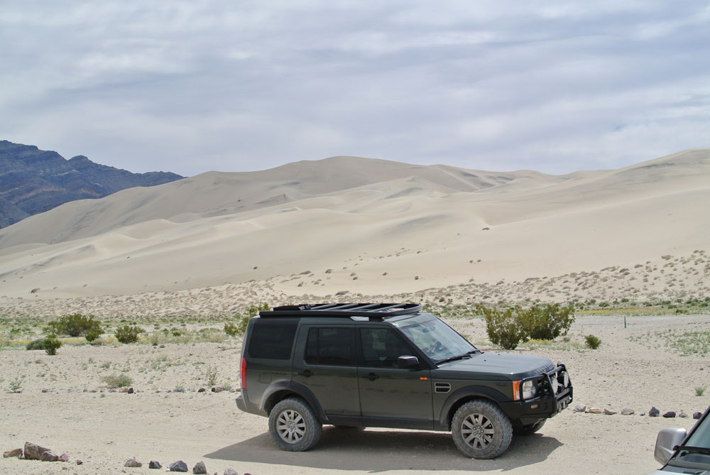

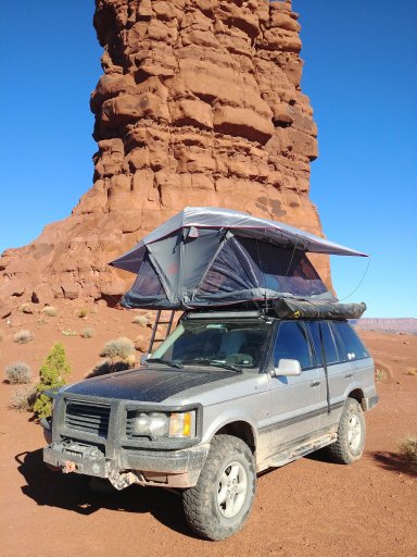

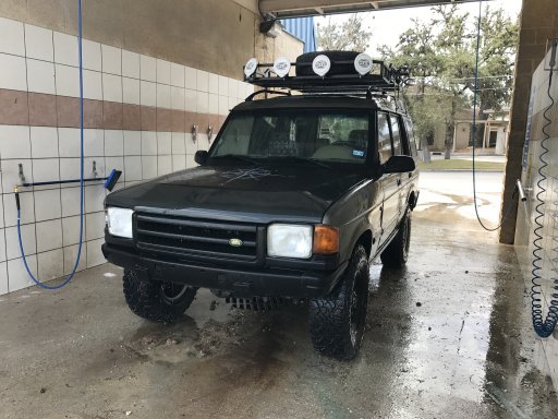

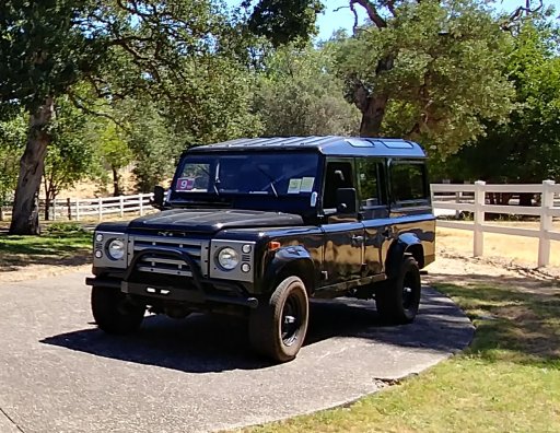

nice to see another P38!I also am a rover nutcase. Have a 2001 p38 Range Rover for the last 9 years, an 06 LR3 and imported a Santana/Defender from Barcelona earlier this year. A few pics. View attachment 39179 View attachment 39180
