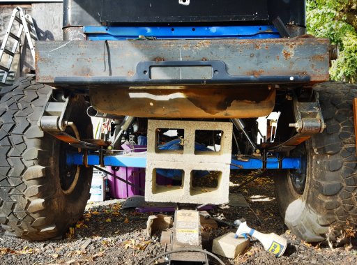

Got the tank moved to the back and mocked up to its mounting point . Need to make some mounts, figure out a skid plate , figure out the fuel filler, extend the fuel lines and the pump wiring.

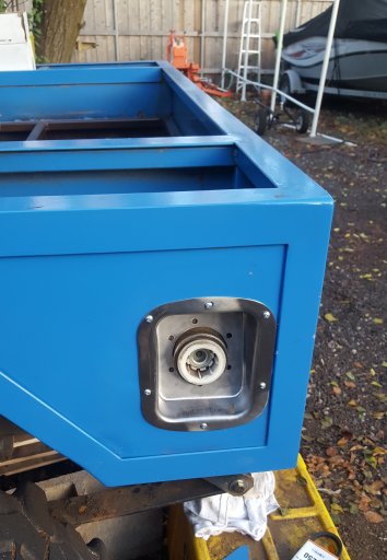

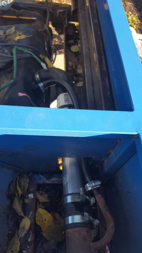

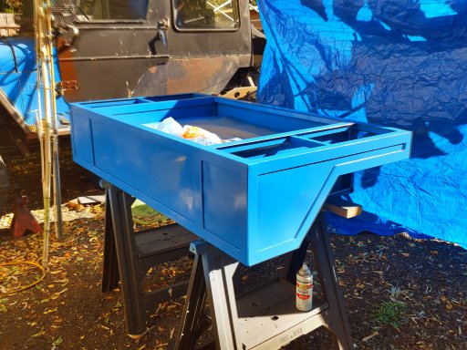

Got the bed back on and the fuel lines mostly figured out need to get a connector for the filler hose, I have to modify the fuel in Labs but I was able to keep the Toyota factory setup.20181116_163953.jpg hdr_00882_0.jpg 20181116_164100.jpg

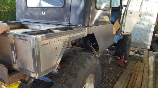

Well I had a fairly productive 4 hours today.
I got the fuel filler all hooked up
got a tail light installed but somehow managed to lose the other one somewhere so got to go order one of those
Pulled out the factory under the seat tool box, drilling out Factory spot welds a dicey process go a little too far to pop right through the other side.
And finally got around to installing the twin sticks now I have all the shifters for maximum amount of fun

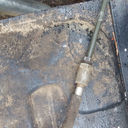

got the fuel lines extended to the tank , took a little reworking due to not being able to find a 8mm line with 14x1.5 inverted flare fittings .Thankfully its close enough to 5/16 so it was just a matter of cutting off the metric fitting ,reflaring the line with the standard fitting in its place and doing the reverse on the other end of the extension piece of hardline .20181211_131508.jpg 20181211_134420.jpg
