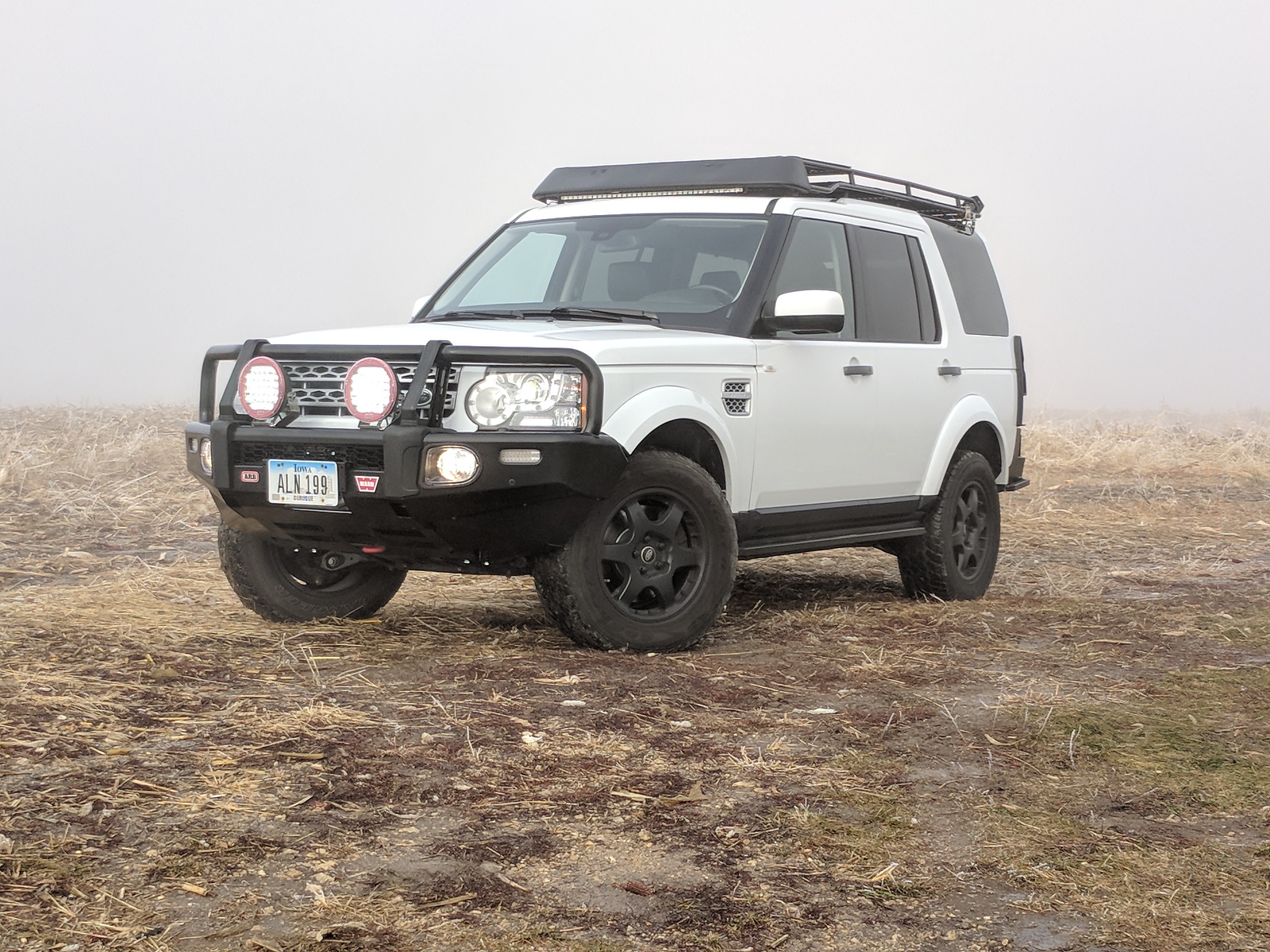

I love this I’m in the market for rig I used to have a disco 1 so I’m biased towards Land Rover but I’m torn between a 4Runner and an lr3 or lr4 hows your reliability? Any crazy issues like with the disco? But if I go with the lr3 or lr4 I’m gonna totally steal this build I love itSweeeet! Another 2013 LR4. Seeing your pictures reminds me of mine about 4 years ago. Awesome to see another one get setup for touring!

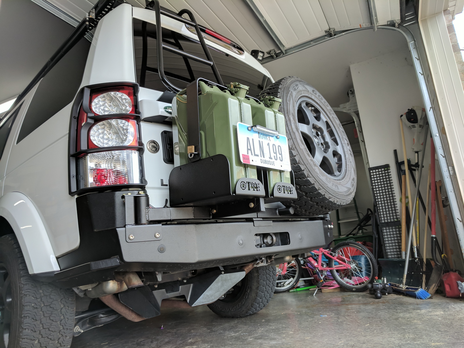

For the rear tire carrier, I highly recommend Tactical Rovers/Tactical 4x4. They make great stuff. If you don't want a full steel rear bar (which goes over the factory steel bumper), check out Voyager Offroad (they made my rack and ladder). They have a tire swing that uses factory bumper.
The T44 option can be tire, tire+jerry, tire+dual jerry, etc. He can make it however you want.
I usually run with my swing arms off, unless I am on a trip.
Here is with the swing arms on. The bumper is amazing and tough! You can see where I stuck my OB badge.
