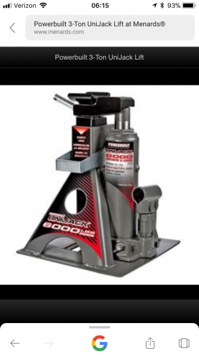

I carry two of these 3in1 jacks by powerbuilt. Bottle jacks and jack stands are a must to accompany high lift jacks. We learned that the hard way on one trip. But I don’t have the room to carry two bottle jacks and two jack stands along with a high lift. So this does the trick and works great! Plus it has a really wide base.

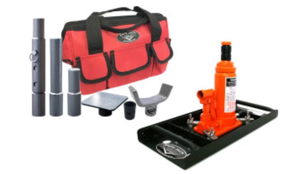

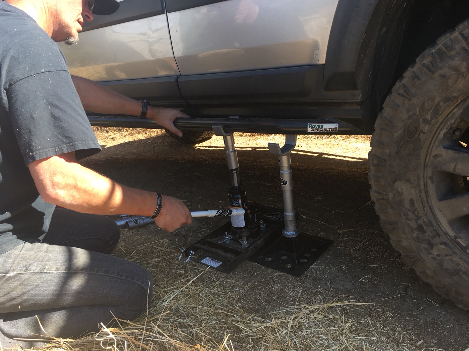

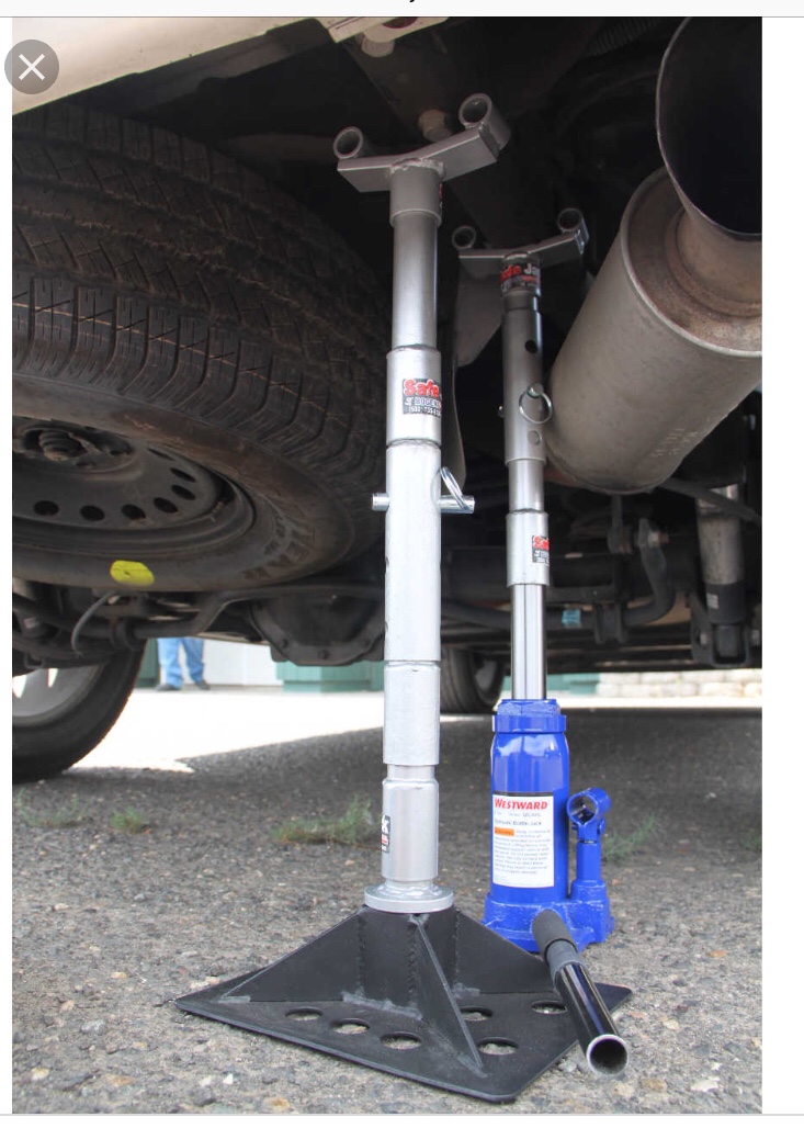

I have used the X jack in sand, worked perfectly. I have a hi lift and use it when needed on my Defender but have also watched my truck fall off of it when the jack slid. Fortunately I was not under it and the rotor just stuck in the soft dirt. I carry the Safe Jack system for the Defender and the LR4. I got the one with the jack stand and bottle jack. Allows to mount at many different places on the trucks and for the LR4 with the air suspension I can go through part of the travel, use the jack stand to hold it, then change the height on the bottle jack and continue to jack the truck. It feels much more stable.

I have this jack from Menards. Used it a handful of times in the garage but like it because it has a fairly good size base and it locks like a jack stand so I feel it would do pretty well out on the trail.

Great thread with lots of info. I'm definitely eyeing the Powerbuilt Unijack.

Thanks El Solis for introducing me to those Safe Jack stands and extensions! I love that idea and especially love that the extensions for the jack and the stand are interchangeable. Definitely on my wish list now!
