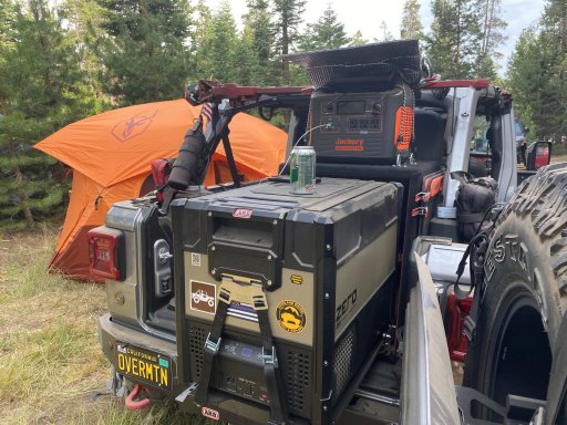

One heck of a torture test for my Jeep and my Jackerys. (1000W and 1500W) I just completed the Jeep Jamboree on the Rubicon Trail. It was a three day trip through the Rubicon. This was no joke. First day was a seven hour grueling pounding in ninety degree heat in major dust. There were many stops on the trail for rigs that had trouble making it over obstacle and the occasional broken rig. Once we arrived at Rubicon Springs, we set up camp. I have two Jackey's, 1000W and 1500W. The 1500W ran my ARB fridge. Over the three days, it ran my ARB fridge, charged two handheld radios, four phones, a GoPro camera, a Garmin InReach device and a tent light/fan and had plenty of juice left over. and the 1000W ran my CPAP machine. The second day was a filled with drinking, eating and frolicking in the river at Rubicon Springs. The Third day was another grueling pounding out. The Jackery 1500W ran my fridge without a hiccup. The 1000W ran my CPAP perfectly using only 5%. I set up one 100W Jackery solar panel for the 1500W unit, but because of possible thunderstorms in the area, I put it away after a couple of hours. I didn't want to take chances with a solar panel that was not water proof (I don't have Jackery's new waterproof 200W panel). I was very happy with the durability of the Jackerys. Next time I will only use one Jackery, plenty of power. I could have run the fridge and CPAP with just the 1000W or 1500W Jackery, with just an extension cord to the tent to run the CPAP. I did not need two. I had a great time, I suggest if you want to have a great adventure challenge, check out the Rubicon Trail in Norther California.
