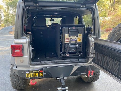

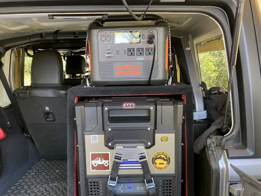

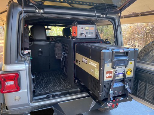

Hi All, I Just wanted to give an update on my Jackery. I’ve had my Jackery for some time now. It has been great! I run my ARB 47qt fridge for several days, I run a CPAP machine when the power is turned off here in Northern California : ( I haven’t used it in my tent yet, but I have no doubt it will work exceptionally well. And now, wait for it…….I use my Jackery to run a portable ice maker for those trips when you want/need a stiff (lemonade)….drink… BTW, if you haven’t checked it out yet, I got an email from Jackery where I’m signed up to get special notifications etc… If you go to the Jackery website and click on the large banner that says, “Jackery Day Contest,” it has a “Fishing Game” where you can win a Jackery 1500! Dang! 1500 watts. I don’t see where you can buy one yet, but it looks like they might be coming out with some new stuff. Here’s the link Jackery Day
View attachment 189783View attachment 189787
That beast of a fridge is taking up half your cargo space, cool!

I made it 88 hours on one charge running my ARB Zero 47 at 35 degrees. I stopped my test at 7% charge. I hooked up two Jackery 100w solar panels and within four hours, the charge was at 46% (with fridge running). I live in the foothills with many trees. It seemed that every time I looked at the solar panels they were in the shade and I had to adjust them, "PIA." With two panels, I was pulling around 140w in direct sun with smoke haze. One panel was exactly half. So far, I love this system. I ended up plugging the fridge into the Jackery, and switched my rear 12v plug to only power when the Jeep is running. Now the Jackery charges while I drive, yet runs the fridge 100% while Jeep is off. The only negative I see is: The fridge 12v plug wiggled out of the Jackery two times within two hours of driving. Luckily the ARB alerts you when it loses power. I need to figure out a way to keep the plug in while driving. Overall, I think this is a great alternative to a dual battery system. Thank goodness for the Jackery. Last night PG&G turned our power off again. My kids are doing Zoom distance learning because the schools are closed here. They didn't miss a beat because they were able to plug in their computers right into the Jackery. Here is the link to the "Overland Vehicle Build" forum: Jackery Power Station question.

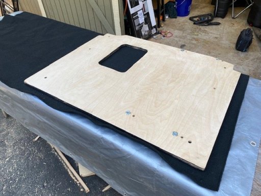

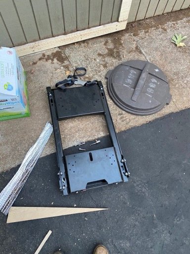

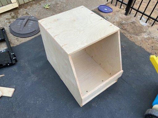

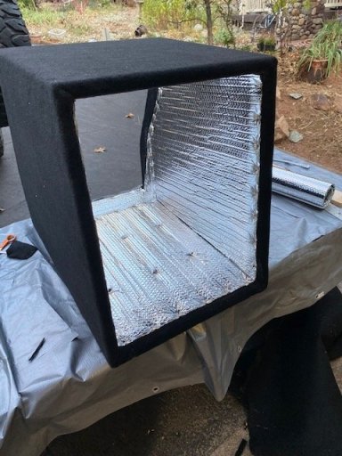

It does take up a lot of room, however I actually have more accessible room with the slide out and surround with the Jackery 1000 on top, over having to remove gear just to get to a bigger cooler with ice . All of it is modular and can be easily removed.
Yeah love the modular setups for sure. I'd do something similar if I had the skills with DIY.
