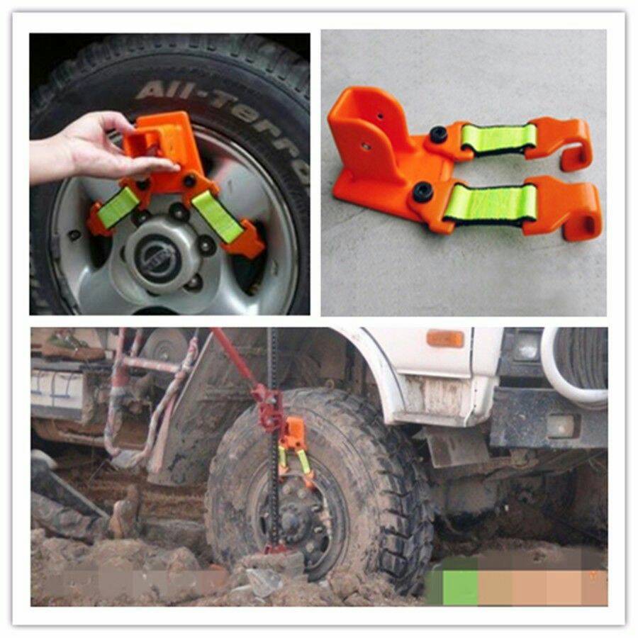

The farm jack is one of my favorite tools but it comes with an "*" and a foot note. The machine is a spreader, not a lifter. It creates space between the lip and foot. Sometimes that spreading can be used to spread a wheel from the mud or sand. Subtle but important.
The item below is one of my favorite additions that can increase the stability of the jack in most situations. Angles are important so if you weren't good at math or physics, leave the farm jack at home...better yet, leave the money in your account.
If you want more information on farm jacks, I could write a book about them.
What is the tire lift accessory called and where can I find one?
I have a 60" Extreme on the tail of my Land Cruiser. I have the Hi-Lift Bumper Lift, but like this better than the Hi-Lift option
Lift Mate
Longshot270
Experimenter I
1,453
DFW, TX
Colby
M
5160
Lift Mate is the Hi-Lift version.... I'm actually interested in the one pictured above.
This is the title of the one I got off amazon. Looks like they are currently out though.
CESS[emoji768] Farm Lift Jack Lift Mate 6600 Lbs Heavy Duty M1058 Compatible With Hi-Lift Jack

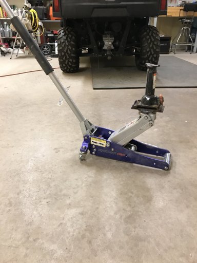

I am currently using a 3 ton aluminum jack with a 1 foot aluminum 3" dia tube and metal stabilization plates.
I am looking at this as a good everyday carry in the truck. It also has a built in jackstand as well. The main reason i am looking at this one is the footprint is bigger than a standard bottlejack and it also has a bigger pad which should make it easier to get under the axle. Powerbuilt makes one as well but the quality is hit or miss. The husky seems to have better reviews

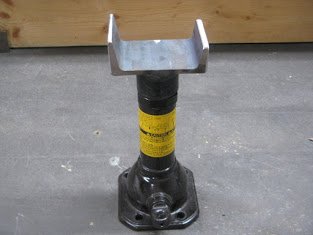

For me its all about reliability and versatility and a factory mechanical Toyota Land Cruiser works. It can lift an axle high enough to easily change a 37" tire and it will work in any position every time. Coupled with a Jack Adapter and you have a high level of safety for a repair or tire change in the field or your driveway.
I have the 4Runner version of that jack and what looks like the same jack adapter, they work great. I don't carry a high lift anymore.
