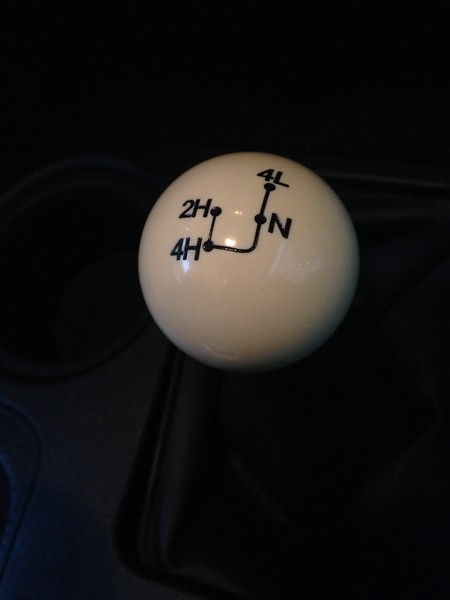

could'nt imagine going without 4lo.
my truck is a manual and for technical or knarly stuff, i only need to use the throttle- no clutch, no brakes.
also a boon when when backing up the trailer off road- steady, under control and again, only need the throttle
quite often i will cruise the bush in 4lo, 3rd gear. nice to always have that torque multiplication on tap ready to go.
my puppies also love 4lo, just the right speed in third for them to dick around and still keep up and not get left behind
