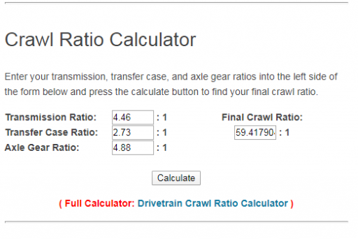

mine is roughly a 600:1 crawl ratio when calculated (4.46 1st gear, 2.73 tc, 4.88 gears in axles ) but this is why I am thinking a 15:1 may be specific parts.
redo the math... 4.46 (2.73) 4.88 = 35.08..... edit 59.41..... :grimacing:
my TJ Rubi........ 4.46 (4.00) 4.10 = 73.14

Same as most of us in high range. My Rubi is only 4.46 (4.10) = 18.28 in 2/4HI.
Most guys who regeared and run 4.88 or deeper also bought bigger tires effectively retaining the stock crawl ratio.
