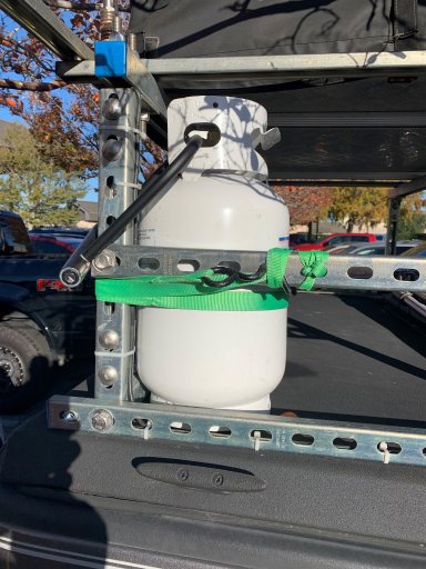

This is what my wife and I came up with, I think the quick fist clamps and the craftsman ladder mount and a locking tie down costed around 60 bucks. I'll post up some pics with it mounted

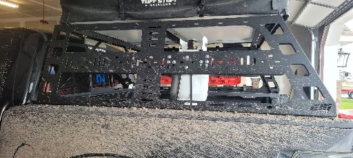

Damn awesome! Looks great! These mounting brackets are so much better then shelling out $100+, so glad I found this thread. I also have the 11 gallon footwell water tank myself, can't wait to use it this season. Got a tankless water heater shower set up I'm itching to use on longer trips as well. Here's what I came up with for mounting on my rack for now. Stupid short garage door means I'll have to leave it off till I gear up for a trip but oh well, it's easy enough to get on/off with a couple bolts.
If you re drilled the holes 2"-3" lower you could move the strap down toward the middle of the tank and most likely be able to use both holes.
Thought about doing something like that but on the other side where the strap connects its on a welded tab so I'd have to cut the tab off and weld on a new one a couple inches lower. Eventually that may be something I tackle to make perfect but it's worked for me the entire summer with no issues the way it is rigged up now. I did use a bottle jack to bow out the sides a bit so that the tank doesn't rub on either side and create some potential issues. I also covered the rear with tool drawer liner to cut down on metal on metal rubbing. Still a far better solution than spending double-triple the price on a dedicated mount from some of these "overland" accessory companies. 2021-10-12.jpg

Thought about doing something like that but on the other side where the strap connects its on a welded tab so I'd have to cut the tab off and weld on a new one a couple inches lower. Eventually that may be something I tackle to make perfect but it's worked for me the entire summer with no issues the way it is rigged up now. I did use a bottle jack to bow out the sides a bit so that the tank doesn't rub on either side and create some potential issues. I also covered the rear with tool drawer liner to cut down on metal on metal rubbing. Still a far better solution than spending double-triple the price on a dedicated mount from some of these "overland" accessory companies. View attachment 212551
I forgot about the tab on the other side. It would just take a bit more work. But if its doing the job why mess with it.
How about drilling a hole lower and bolting a piece of angle iron to it, with a hole for the strap mount?
