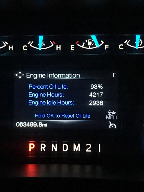

Honestly, as long as you keep up your maintenance and oil changes, you’re good.
I’m a field engineer and basically live/work out of my truck for 3 weeks out of the month. I’m on site for 14-18 hrs a day when I’m working, and my truck needs to be on (I mostly work in South Texas).
I’m on my third work truck of my career, and my engines have always been in pristine shape since I maintain them religiously, all my car related issues have been due to other factors. You’re not going to run into any issues for idling your truck with the AC on for 8 hrs every few weeks.
In fact, I’m writing this from inside my truck, which has been on for the last 8 hrs idling.

In my line of work. I let my Toyota Tundra idle for 12 hours a day, 5 days a week. All winter and all summer with the AC on. I have yet to have a problem on either one of my Tundras. It’s my office and I will be comfortable. To me, it’s easy to let the vehicle run all night if I had or needed to.
