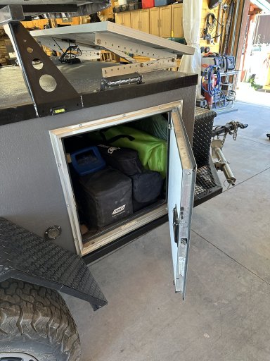

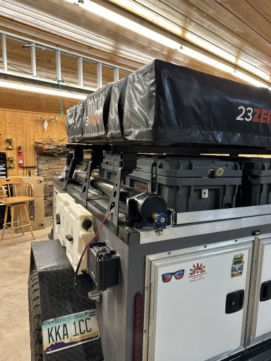

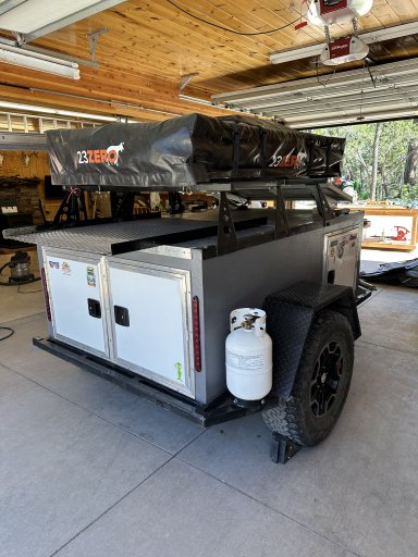

Hi I have built several trailers over the years. This is my current trailer and gear. It has been everywhere.

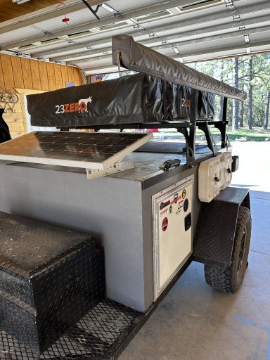

Solar is 100w panel and I have it routes to the tent for lights and running my cpap.

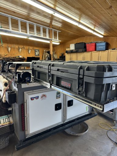

I’m currently building that new slide for under the tent. It will hold two roam boxes and my fishing rod tube

i went ahead and bought some 500lb slides and pulled the tent. I installed my new water set up and the slide. The purpose was to use these two dust proof roam boxes and be able to access them easily. It turned out.
