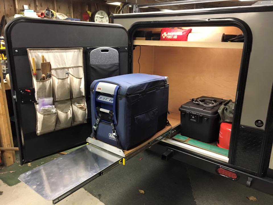

Being honest, the only fridge / freezer I have direct experience with is ARB, owning 2. They are sealed and there's a plug in the bottom for easy cleaning when necessary. I don't know if Engel's have the same plug or not, but I would guess something similar exists. A good fridge should be complete sealed so that leaking problem shouldn't exist. It is the first I've heard of it - ever. Worst case scenario, put a piece of duct tape over the drain hole.
That said, if you can spare the galley space, I'd put it there. Down the road, if I redesign our galley, I think I would create a dual slide (think rails) and I'd make it so it would slide out of the back of the galley, and also side inward toward the cabin so you can grab stuff out of it in the middle of the night if you want. You'd have to cut the galley wall of course, but if I were designing it with Hiker, I might want to go that route. We are using that space for power and water so it's not an option.
The front is also a fine place, but I would have to make a secure box for it. Here are some photos from other owners showing some options. Once you put a deposit down, you are open to join the Facebook owners page where there's a wealth of photos and builds to inspire you.
This one looks to be an offroad that sacrificed cabin space for extra galley space.
This is one of my favorite front installs. Custom box with slider. Completely secure.
Reactions: caver6

You might be able to get away with a galley side slideout in. Tembo Tusk makes them. Option 2, and probably the cheapest is tongue box. Just get a top opener large enough to give you access to controls. But my own personal preference if you're only running one fridge/freezer has always been in the tow vehicle. Even when I'm not camping or exploring, it's just nice to have to do simple things like keep groceries frozen and not have to worry about running home right away. Or maybe you're going to a sporting event and you pop open the tailgate and have instant refreshments. Or you make camp, detach the trailer and drive trails all day, you don't need to worry about bringing a cooler. I've also used it for storage of pretty odd things. Once I bought a floral arrangement and didn't have anyone to hold it and keep it from spilling. So popped open the fridge, vase and all down in there (the ARB has a removable lid) and what little water did spill was all contained by the fridge. I don't know your setup, but with a 4Runner, I'd put a retractable, tilting slider by AluCab in there and be done. It's pricey but it's sturdy and awesome. (Why is overlanding SO expensive?!?!)
